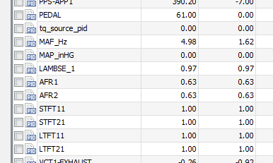

There's only one way to install the MAF into the tube due to the orientation of the screw holes, and yes it is facing the correct way. That was the first thing I double-checked.
To be completely transparent, I'm not well versed on what's what data-wise. But here's the screenshot my tuner sent me. The STFT's are in there as well. This is all a learning process for me.

Take a short log at idle, once the engine is warm. no throttle input. .63 AFR does indicate a rich condition, but the fact that your log shows LTFT and STFT are a perfect 1.0 Lambda is unlikely. Do you have any codes stored? Even if the check engine light isn't on, there could be history codes saved. If the PCM isn't receiving a good signal from the primary O2 sensors, it will add fuel in an effort to protect the engine from running lean. There are very few things mechanically that can cause a rich condition, but generally it is caused by bad O2 sensors or a bad/dirty MAF. Does the engine misfire?
Also, I see you have long tube headers. Be certain that the O2 sensors are plugged in completely and that whatever wiring extender you are using hasn't failed.

Thanks for all the amazing insight. This weekend I'm going to check out the O2 sensors/harness and potentially replace them as well. I'll check for the stored codes as well and get back to you on that. And no the car isn't misfiring.
