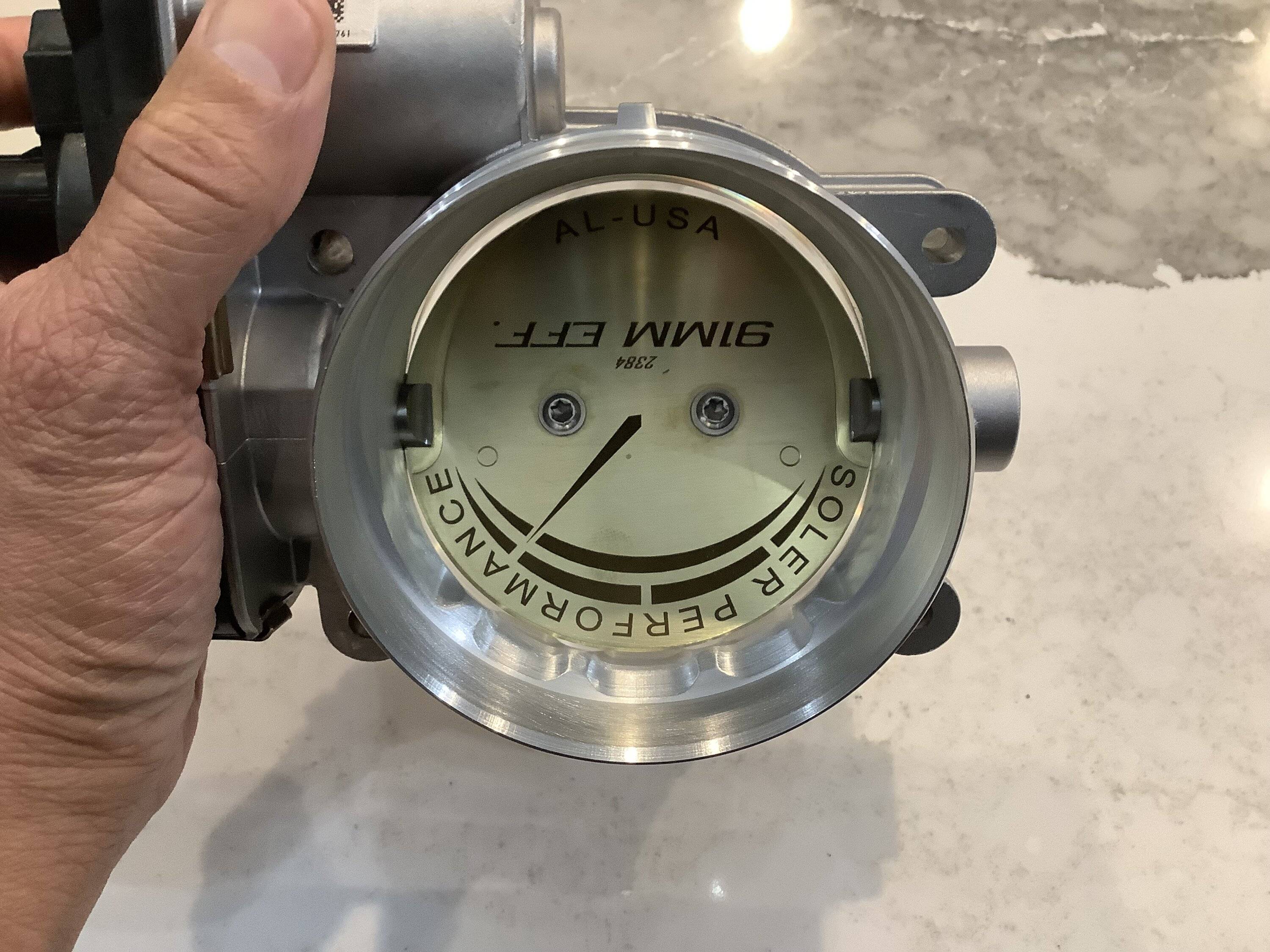

Clean tb as in like this. I’ve had to do it a few times before I installed a JPC breather kit because oil must would get sucked back into the tb and intake.

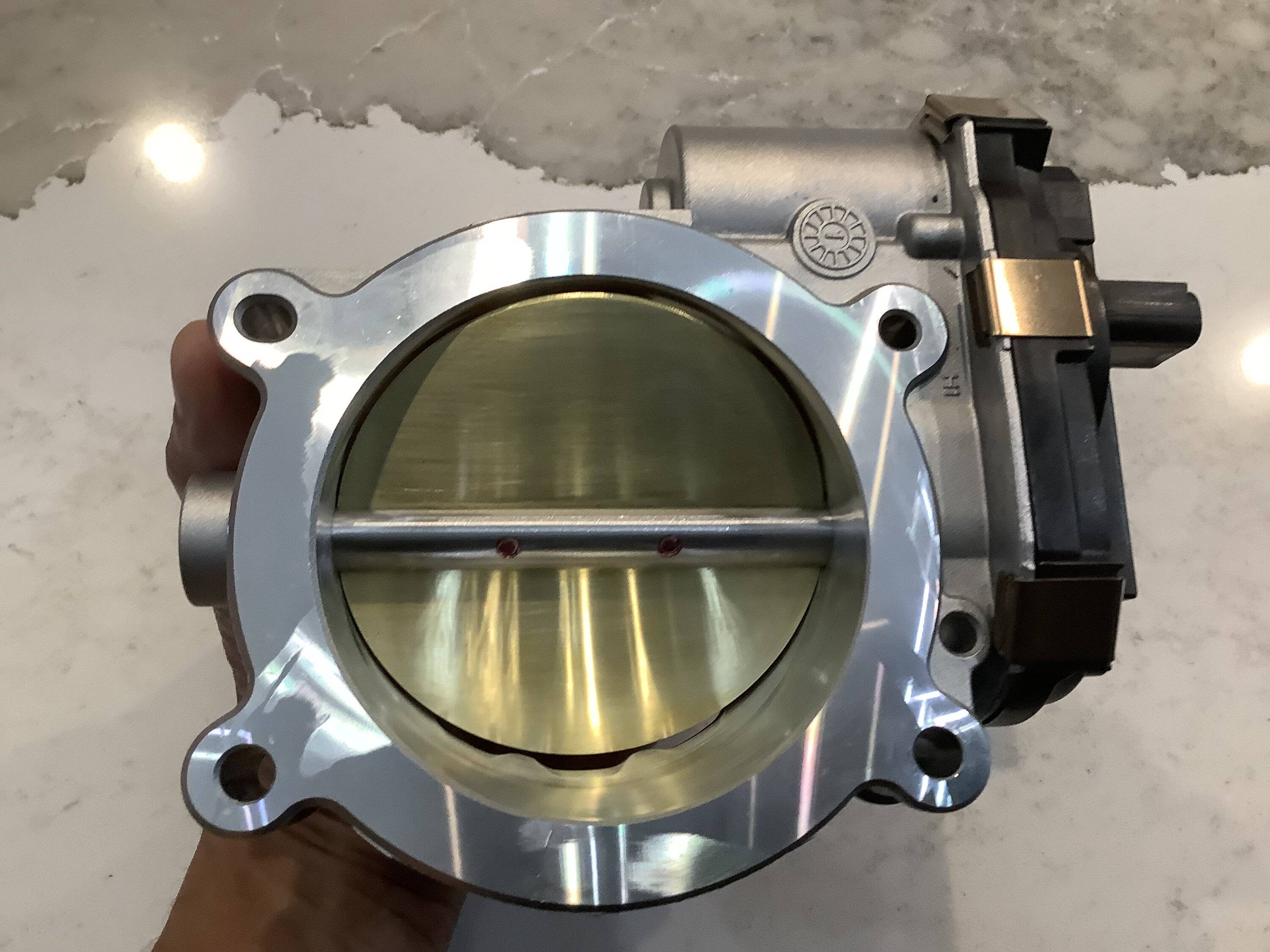

Look closely at the areas where the red arrows are pointing in this pic (on both sides of the blade). If they’re dirty and gunked up, it can cause trouble.
Yep that’s where you need to check.
If the butterfly valve is binding it will upset the ecu.
Try the IMRC they will cause bogging down if stuck closed
