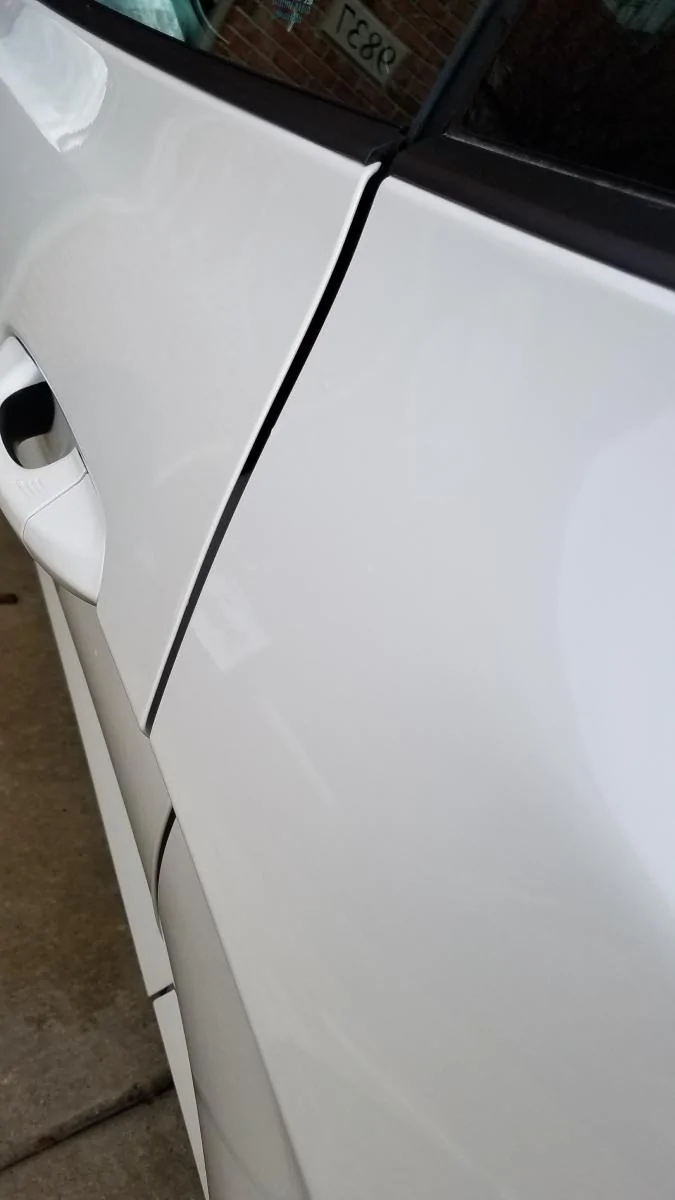

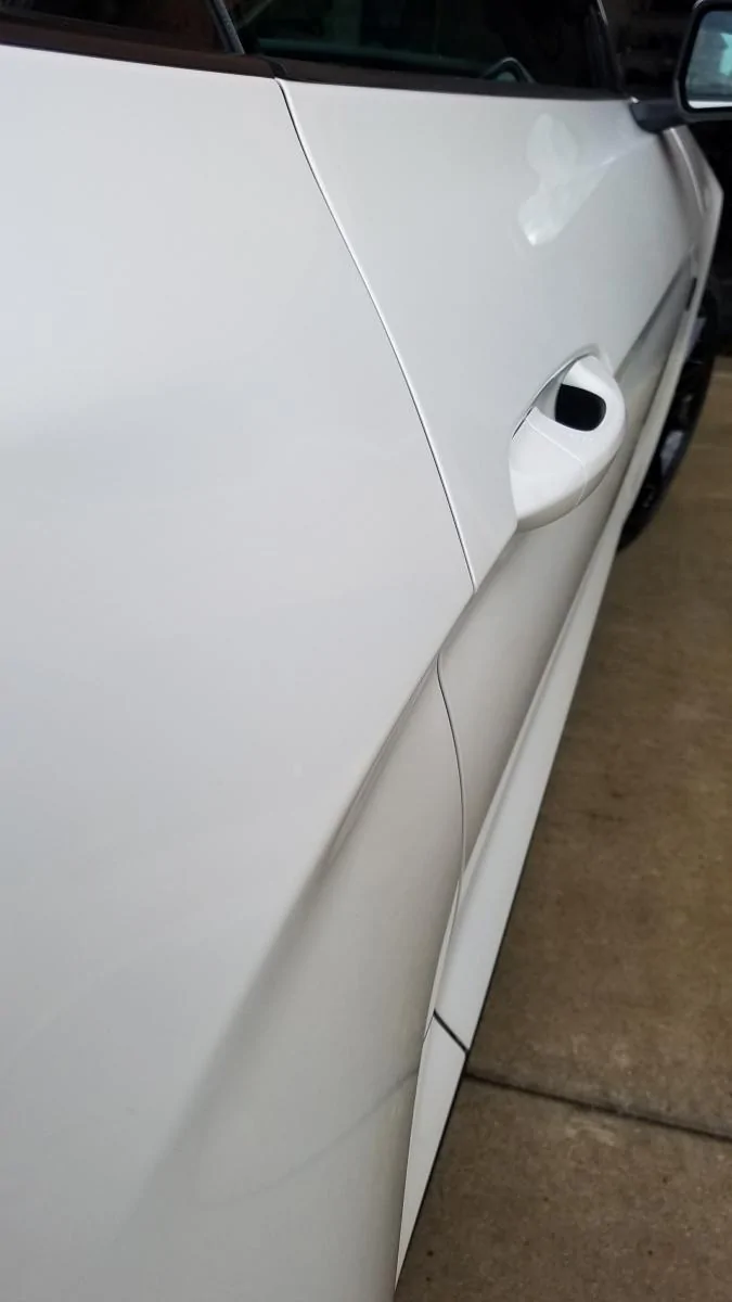

Anyone else have this problem? Just picked up the car last week. Drivers side door doesnt close flush. Passenger side looks fine.

That's easily adjustable. Is the door further out at the top near the belt line then the bottom near the rocker or equal all the way down?

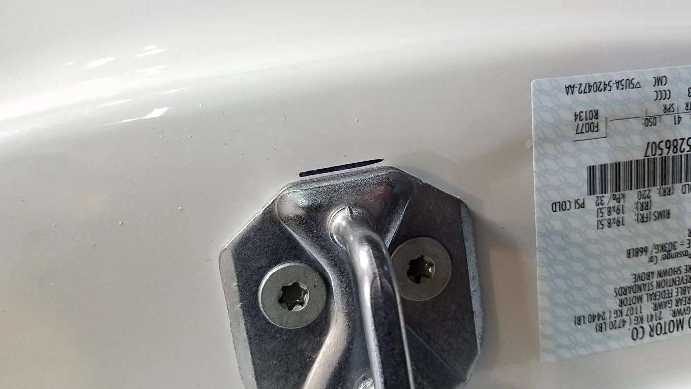

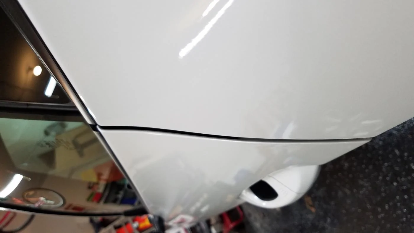

So I tried adjusting the striker. There is no more than 2mm of play after I loosened it. See pics. (there's a black line where I drew where it rested originally). Door is still another 2-3mm away from flush.

Are you certain that's pushed all the way inward? You can also try angling the striker to offset it to pull it more inward. If this doesn't work let me know. Have you removed the striker completely? I've seen on many cars that the floating nuts sometimes get jammed. Please provide a pic with the striker removed.
Also you might wanna be careful using a sharpie. It can stain the paint and sometimes not be removed completely. A better choice would be masking tape or pencil

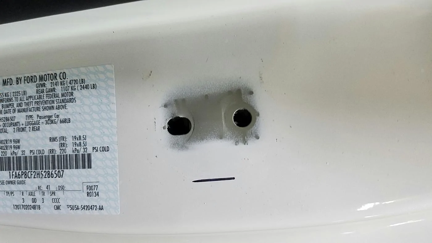

Here it is. Doesn't look like striker adjustment will do the trick. I may have to take it in to the dealers body shop for adjustment?
(Not sure why the photos keep rotating on me)

Did the nuts drop into the jamb?

No nuts needed. Screws tighten down on their own. Front of door feels nicely flush with front quarter panel

Correct but the bolts screw into a nut plate. With the striker off, close the door and push it in. How far will it close past the 1/4 panels edge?
