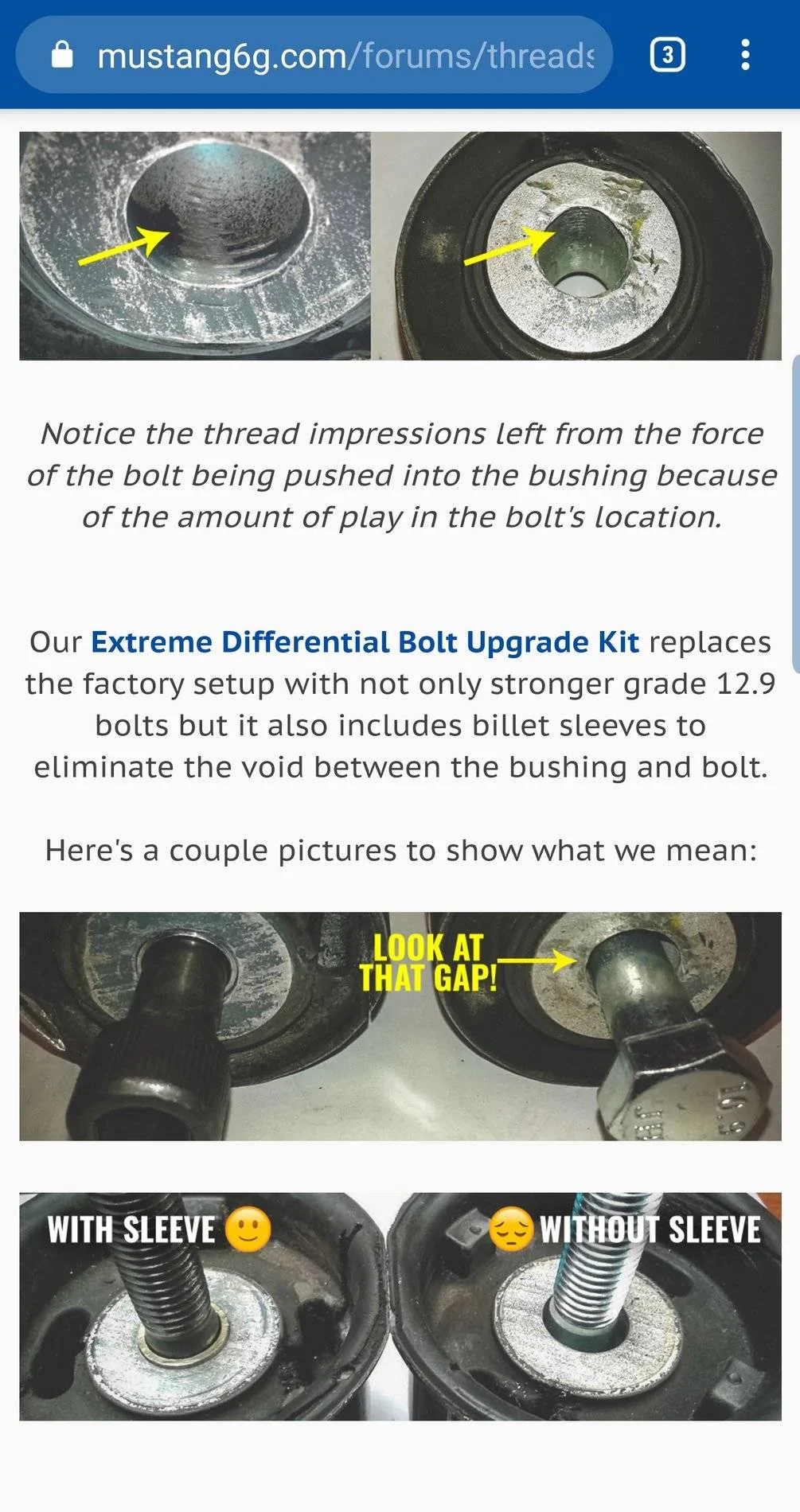

I did just the sleeves in the rear bushings, no other hardware changes. It works well and not only removes slop & noise, but prevents the bolts from failing there. This is something that people should do immediately with their S550 to help prevent the bushings from getting ripped/torn prematurely.

No need to touch the bolts. Just do the sleeves. This is why...
