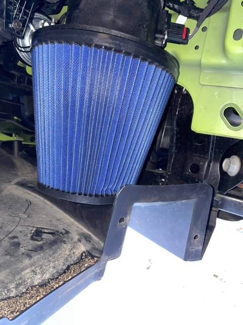

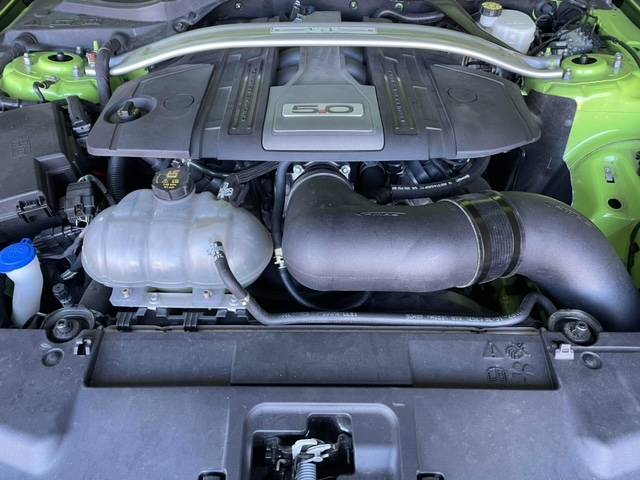

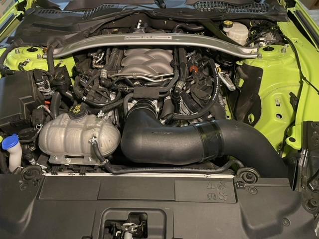

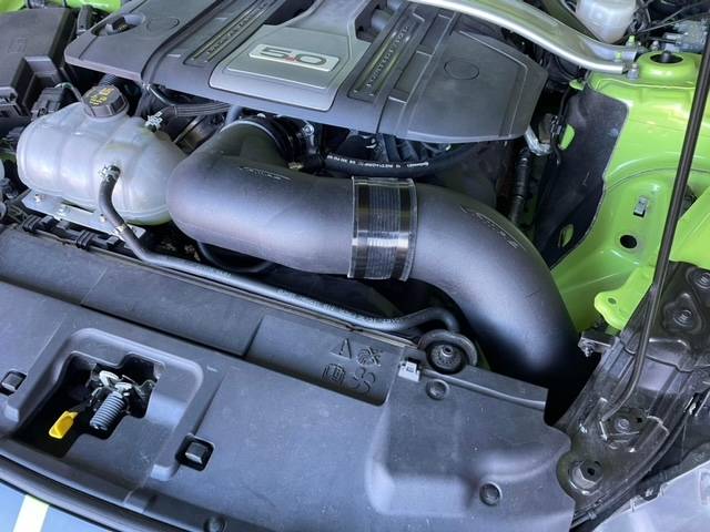

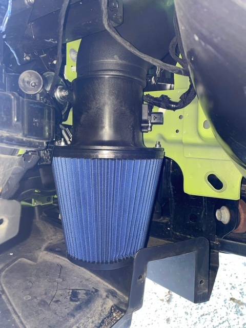

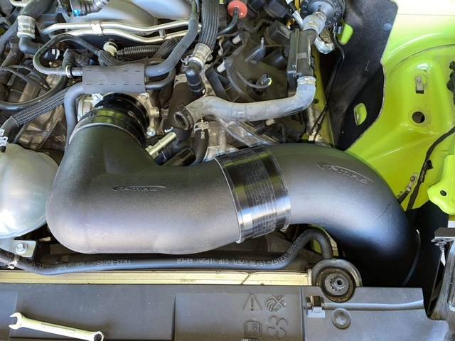

Here's a few pics as promised. Let us know if you have any other questions.
Thanks!

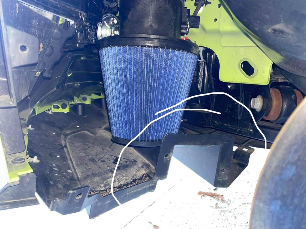

That is actually a lot further off the under tray than I saw before.

The ones I saw before had the filter right against the flat of the under tray.
On the PP cars there is a duct in the tray that will hit the bottom of the filter. If it's a PP, you can trim the PMAS plastic shield and you don't use the lower maf bracket they include (it's not really needed anyway). This lets the maf housing and filter move up about 1.5" to clear the bump in the tray.
Hope that helps.

Here's what it looks like once you do what I mentioned above if you have a PP car.
