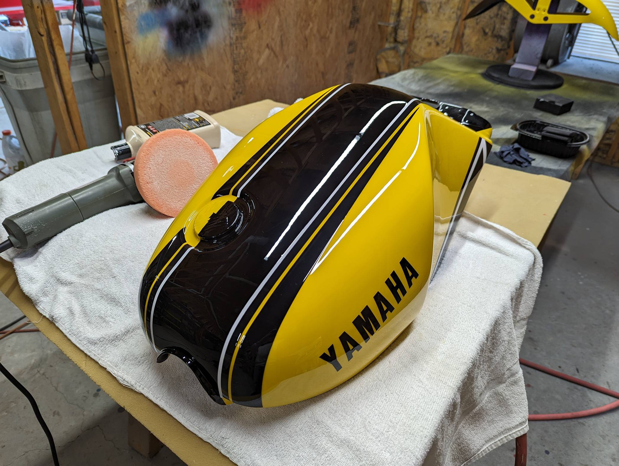

Once you get it swirl free, try Honda Pro Polish. It's a spray on product that I use on all the bikes after polishing. I also use it on my truck since I do run it through car washes. It's super easy to use and doesn't turn the black plastic parts white.

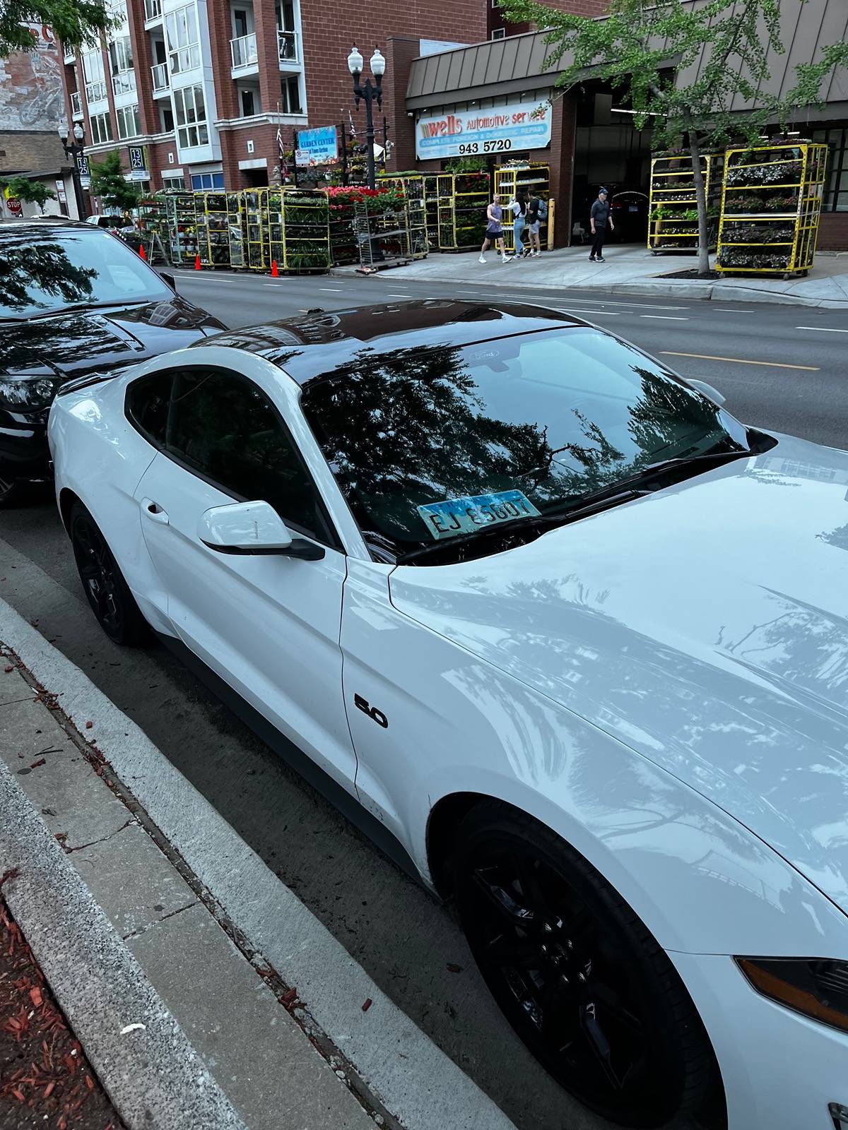

We just did a friends 2015 Black challenger and it turned out great considering the car was never protected before. I used perfect finish and finished it with Armour Quartz which was recommend here and its looks better then new by far.
He had a lot of water spots so we did use a water spot remover before polishing
