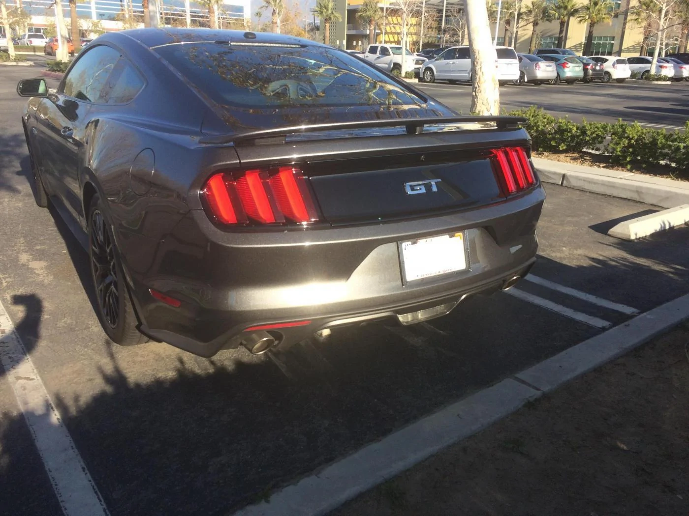

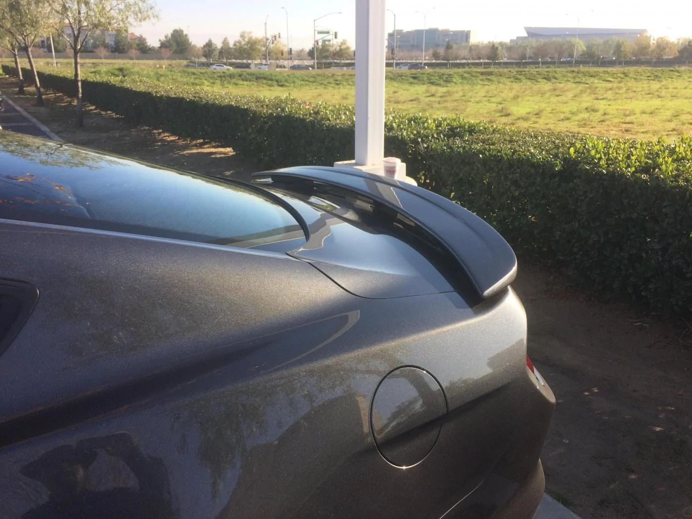

Not quite sure I understand this. The PP replaces the "Track" package yet removes the spoiler. Wouldn't the spoiler be beneficial in a track application?
Mine has one... Now.
PS It is for looks - not performance.
