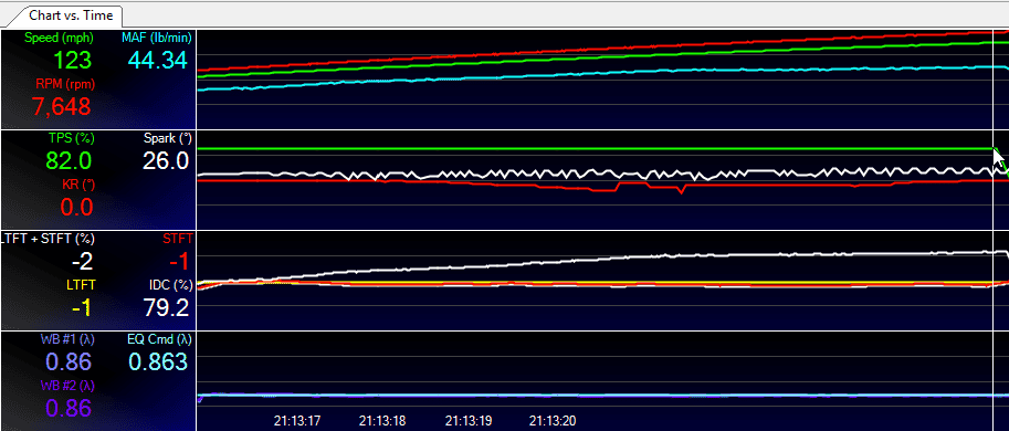

Compare your commanded lambda vs actual against this commanded lambda vs actual.
Remember that the error between commanded lambda and actual lambda makes no contribution towards Injector pulsewidth(IPW). Also I believe he mention that the commanded PID for him wasn't registering correctly.
Below I am attaching a screenshot on of my 50% ethanol runs. This run saw IDC's of 79.2% and IPW's of 12.5ms. My fuel trims are always within +/-2% during the pull as well. Ignore the low spark advance, I was hunting down some false knock that ended up being bad gas.
My pump is on a e70 blend right now so I cannot post true e85 results, but you can clearly see that even at 50% ethanol I am at ~80% IDC. Now increase my fuel demand by another 15%(since I am already on e50) and I would be around 92% IDC. My number is a bit safer than Term's 97%, which just goes to prove his point. do you really want to take a gamble on which end of the tolerance your car is on?
Shaun posted there is a 6% injector tolerance at the factory so you could end up like me, in the low 90% IDC range on a semi warm day, or you could end up like term, in the high 90's IDC range on a semi warm day. Also as temperature drops, IDC increases, because of this I will prob never run e85 through my car, a 92% IDC when it's 80* outside will only grow as temps drop into the low 30's and 40's.
Shaun posted there is a 6% injector tolerance at the factory. You could end up like me, in the low 90's on a semi warm day, or you could end up like term, in the high 90's on a semi warm day as well. As temperature drops, IDC increases, because of this I will prob never run e85 through my car, I try and cap myself around e60 just to avoid potential failure.
See this is a much much better example of proper maf values. At almost 7700rpms you are just over 44lb/min. Term was claiming 47lb/min at a much lower RPM. commanded lambda and actual lambda represent the error in the maf values. If the car thinks it's moving more air than it really is it will run rich. You will Max out your injector unnessicarily. Your seeing exactly what I predicted earlier if term corrected his tune.
Also take into account with higher %E you will have more fuel being sprayed in the intake. This means it's very unlikely you MAF will increase. It's going to remain where it is or even be less. This PDF is a study on how to use MAF values to better estimate E content. Page 65 is the effect on the filing model equation.

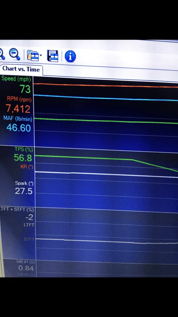

My MAF is actually almost dead on. My airflow is usually in the 45lb/min range in 80-90* temps it hits 47lbs/min on cool dry mornings You are not listening though my commanded lambda is not 0.89 like that genaric PID reads it's 0.85 right there and the richest it hits is 0.82 actual as read by both of my widebands until the STFT pulls out -3% To correct. My stoich was too rich by 4% hence my LTFTs being -3 on one bank and -4 on the other. -3+-4=-7 which is my total fuel trim right there. Now that I fixed my stoich my IDC came down 1% with my new injectors. Even taking that into account I was still extremely close to maxing my injectors out in 80* temps. Add in one cold 40* morning where airmass is greater by 7-8% and it would be at 100%.
Old 93 octane log with same exact MAF period values just correct stoich. 0.85 commaded 0.84 actual total fuel trims -2 here LTFT zero STFT -2. Needed to be -3. My MAF is not off!!! My trims are better than they were stock. MAF almost 47 here. Actual is just under 46 once corrected. I haven't bothered taking 2-3% out of 125uS area of my period vs MAF table because I'd rather it be 2-3% rich in case I get E-90 instead of E-85.
