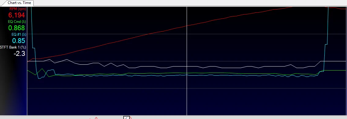

Get the injectors to be safe or trust that your tuner knows what they are doing. There have been no reports of the stock injector FF tunes causing problems from the tuners that offer it. Earlier the logs posted from a lund tune showed +/-1% fuel trims. This is an example of how well it needs to be dialed in. It was stated that your car is tuned to have fuel trims just as good. My claim is they are no where near as good. Ill agree that using the stock injectors with E85 you are right at the edge of safe and unsafe. This is where having your tune really dialed in comes into play, there's not much room for error in your MAF.
Compare your commanded lambda vs actual against this commanded lambda vs actual. This is taken from my 2015. Saying you have yours dialed in and tuned right is just false. you cant blame this on the pid being wrong either. If thats true how did you tune it? Wishful thinking? Also If thats true HPT is just not safe to use. In reality it is, if you know what you are doing and spend the time to do it right. Im calling out what I see, Im sorry if I offend your tuning ability. Please stop comparing how well you tune to how well these "big tuners" tune because it just doesnt look like you are even close to them. Just as sean@AED did its easy to see where the stock injectors max out. Watch the properly tuned MAF value and you don't need IDC/IPW. If I sold tunes and had the liability of someones engine blowing up Id make them get the bigger injectors. Others may be more confident in there tuning skills and would be willing to accept the risk. I added the STFT to the pic incase you want to compare how that looks to yours because I think thats what you use to tune MAF.
Do you need bigger injectors to run E85 in a 2015+ mustang GT with and cai and headers? This really does depend on your future mods, the tuner, and you should talk to them. If you are self tuning and don't know the answer go with the bigger injectors.

I need to delete that commanded EQ PID in my scanner that was one of the defaults and it is not in any way accurate. My commaded PE lambda in my tune is 0.85 flat in all cells in my PE table and starts being commaded well before wide open pedal. Like I said before I had my stoich slightly too rich at 9.7 vs 9.9 which was making the car run about 3-4% richer than it was supposed to.
