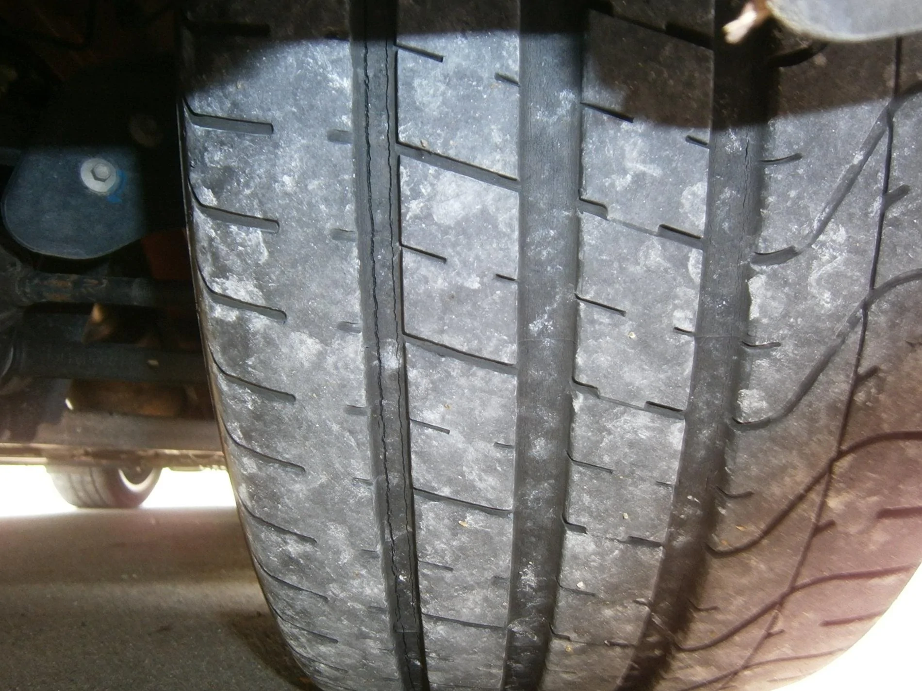

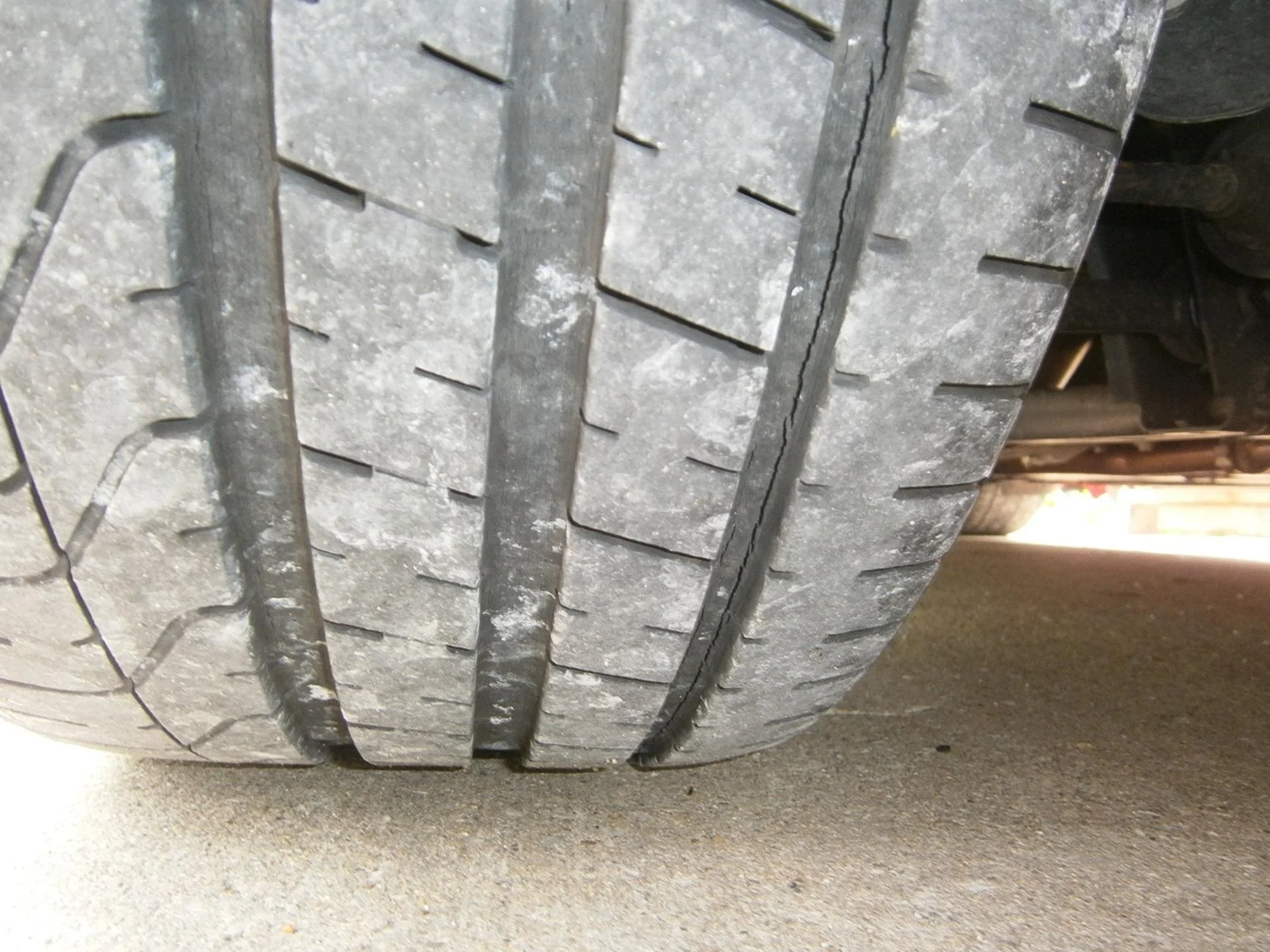

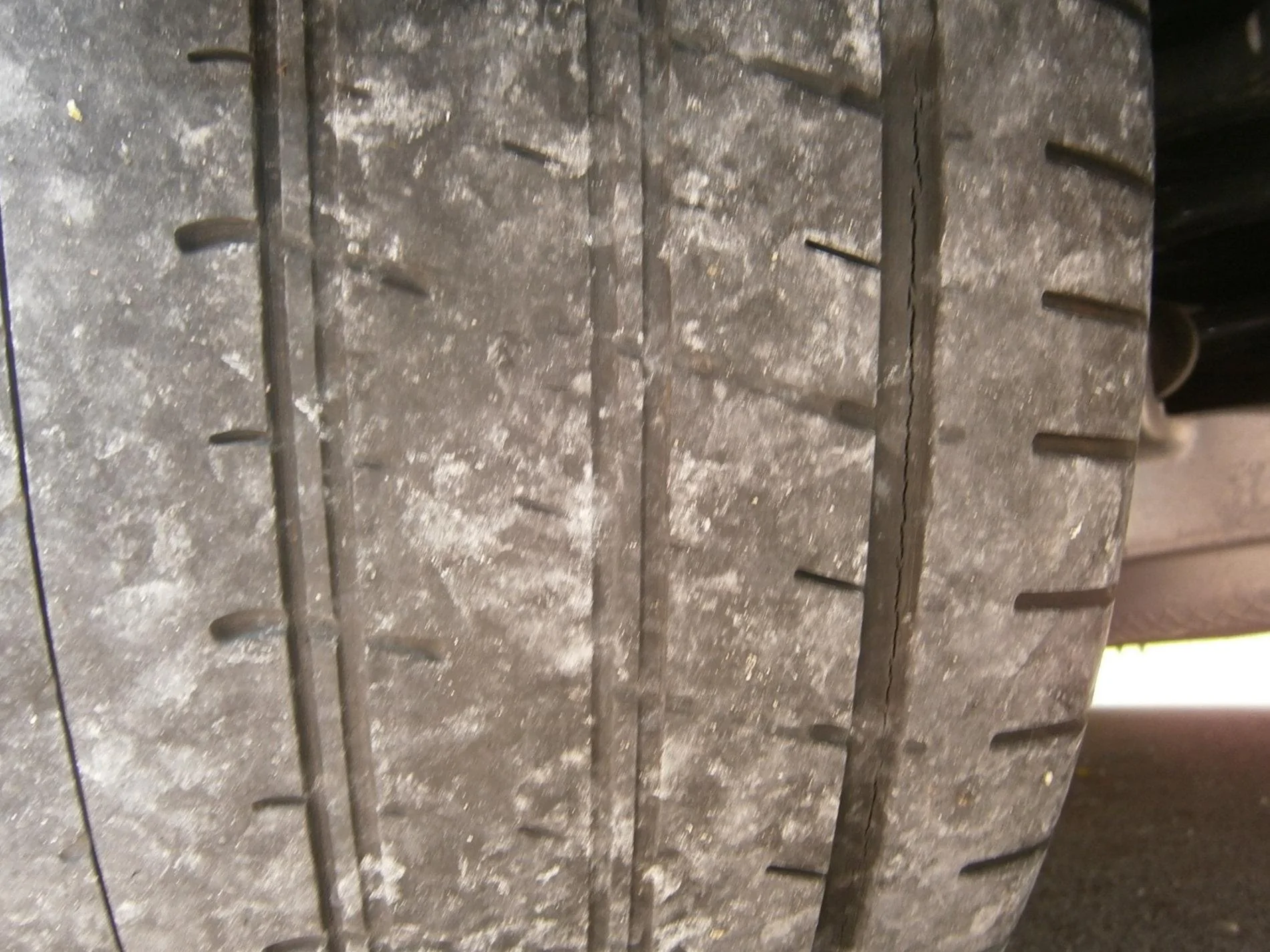

So my 2016 GT PP is currently parked as the 3 original tires (1 replaced due to puncture) have developed cracks in the tread area. Only 9,900 miles, and now the Pirellis are shot but not because of the short tread life, surprisingly. The car is parked during winter. To me and the dealer, this issue is not normal and should be covered under the warranty as I am still under the 3/36. My new car warranty guide states that tire defects will be covered 100% if under 12,000 miles during the 3/36 new car warranty. Ford has told the dealer that tires are only covered for 12 months but no one can tell me where in my manual it states that (hint: it's not there).
I am hoping that someone has some good advice as this is ridiculous. I have dealt with the terrible transmission, avoided AC failure, and the rest of the issues that plague these cars only to have the terrible Pirelli tires crack. I know Pirelli will be no use, they will claim the car was driven when it was under 45F out.

Exactly the same meaning yours also has cracks like the OP?
Can you post up pics?

Taken from tire rack:
"Pirelli's warranty does not cover tires that develop compound cracking due to use in ambient temperatures below 45° Fahrenheit (7° Celsius), so the P Zero, like all summer tires, is not intended to be driven in near-freezing temperatures, through snow or on ice."
Use is also classified as storing the car (also known as supporting the vehicles weight on the tire) if temps fall below 45 degrees.
Id guarantee they see pictures of that and they deny helping you. Also, most tire warranties on factory equipped tires are only a 12 month, 12k mile coverage, and normally they include a supplemental tire warranty packet, separate from the vehicle warranty packet.

I just replaced my front tires on my 2017 GT PP two weeks ago for the same reason. I ended up buying new wheels and figured in the meantime, I would just swap my original tires over to them until I could save up some more money to get the tires I wanted. I removed the tires form the car myself and took everything to the tire shop. As I was loading everything in my truck, I noticed my two front tires looked just like your pictures, my rear tires were fine. Got to the tire shop and they said the tires were junk.
My GT has a build date of June of 2016 and I bought the car in August of 2017, it had just under 4,300 miles on it at the time. I live in Las Vegas, NV, so we may have a month or so where there are lows are below 45 degrees. My car is kept in the garage, so I can't imagine this was caused by cold temps, but maybe. I just ended up buying two more P-Zeros in the rear size, as I ended up buying a squared setup for wheels and figured I might as well run a squared setup for tires. Plus, two tires were much cheaper then having to buy four tires.
I did do a little online research and did find this seemed to be a common problem around 2016. A few people I found contacted Pirelli, and they basically said Pirelli told them they needed to ship the tires (on their own dime) to them for inspection. If they found the tires to be defective, they would then give them a pro-rated credit on a new set. I didn't really look much into it because I figured my tires were now close to three years old, so I am guessing Pirelli would do nothing.
