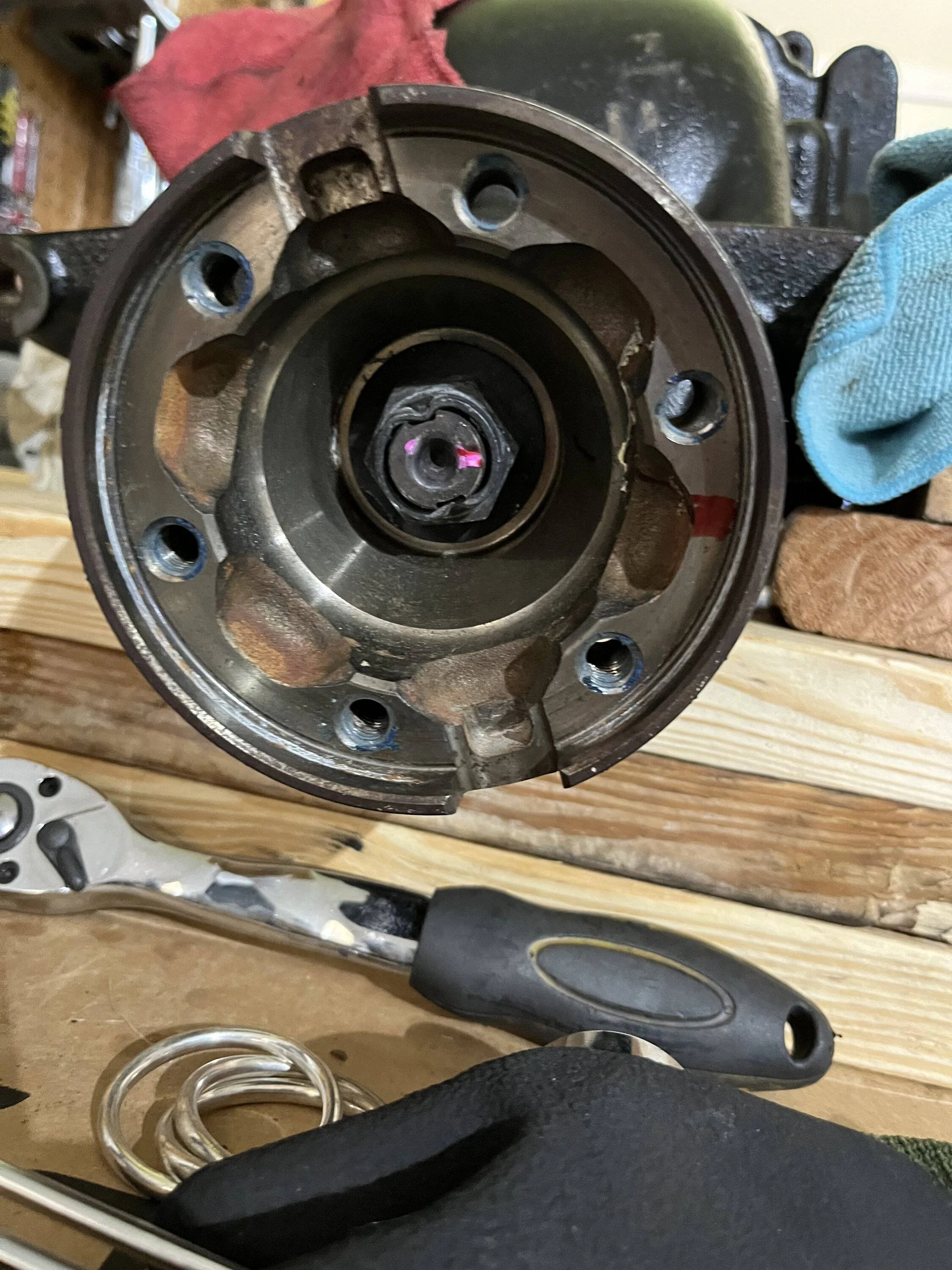

Yes the nut was staked. I literally just grabbed the diff with the ring, gave it a slight pull and it just fell out. I also noticed a lot of debris by the drain and fill plugs.

I did the opposite. Put resistance on the ring while turning the pinion. Saw someone do that on YouTube so I tried it. Now everything is disassembled. Once I put things together I will try your way. Much appreciated.

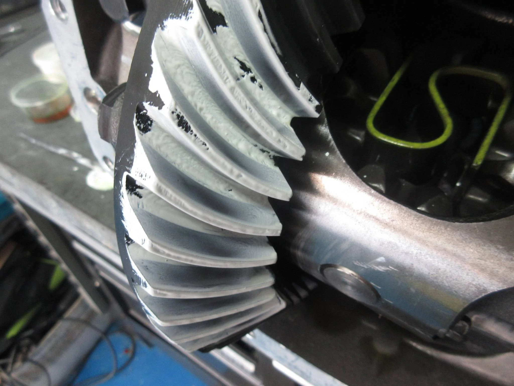

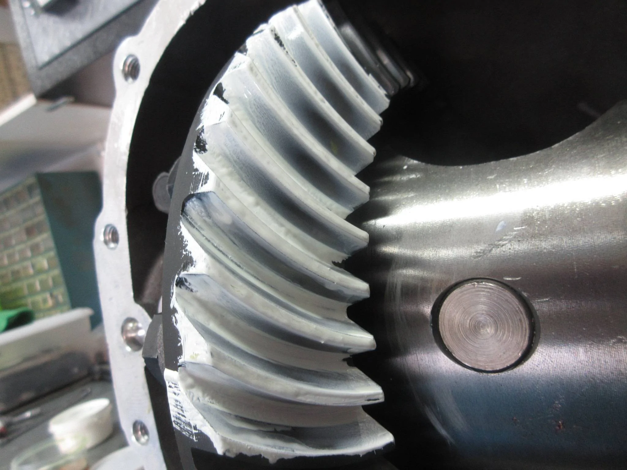

I set-up a 2019 Mustang Rear a couple of weeks ago, here was the patterns:
Drive Side:
Coast Side:
