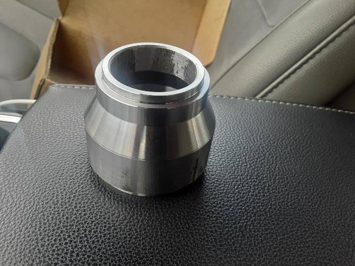

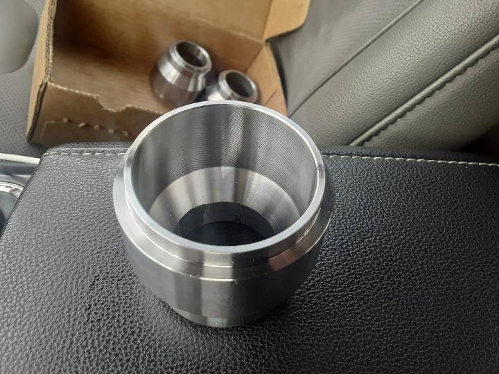

K4fxd
Apr 2, 2020
122
13,495
12,323
NKY
Dan
2017 gt, 2002 FXDWG, 2008 C6,
I hate crush sleeves too. Subbed for a solution for the 8.8 super.
Cory S
Dec 10, 2019
3,355
3,751
Bradford, NH
Cory
2016 Mustang GT Premium
My bud had 4 solid sleeves machined 2 weeks ago. PM me if you’re interested in one.
