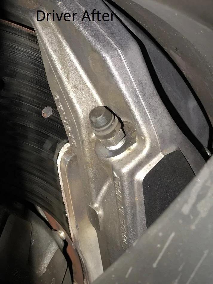

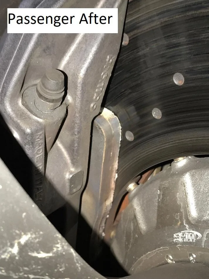

And front G-LOC brake pads are done after 2 track days (20% left)?!?!. Looking at Ferodo DSUNO or Pagid Yellow for my next brake pads.
That's really surprising. I'm pretty rough on my brakes as well and got 14 days out of my R16 G-Loc pads. What compound were you running? Any pics? Have you checked both of the pads? (inner and outer pads of both calipers?)

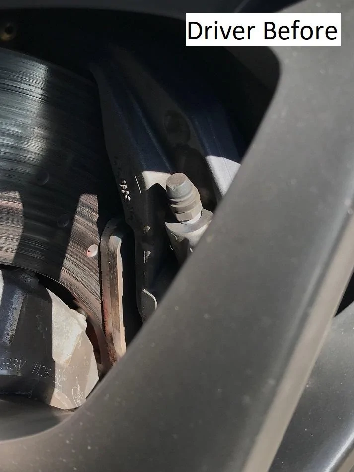

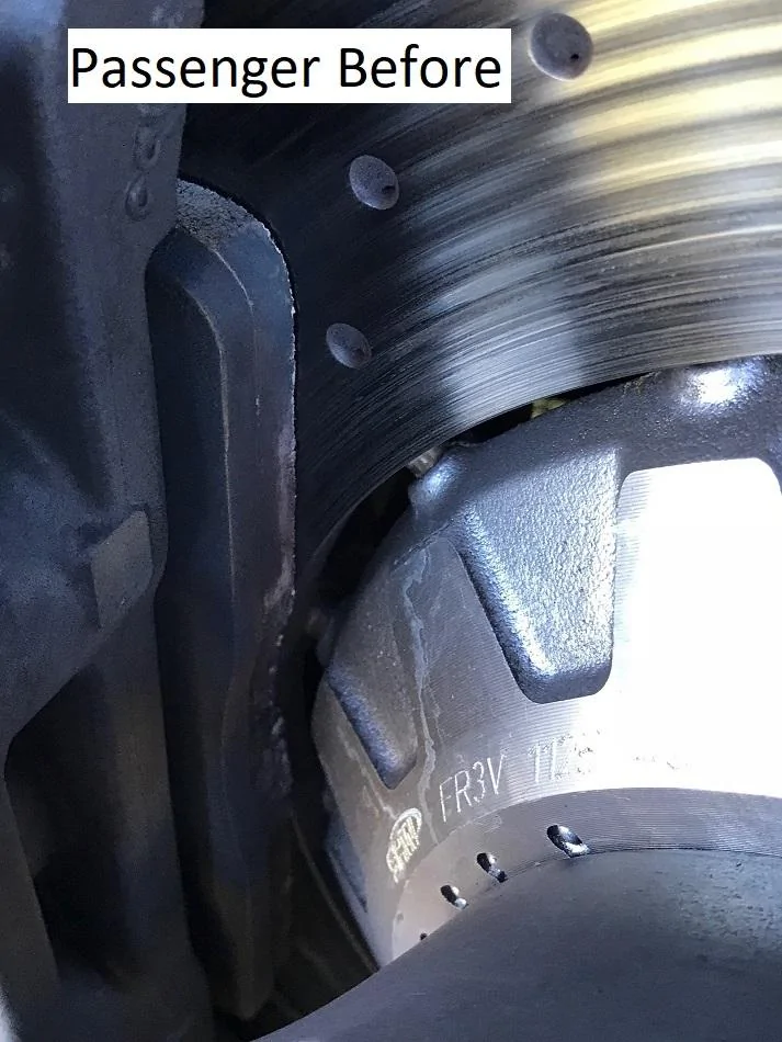

[MENTION=23430]honeybadger[/MENTION] yes very surprising and good question! I run the R18 front and R12 rear. The passenger side still looks good, but the driver side not good. The before pics were after the 1st morning session (very light session) and the after pics after the end of the track day 4th session. This was the 2nd track day with the G-LOCs.
The NJMP Thunderbolt track is 2.25 miles, with 12 right hand turns, and a one half mile straightway. I assume because of the right hand turns and the hard braking it caused the driver side to decrease that much. Thoughts?

I saw something similar actually. I thought it might be related to a bad bleed but maybe it's the stability control.

Looked at my brakes and same thing here as well with stock pads; driver side front nearly gone but passenger side is about 1/2. Total of 4 track days on these pads all at Thunderbolt.
Interesting results. I wonder what the driver's side inside pad looks like.
