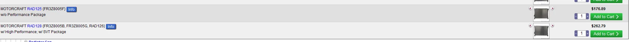

the performance pack size radiator is $100 new at rock auto
Huh? It's $262 lol
I did this mod a year ago, very much recommended. Base radiator is adequate, sure, but living at elevation it quickly becomes lacking. Now even in the worst street/mountain driving conditions I've never seen my CHT go above 227.
