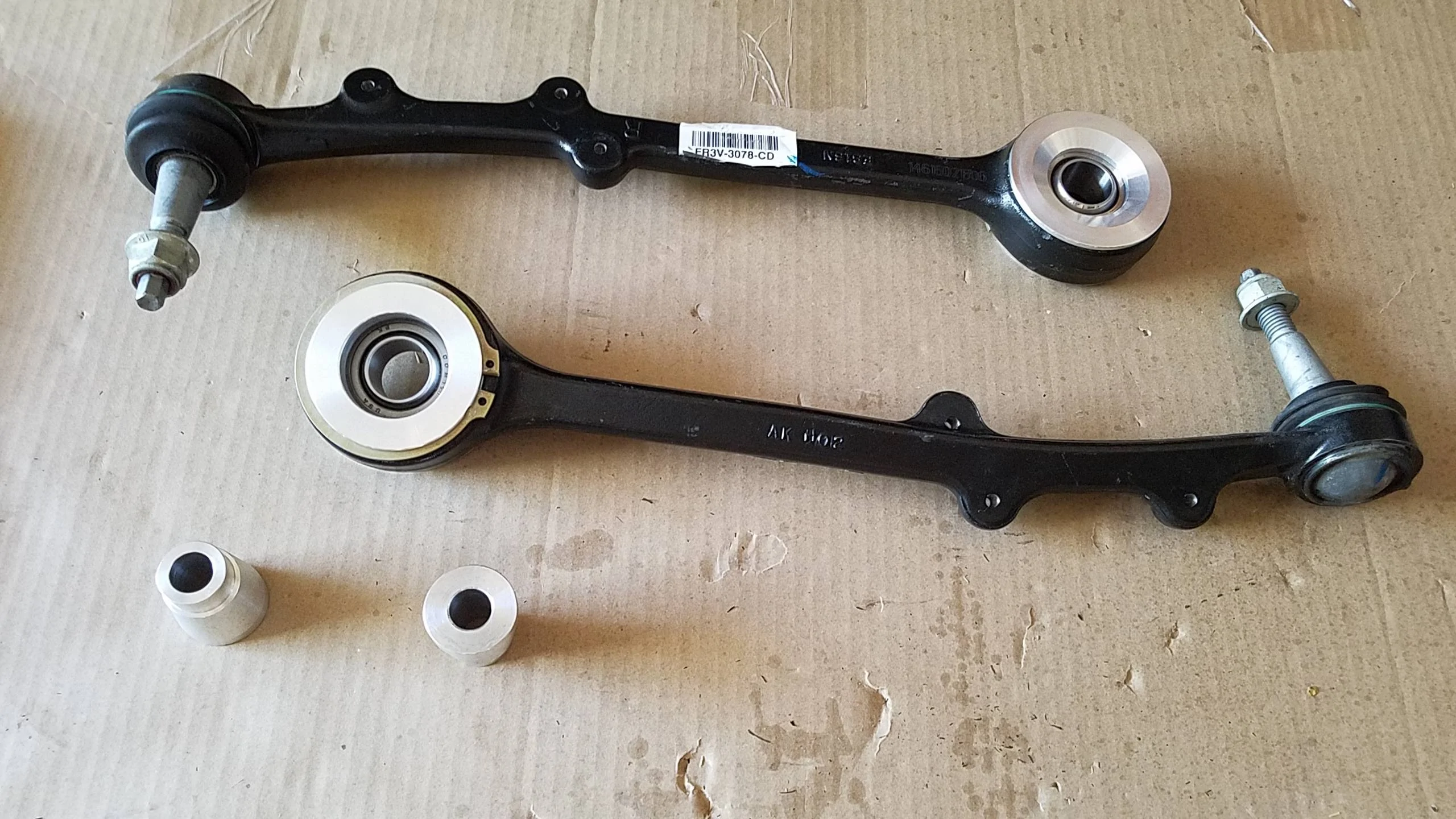

If you want sphericals in the front arms you gotta do it yourself. I just put J&M in mine the other day. I recommend sourcing the pressing pieces and shop press before purchasing because these are large bearings.

You can press them out and put in a new arm. And yes they make a world of difference. I will never use a bushing in the front arm ever again.

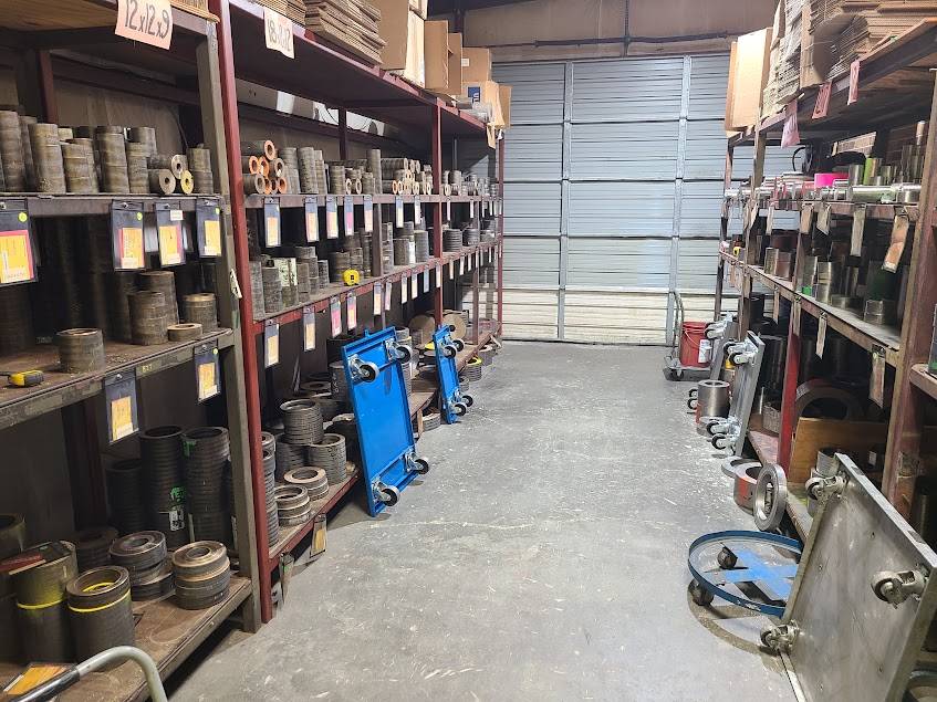

These bearings are too large to find a socket to fit as a receiver. If I had to do it again, I'd go to Metals Supermarket and get two short sections of steel tubing - one diameter for pressing, and another diameter for receiving.

But lucky for me I work in a machine shop so I have plenty of metal to experiment with. lol

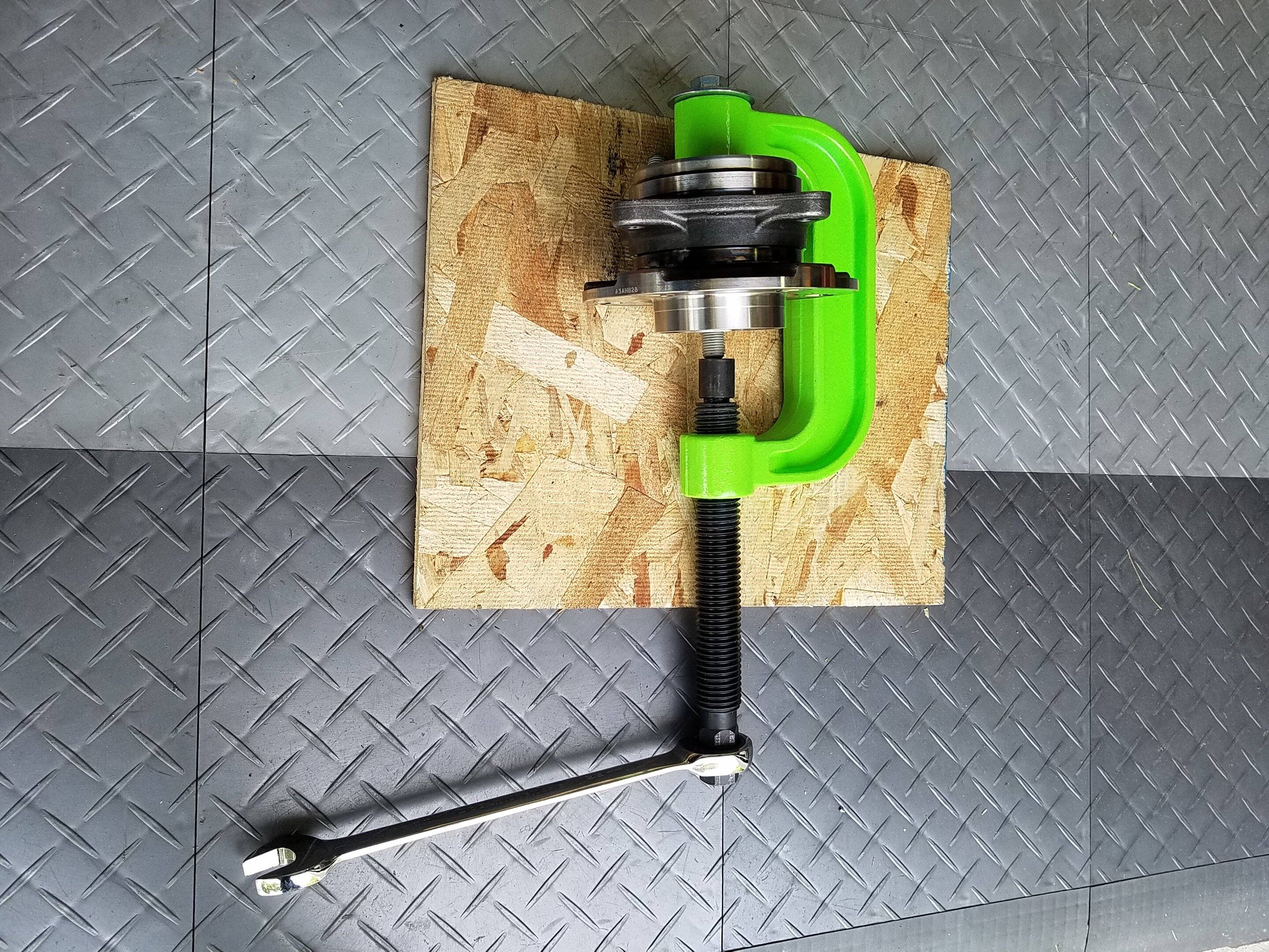

When I installed the FP Track Handling Pack I used this Maddox Ball Joint Service Kit to press out the rubber toe link bushing and press in the spherical bearing.
Is something like that going to work for the front control arm, or am I going to need a proper shop press?

You will still need to source pressing and receiving collars to use with a ball joint press.
I think it may be harder to press out the nearly 3" steel bushing than it will be to press in the aluminum bearing.
You need properly sized collars whether for hydraulic or ball joint press so it's worth a try.
I used a ball joint press to press out wheel studs, but the control arm bushing will be held much tighter IMO.
