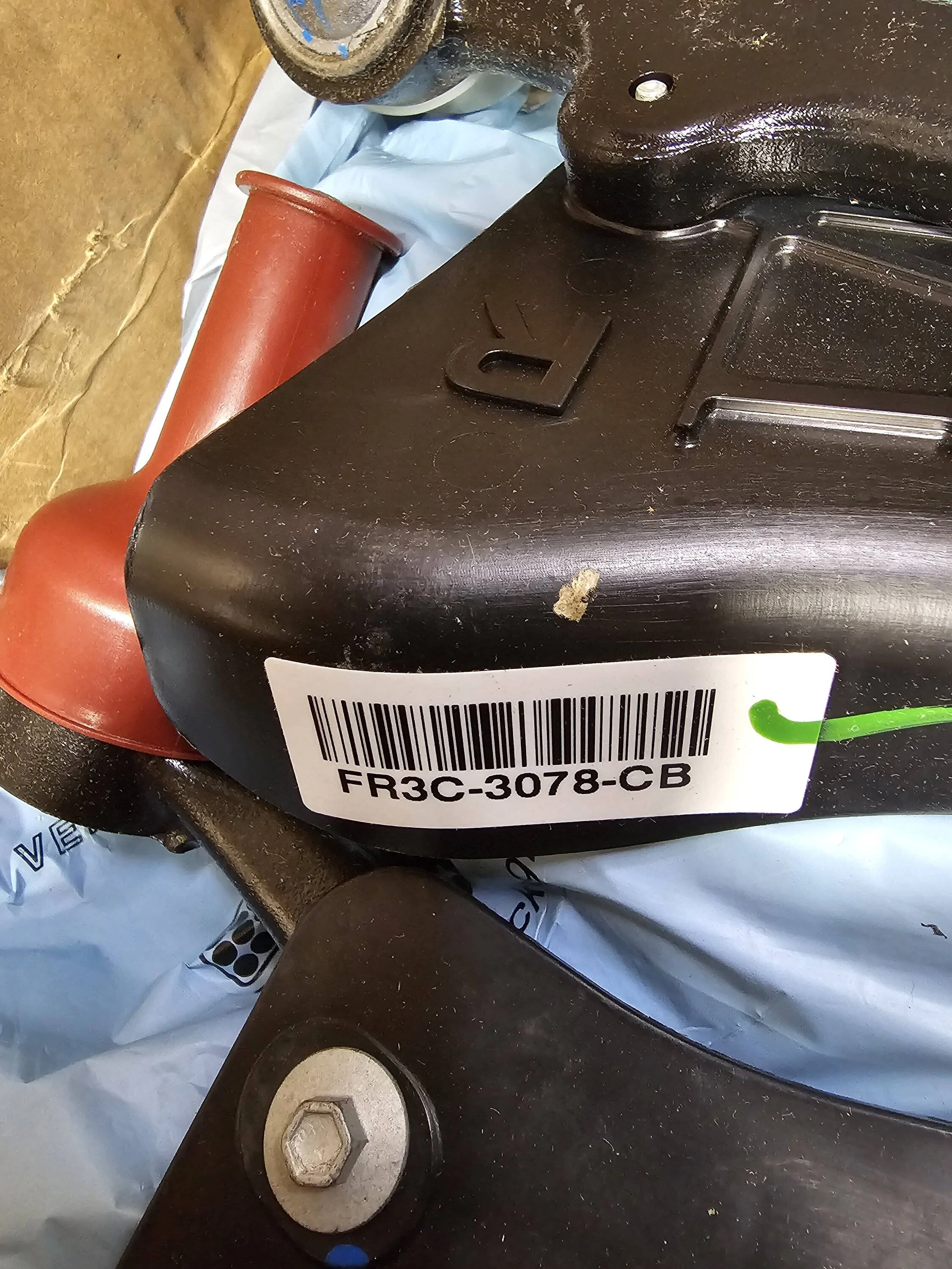

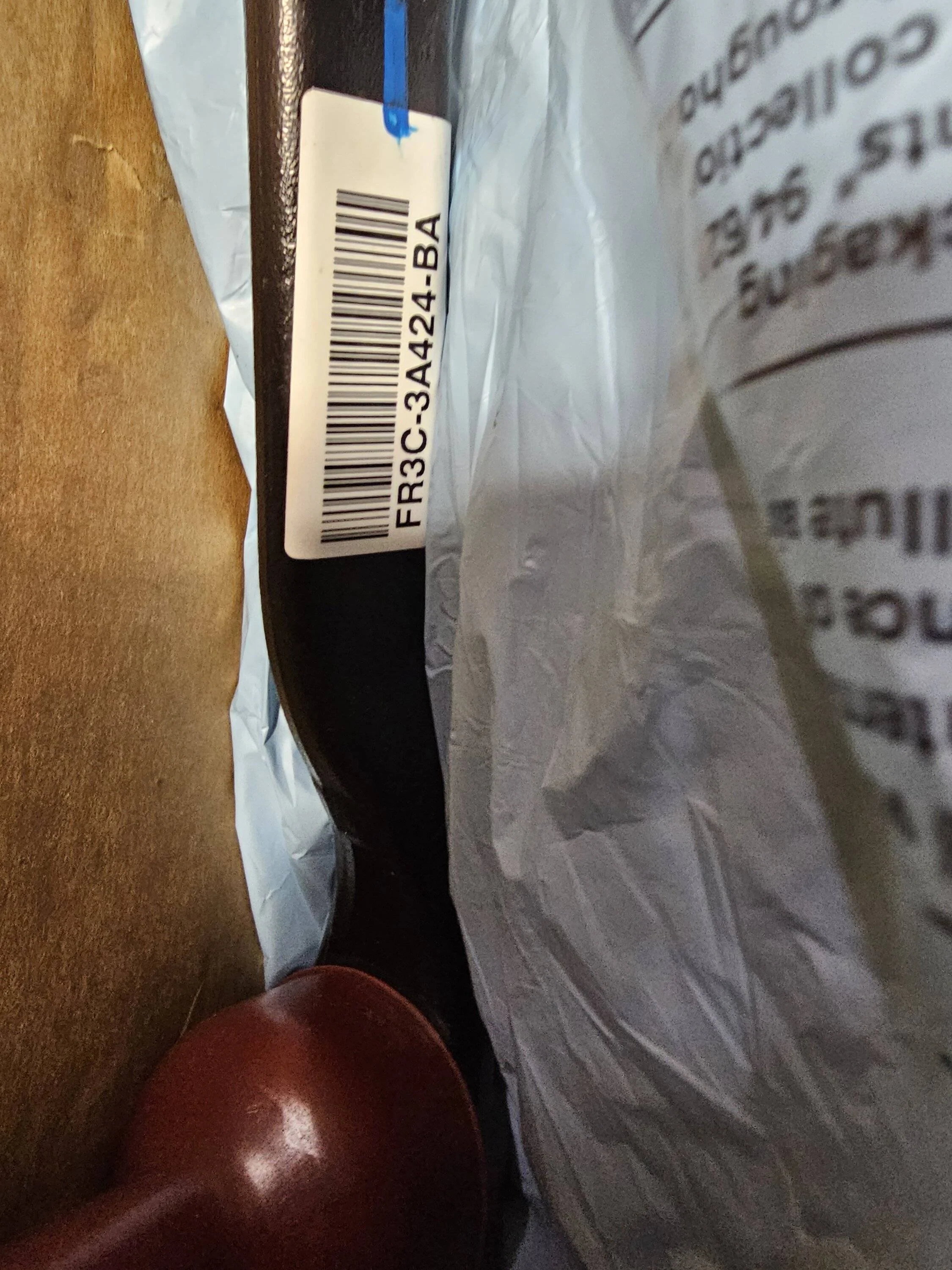

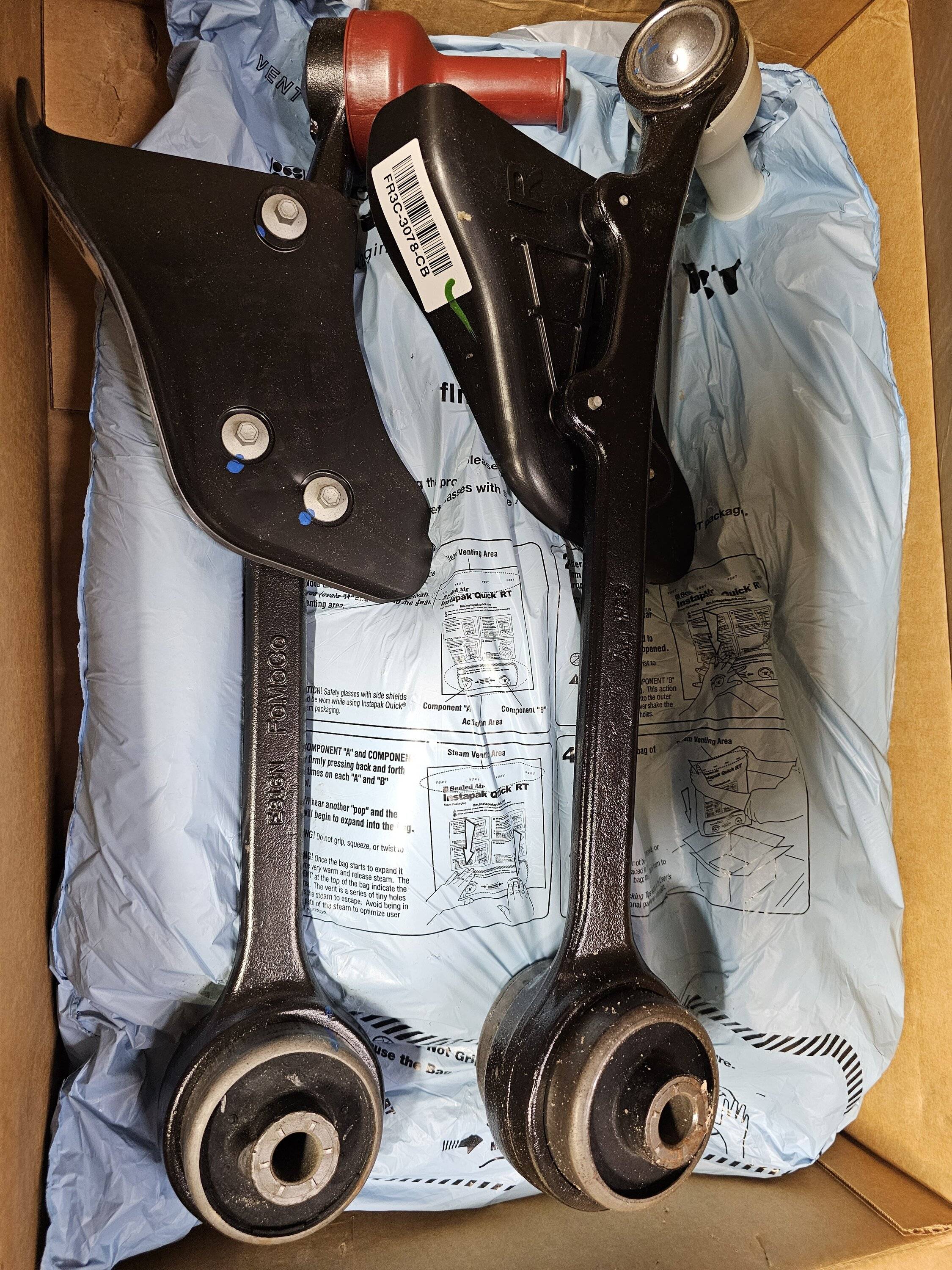

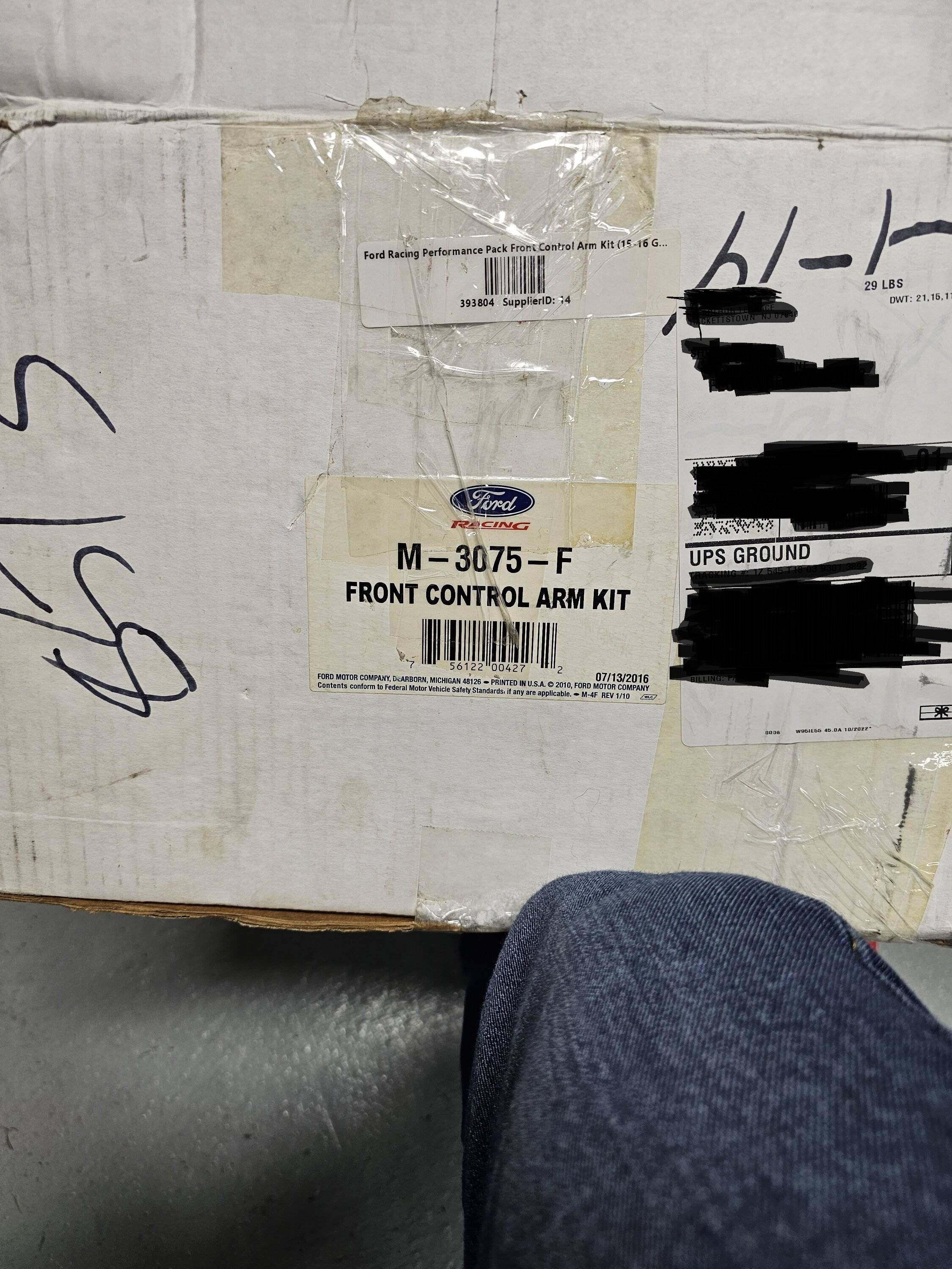

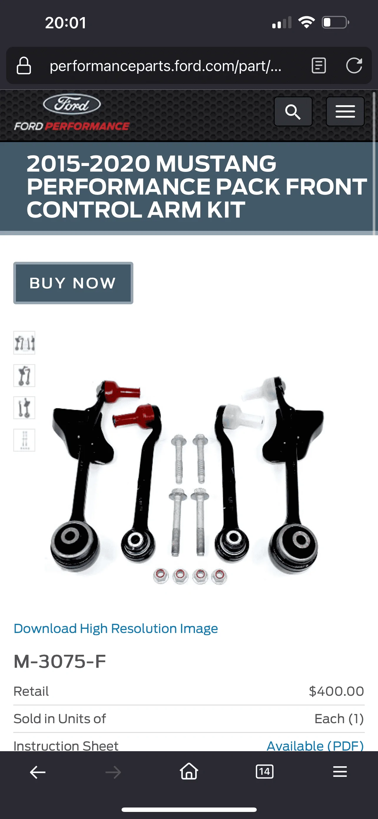

Can anyone verify if these are indeed PP arms. Supposed to be M-3075-F Ford performance kit. When I cross the part numbers everything says for "non-performance pack"
Thanks.

Non-pp arms do not have the brake cooling vanes on them like the ones you posted photos of
I thought they were supposed to have a spherical bearing.
When I cross the part numbers it comes up as non PP.
So I'm confused, which is normal. LOL

This is the description from Ford Performance website.
  • Fits 2015-2020 Mustang GT and 2.3L EcoBoost
  • Original equipment on 2015-2019 Mustang GT Performance Package
  • The Rearward Performance Pack Front Control Arms are forged steel and contain a spherical bearing mount versus the tubular weldment and rubber bushing found on base Mustangs
  • The Forward Performance Pack Front Control Arms are forged steel and contain an air deflector to aid in brake cooling
  • Includes right and left forward and rearward front Performance Pack control arms and all installation hardware

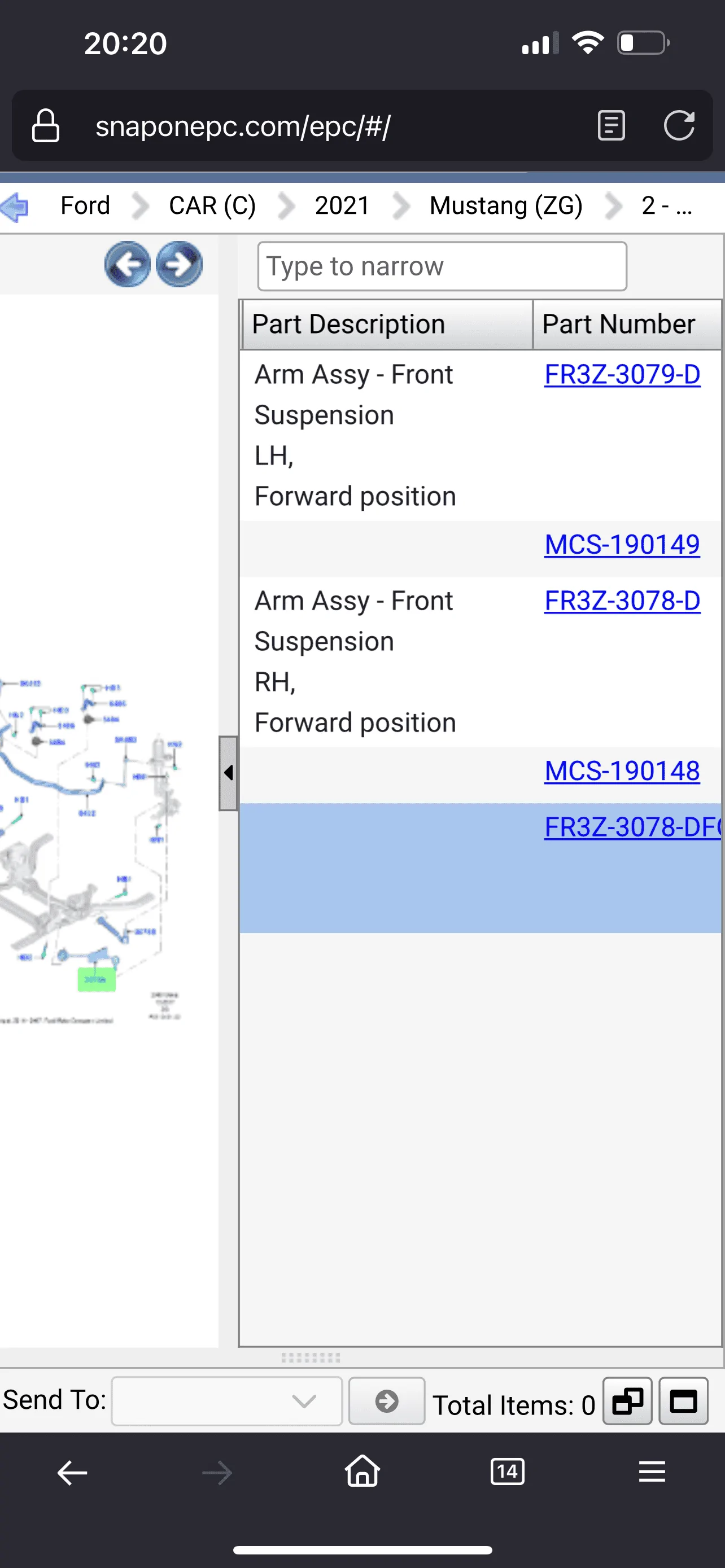

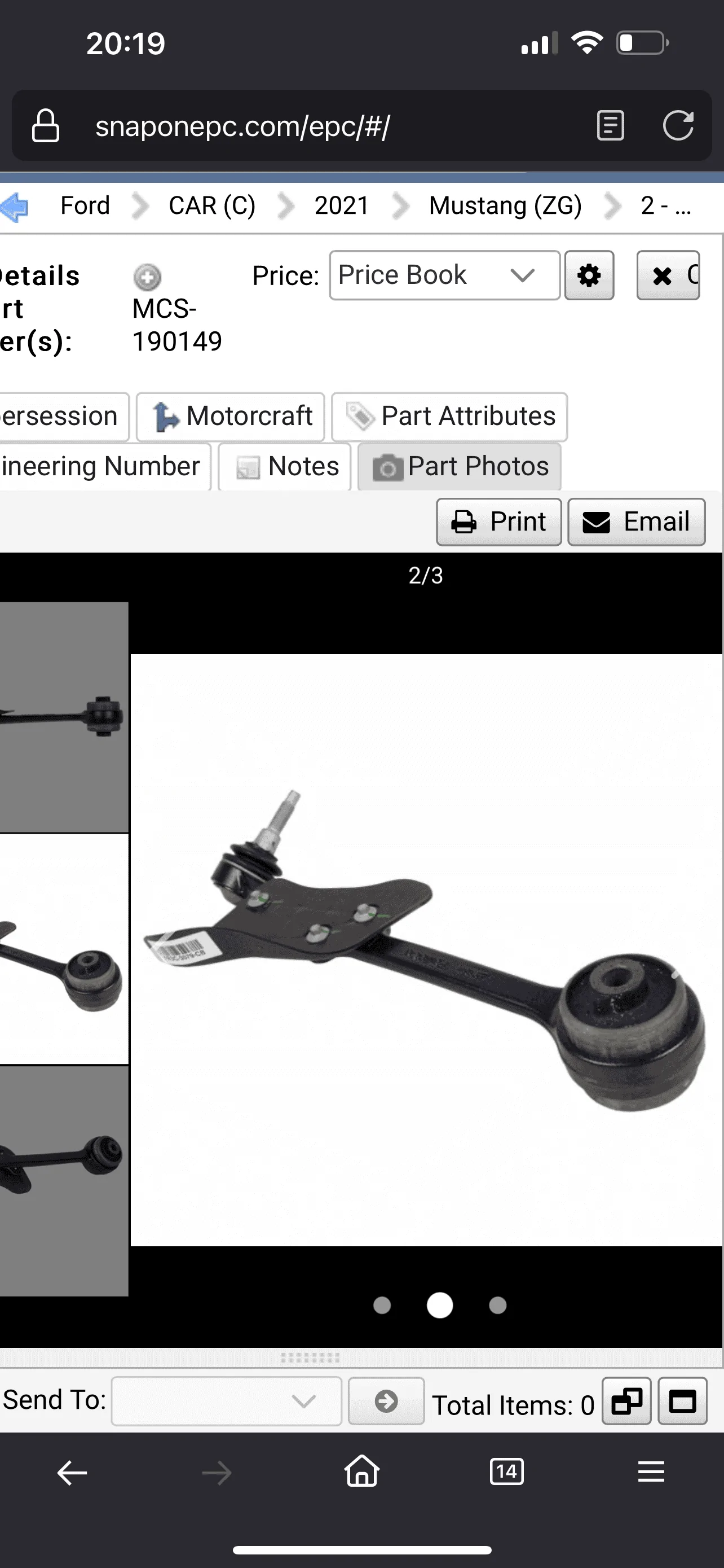

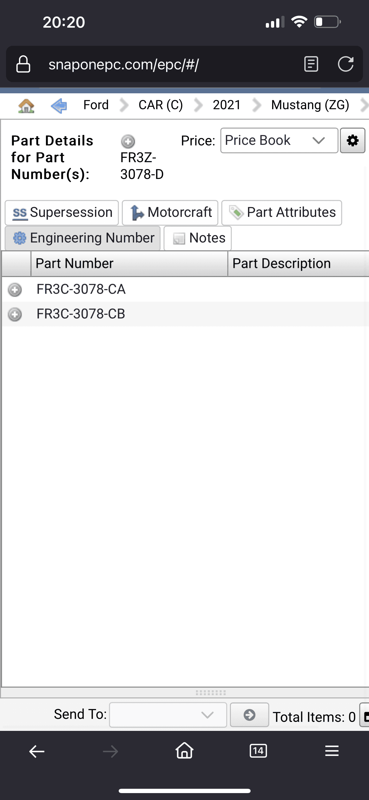

Photos taken from the VIN parts of a 21 GT in the parts catalog. Unless there’s an error somewhere (possible) these numbers should match up

Thanks for the info. I looked a bit closer and the rear arms MIGHT be a bearing with a dust boot, but I don't think so.
At least I know I got the parts I am supposed to have.
Thanks again.

I think so ... they are bearings with dust boots. The fronts are standard.
GTP is right, and Optimum Performance is making a good point.

Those are Ford engineering numbers, not service numbers. Those are PP arms, only spherical joint is in the rear mounted arm. If you want spherical forward arms we have been doing this for the past 6 years and can't recommend the improvement in driving dynamics enough.
