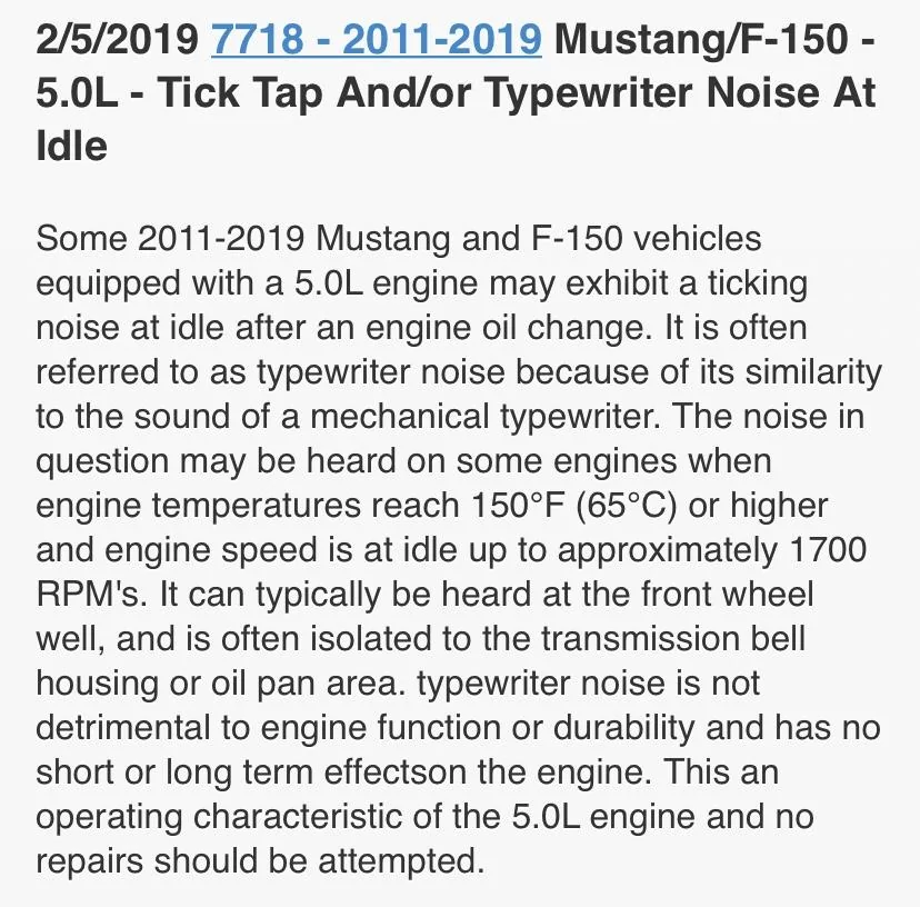

Per Ford (officially) the 2011-2019 F150/Mustang 5.0 “Typewriter Tick” is a normal characteristic

(Note to Mods: Posting this here initially as this is the most viewed sub-forum - please leave here for at least 24hrs before moving to the Issues/TSB sub-forum - thank you).
Yep, you’re all reading the thread title correctly...
Also notice how the document expands the applicable vehicle starting year as far back to 2011, covering prior F150/Mustang 5.0 model year Customer complaints/concerns.
Since this is an official release, I would not expect Customer concerns to get much traction, as this doc will be referenced to the Customer as being “a normal characteristic”... UNLESS the noise the customer is hearing is beyond a “typewriter noise, a tap or tick”.

Thanks for posting this. Wonder how they determine what is considered abnormal then. I would also like to know what the explanation is for WHY it’s doing it, but thats probably wishful thinking.
Edit: if it started before an oil change is that considered not normal and not covered by this message?

Interesting. If nothing else, it’s a statement vs silence.
However, it states a ticking noise “after an engine oil change”. Mine started at 1,300 miles, way before an oil change.
If they would only explain why it’s normal after an oil change, or why it’s normal regardless.

Yep, That’s what Ford 5.0 Powertrain Engineering told me 6 months ago. Also said it was oil cavitation causing the noise.

I am not surprised that they say it is not detrimental. I am disappointed that they don't say why it occurs. In the first sentence, they use the term, "some....vehicles" but in the last sentence, they it is an "operating characteristic" of the 5.0. I feel cheated....mine does not have that operating characteristic. Maybe I need a new engine. LOL :crazy:

Technically, I don't see where that statement from Ford says its normal. It says its not detrimental. May not be detrimental to engine life but neither would sounding like a continuous loud fart. Either is detrimental to enjoyment of the car.
Would be nice if they eventually explain why it happens. Obviously they know or they would have no basis for saying it isn't detrimental. It's definitely a quality issue since part of the definition of quality is consistency and meeting the design targets. So unless the design documents say they should tick or at least say its alright for them to tick, its a quality problem. I have to assume the design does not refer to that or it would not have taken years for Ford to say is not detrimental.
I think Chevy and Dodge should mention this non detrimental sound in their advertising. If being Ford tough sells trucks, I don't see why not being Ford noisy wouldn't sell pony cars.
