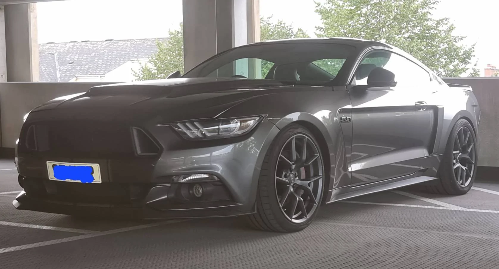

How much has it lowered the front? Any pics? :clap:
I'm assuming its not too stiff as the springs are a fairly similar rate to OEM?

I had Peddars lowering springs all round but due a pot hole I snapped a front coil spring so decided to fit Peddars ez fit (which they were)shocks and springs up front. Along with Steeda uprated ARBs and stop the hop . Ride I would say is a little firmer than stock, I have 20's on so with stock 19's I guess would be close to original.

That reassures me I was a bit worried the 25-30mm drop they quote would be too much. Similar suspension mods I'm doing at the same time along with g trac brace.
