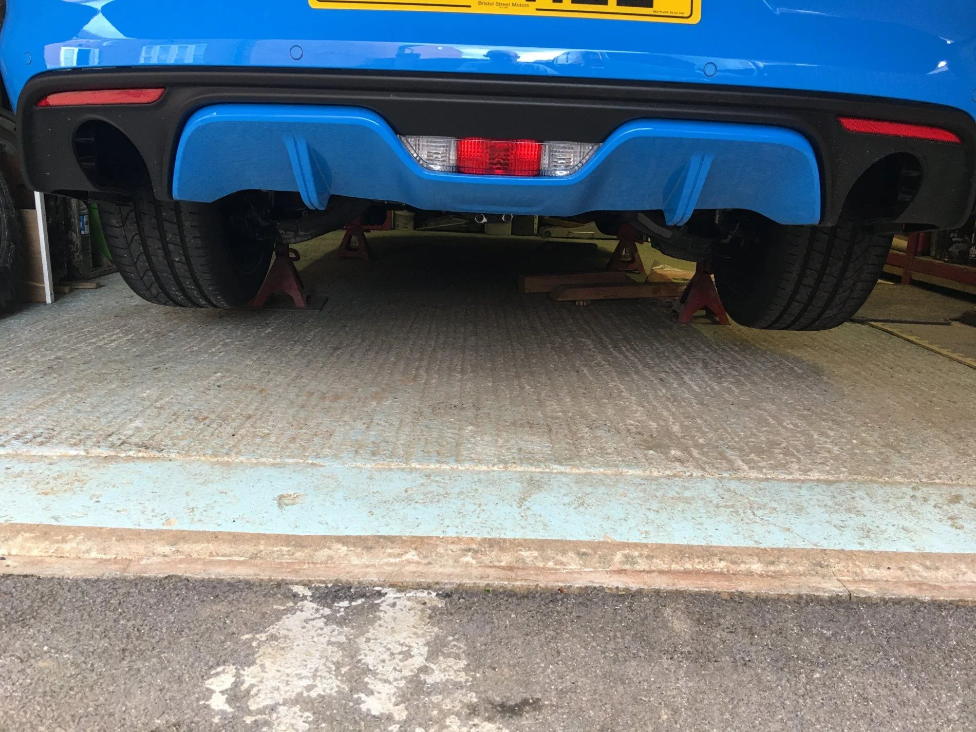

I’ve made nylon blocks to sit between stock axle stands and the S550 inner sills/ slim jacking rails.
So, right here right now, 10 pm on Friday 24th May she’s up on axle stands.

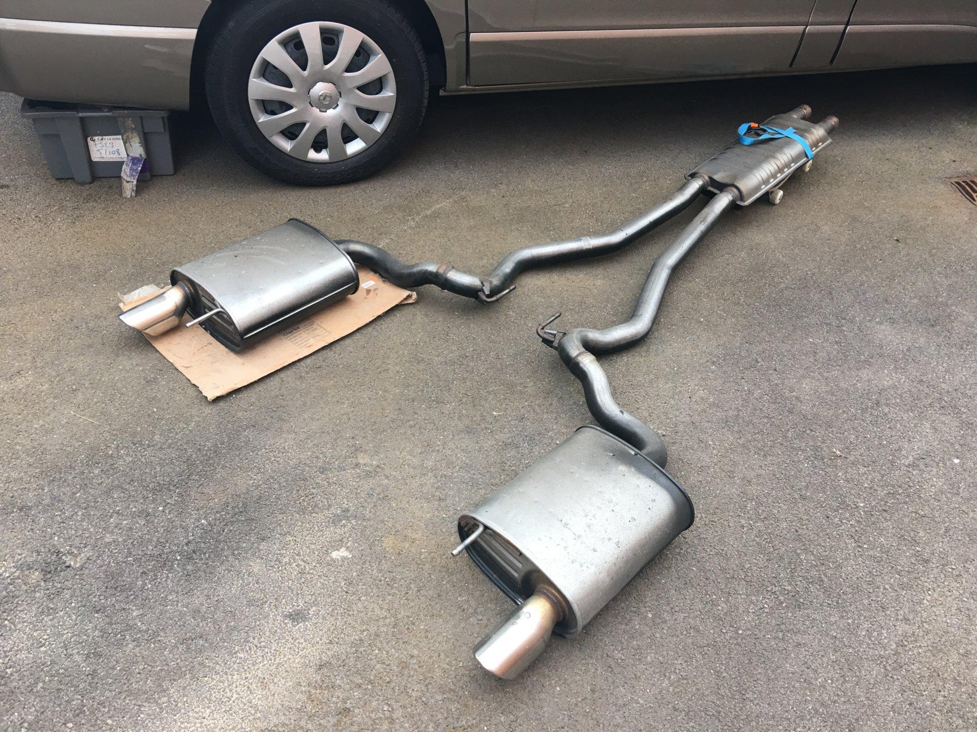

Anyway.. heres proof that I have actually removed the exhaust..I mean really. I've only had the Atak for about 18months..
I fear I may need to keep this pipe for MOT's???

naah you won't.
so another 18 months without an exhaust on ?

indeed, just fire it up as it is you'll soon decide you don't really want to put any new metal there anyway :)
Yeah, excess weight and all that. I cannot believe how heavy the stock system is!!

can't remember the exact weight i think the suitcase resonator is something like 30 pounds
