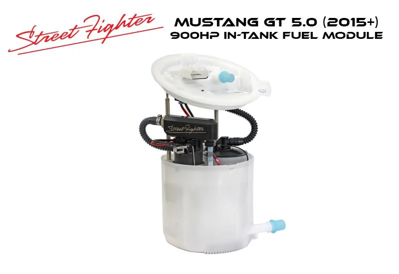

That's certainly another option, and probably a better one. But that's also twice the price of a boost a pump, so a little different. That's very similar to the modified GT350/500 fuel hats people sell in the US like Sai Li and others.
Of course that's 900 Aussie dollars which, is quite alot less than U.S. dollars.
Torinate
Feb 18, 2018
88
2,038
943
Ontario
2016 GT Convertible
Just about 700 USD.

Can these be sent to the US?
I can’t see why not, KPM Motorsport tuned one of my other cars, they have some excellent Mustang products and are awesome to deal with and very accommodating. You’d have to call them, 08 8299 9998 ask for David
