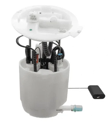

Your car has 2 pumps in the bucket, and there is no pump on the passenger side. Just a sending unit and a tube that uses venturi to pull fuel over to the driver side. Just replace the entire assembly. FR3Z-9H307-F

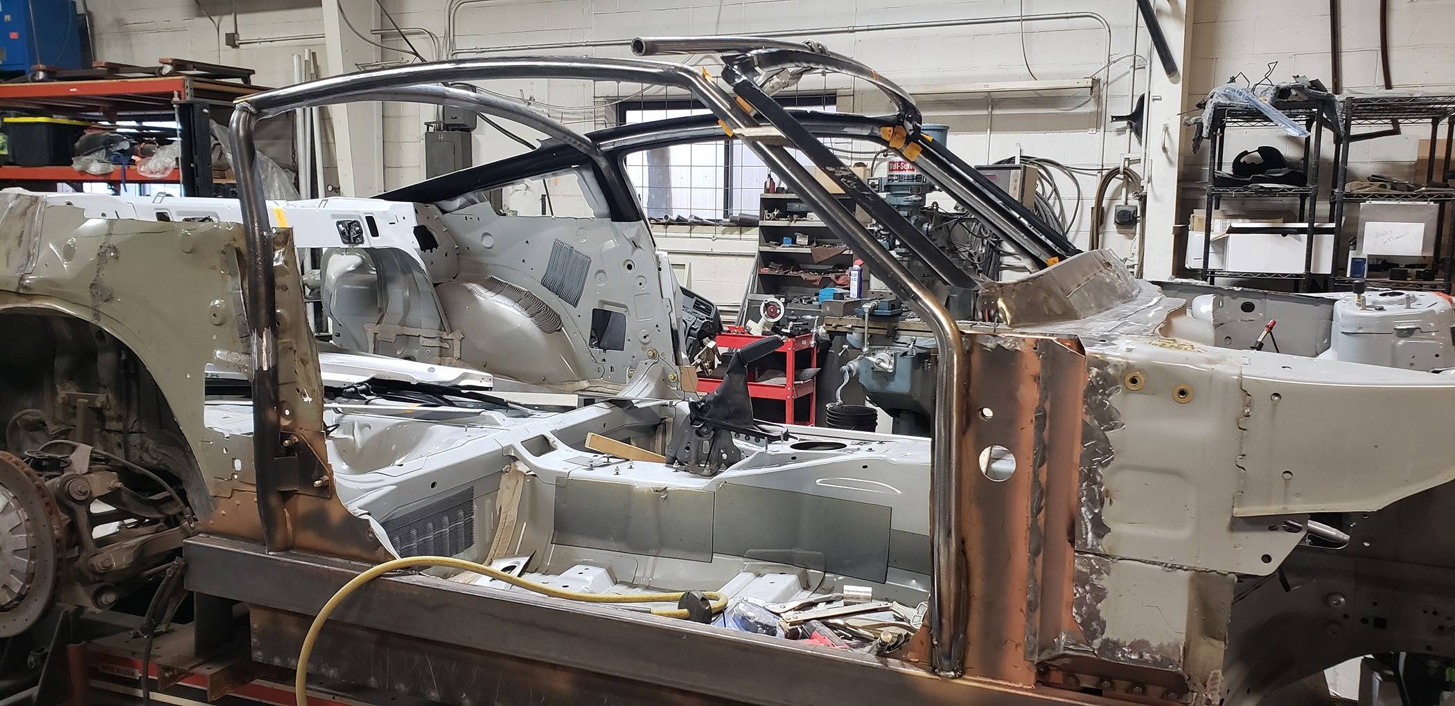

If this was a regular customer vehicle I would agree with you and just go that route. However, the fact that this one has 7,800 mi on it, and the fact I have had literally everything off of the car that unbolts, unplugs, unclips and many many panels that were previously welded. I want to try and figure out how to verify if it's just a case of the pump died, or did something not get hooked up correctly in the reassembly process. The tank was out, but I do not remember ever pulling the sending unit out of it.

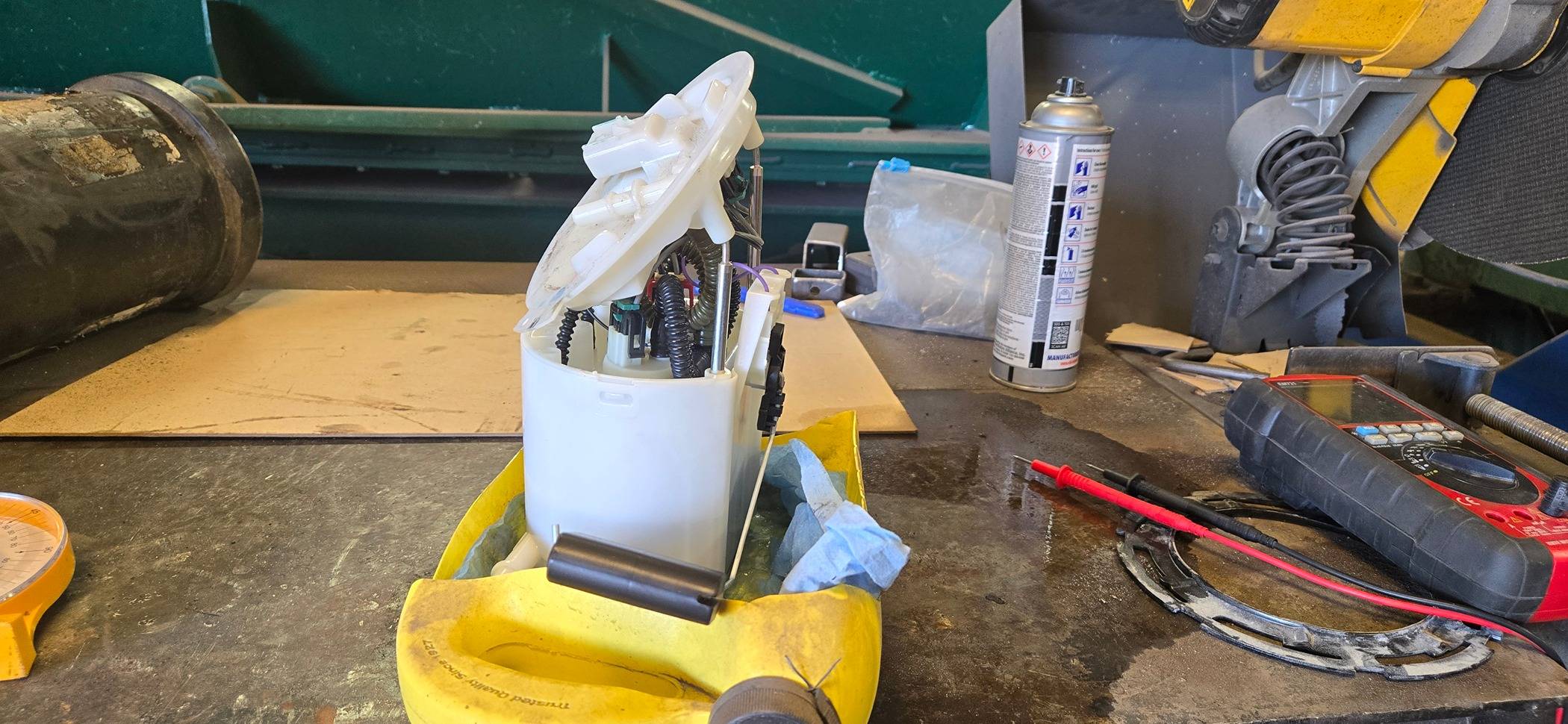

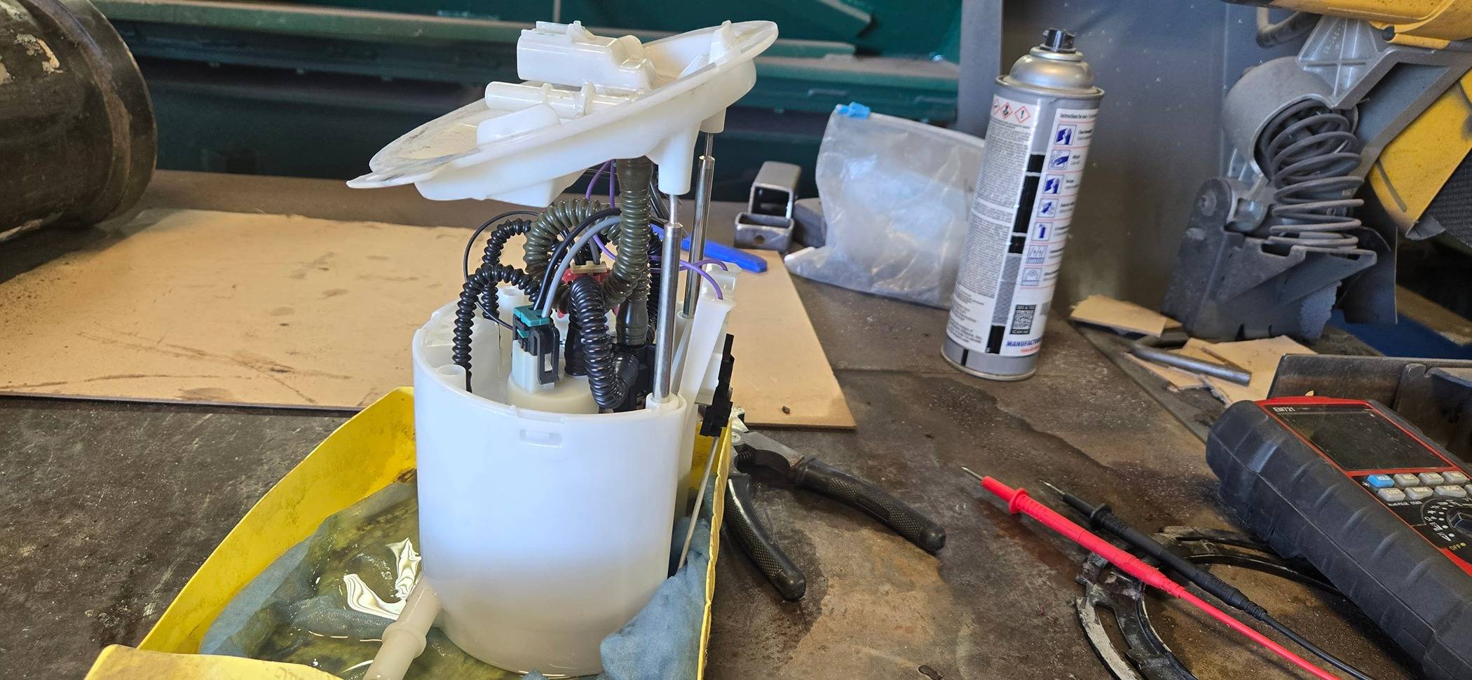

Found the problem. The car had hit a curb pretty hard in a past linfeand bent the hanger for the pump. I could easily see why it wasn't pulling fuel under a half tank.
