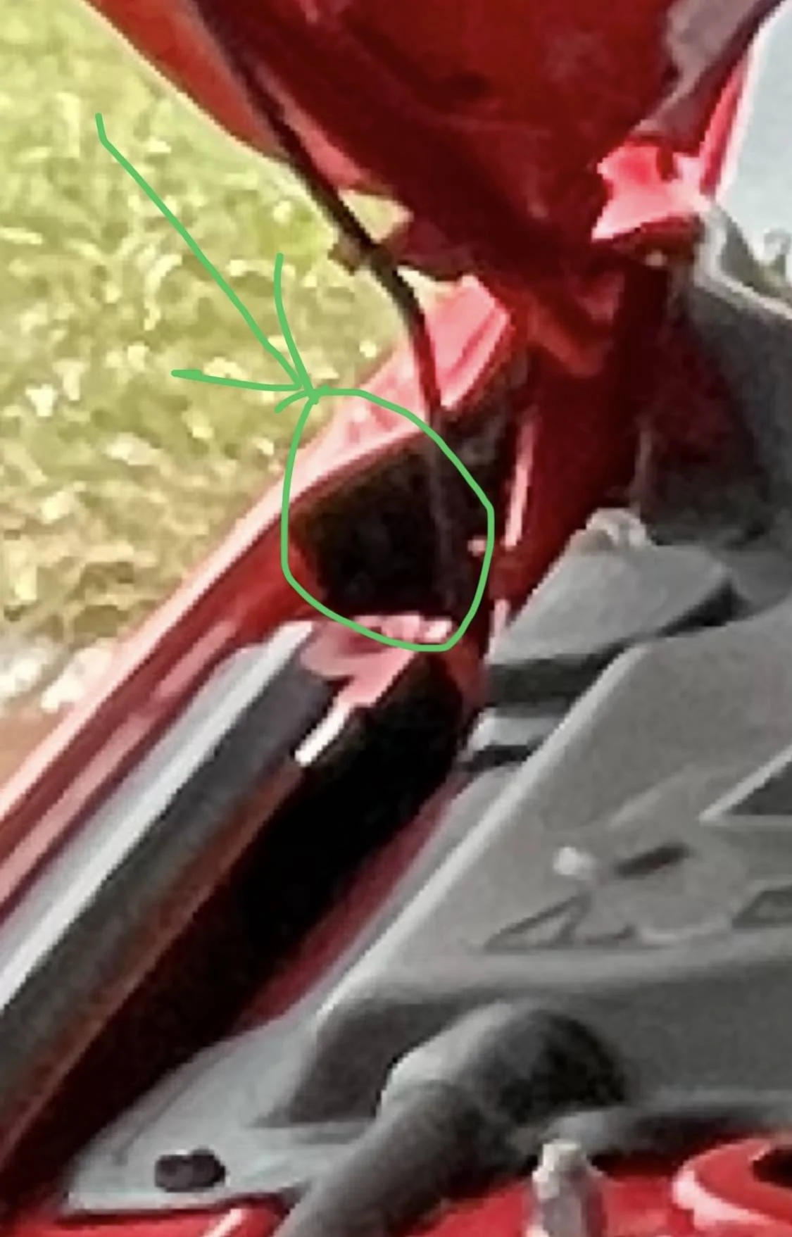

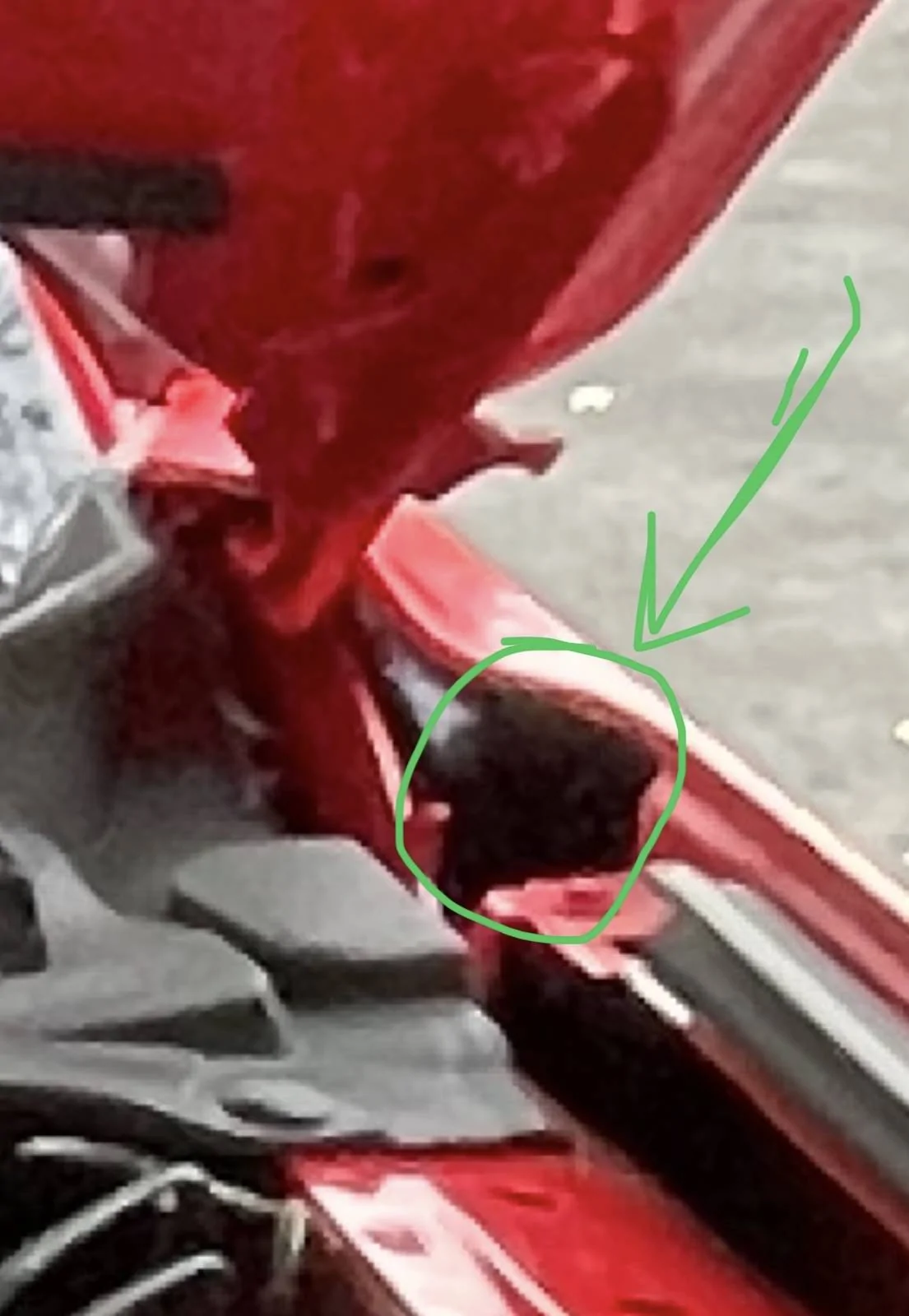

these two points on either side of my 2023 GT, do they lead to the areas behind kick panels by chance? …for the purpose of running an electrical cable between the engine bay and cabin…thank you.

No they do not. If you open your door you can see where that fender hole feeds to and theirs is some noise insulating foam in that cavity.
The best place to run wires from hood to cabin is just below the battery tray. There’s a large rubber boot there you can push feed a wire through or you could drill a new grommet hole in the flat panel near the boot.

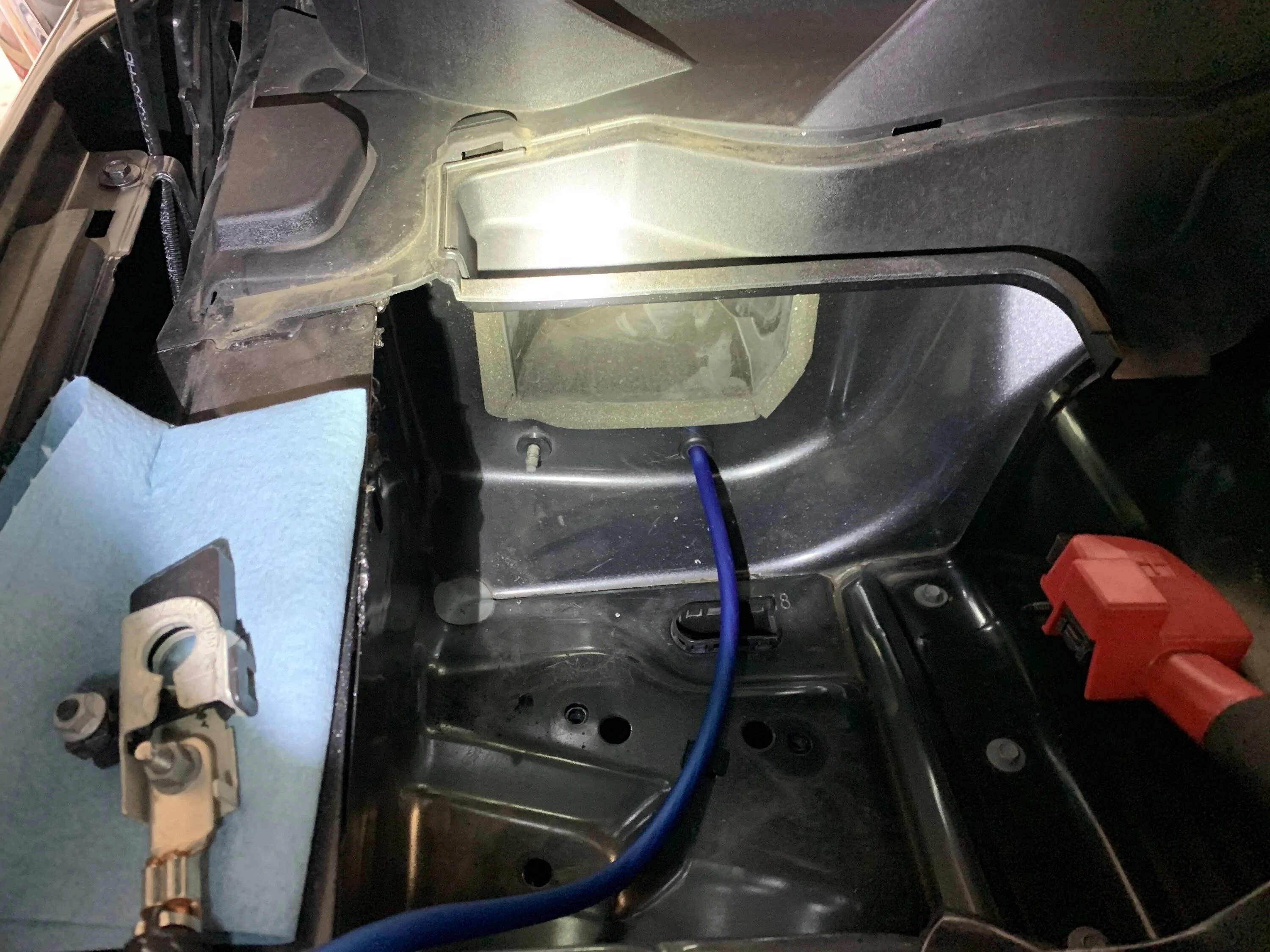

@Bullittproof, here is a short video of the pass through grommet that Evolved is referring to behind the wheel well cover. There is one on the driver’s side as well to facilitate passing wires down either side of the car. You will want to pull back the carpet inside the car, cut the nipple in the pass through grommet with a razor and tape your wire to a coat hanger to guide it through to the interior and pull the appropriate length of wire that you need into the cabin.
To give you a better idea of how many wires you can feed through the pass through nipple, the white wire is a 4 gauge power wire for my stereo amps and the remainder of the wires that are taped up with black Tesa Tape are for my N2MB WOT Box.

I simply drilled a hole behind the battery box and installed a grommet. It was super easy and didn't have to remove the wheel or fender liner to do. Just removed the battery and tray.

I ran mine as described by Evolvd and NGOT8R; super easy and I ran a 1/0 gauge wire.
