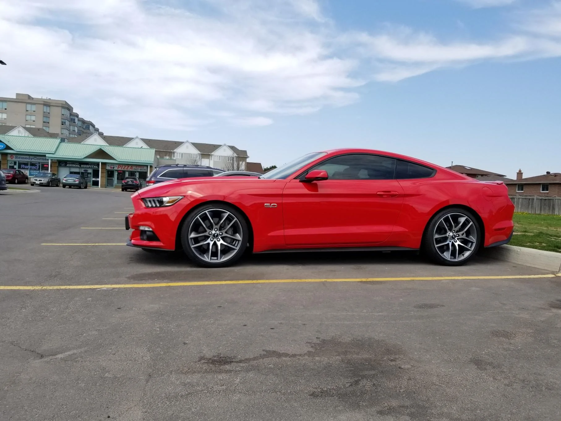

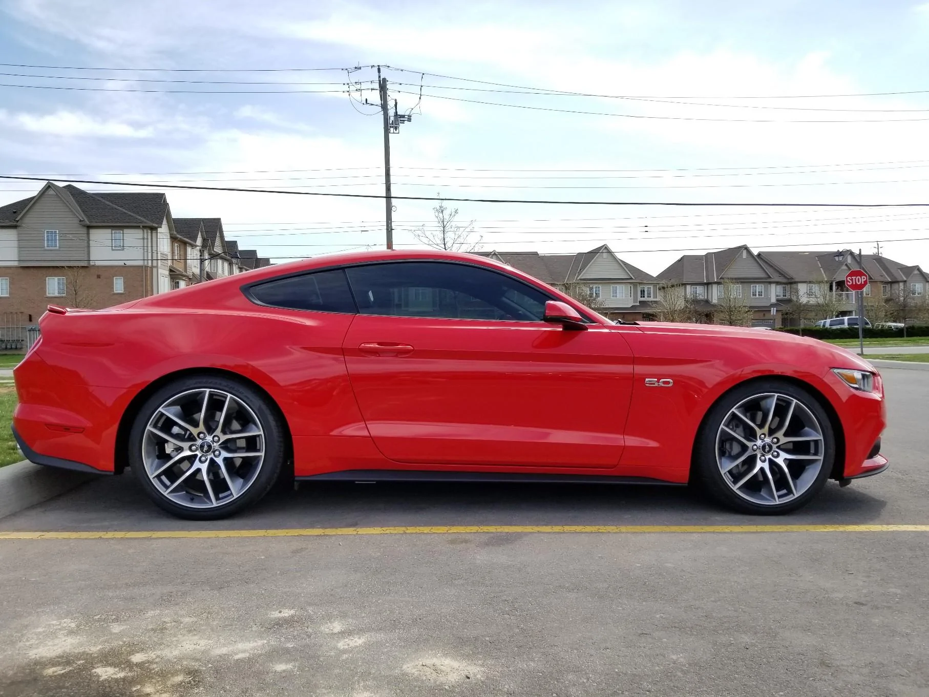

Give the Ford Street lowering springs a shot. M-5300-X
These springs are paired with the PP shocks / struts in the Ford Street handling pack.
The Ford Street handling pack is essentially the PP with the lowering springs. Just installed it on my car with a bunch of other steeda goodies and the ride and handling is amazing.
It's composed and predictable on even the bumpiest road surface without being rough. It just soaks up the bumps. Throw it into a corner or an onramp at speed and it feels like it's on rails.
Alignment will be kept within spec with these springs also.
Gonna quote Steeda Tech from another thread where I asked about dust boots on the Bumpsteer kit...
"The Steeda Rod end balls are made from stainless steel with a teflon liner and wiper. No need for a dust boot. We have sold over 20,000 kits in the past decade with no failures due to the elements. Furthermore, they have a lifetime guarantee." - Steeda Tech
