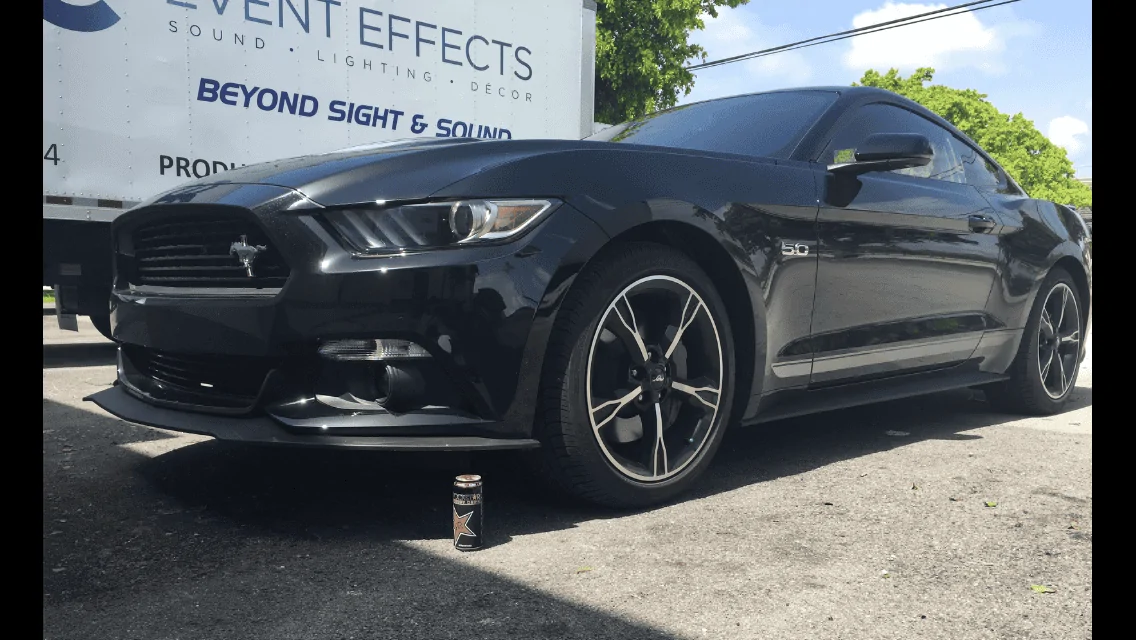

The speed bump one is hard to see. It's about 1 inch clearance.

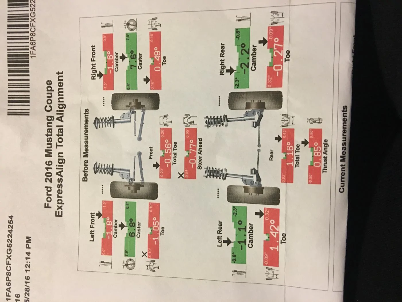

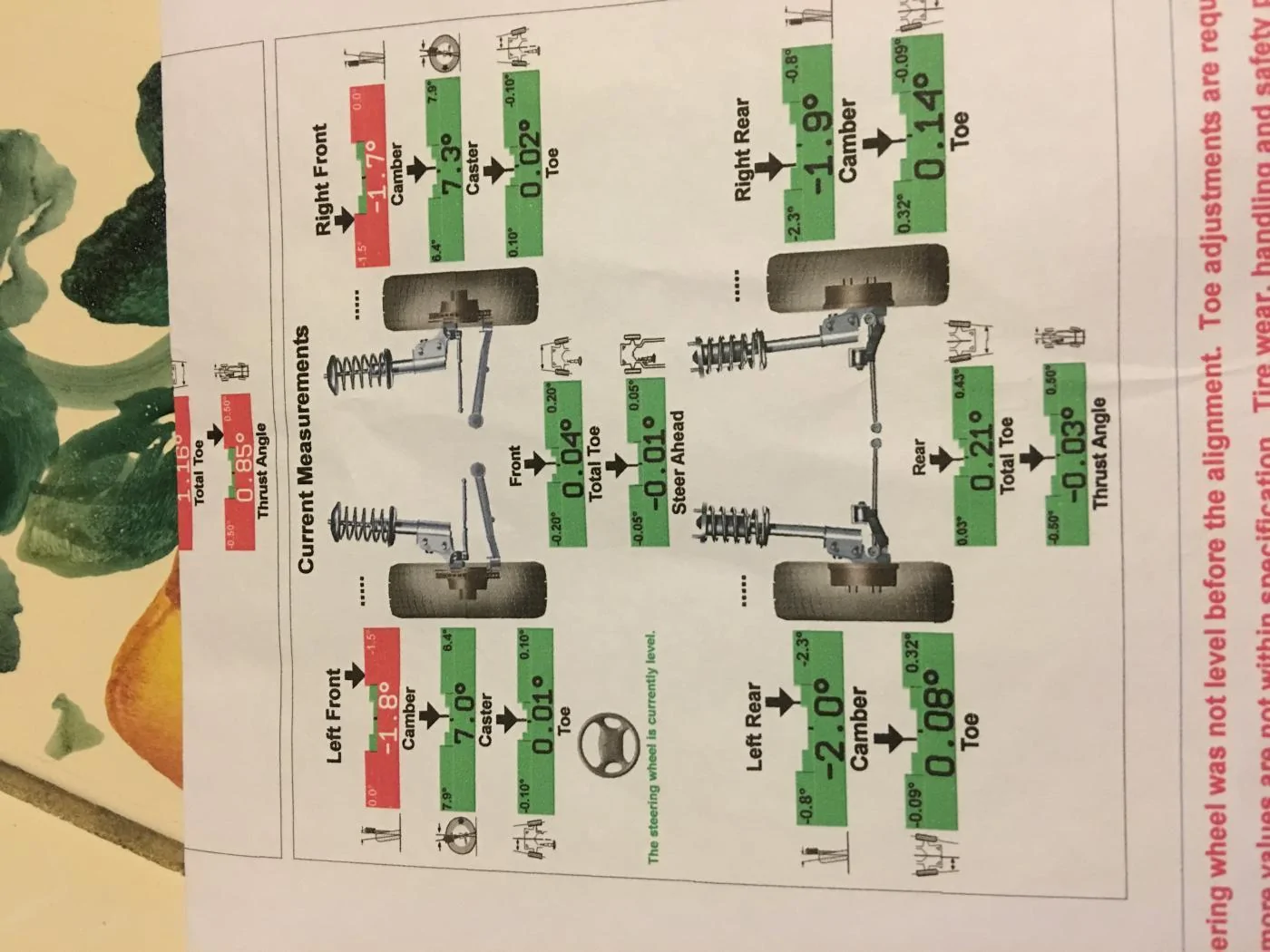

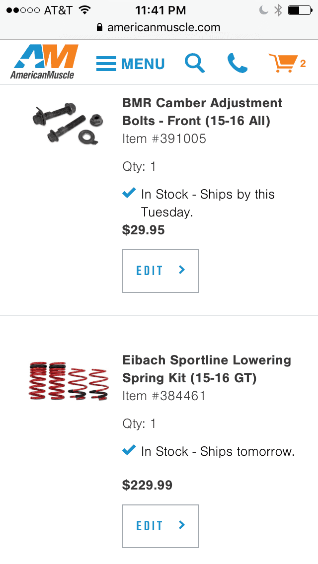

@ David steeda - no offense intended maby I didn't word some of my initial post in the way I meant to - as I have been talking with rod my sales guy steeda pompano - we just did mbrp cat back / steeda cia no tune / and steeda oil air seperator - work done there at the shop is top notch - it's just that rod had said to me over the phone in pricing out lowering the labor is reasonable for all the stuff that needs done - but he also said that they wouldn't lower a car that much without doing all the extra pieces to put the suspension back to 100% alignment spec ( which makes sense as you wouldn't be liable for any --- ) but from what I've been gathering - the camber can be put to 1.6 ish is almost spec but still a tiny bit outside the range - I don't realley think I can justify spending all the extra $ on front plates and rear camber ajust bars if I'm only off by an acceptably small margin.
On the other side of the coin I'm still saving up for stop the hop package - so I might as well consider wating on springs to do all at once and try n save on labor that way
Still un sure on what spring combo will be right for me - I'd like to be low - have stock 19" CS wheels now - and wish to upgrade to 20" stagger later on ( or sooner ) with 9.5 fronts n 275s and 10.5 rear with 305s
So that will also affect how low I should go on spring combo to not "scrub" on the fenders
