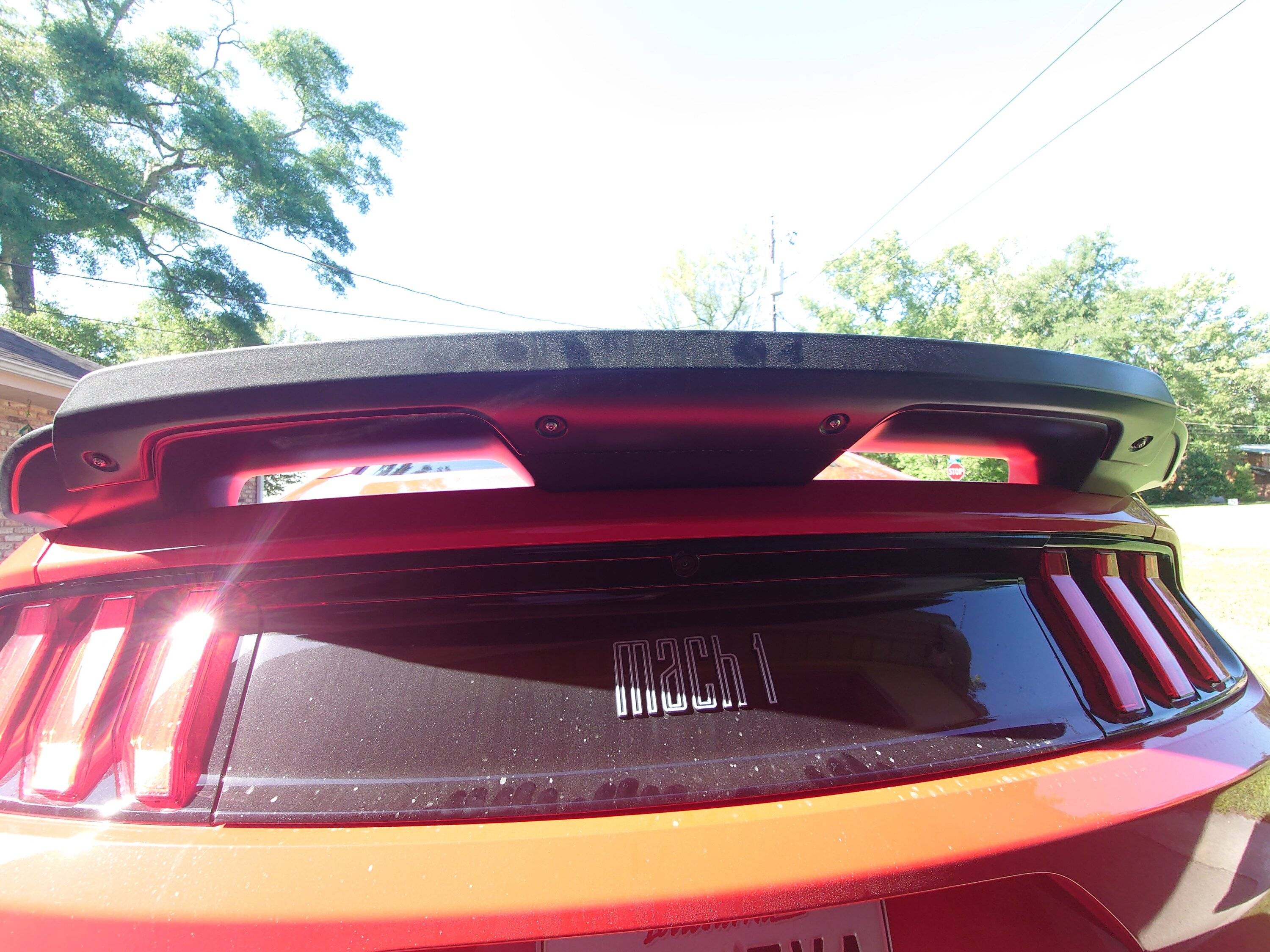

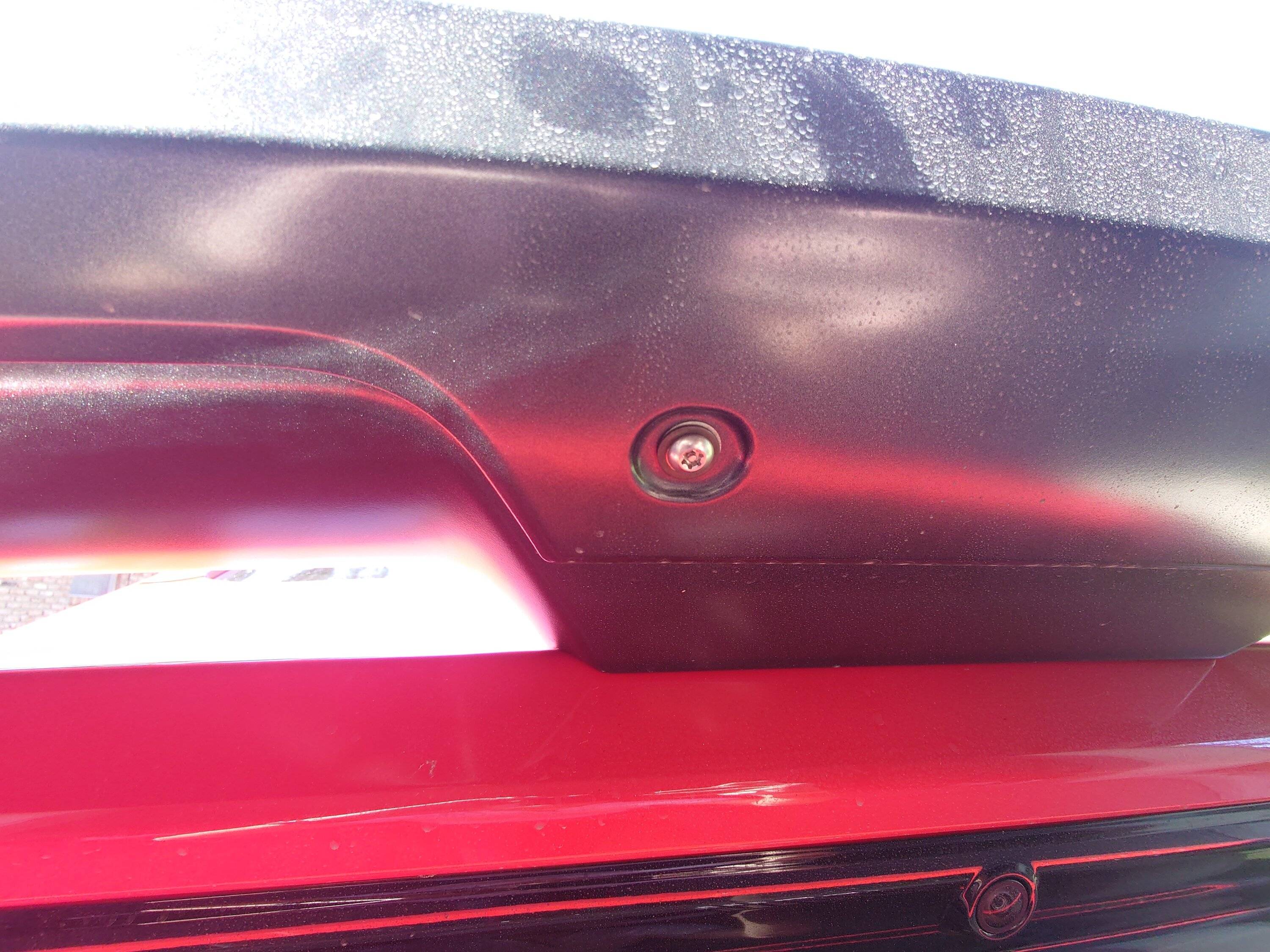

Does anyone know the part number for the longer Gurney flap bolts? I installed the flap today and while attempting to torque one of the bolts to the recommended 5.4nm, the T20 bit slipped and rounded inside the bolt head. I can't tighten it any further, so I'd like to get another one of the bolts so I can replace the one I messed up. I'd rather not have to buy a whole new flap for just a single bolt.

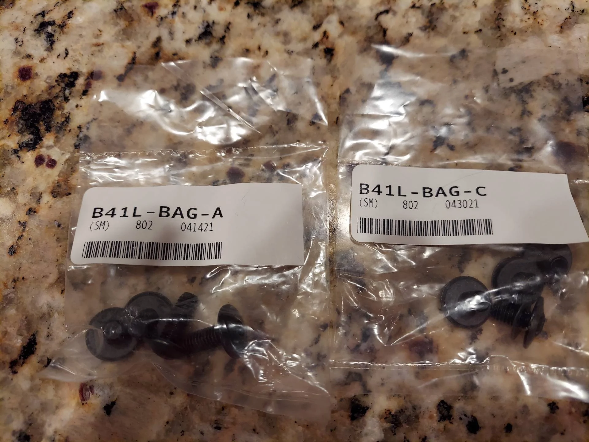

Short (4mm) and long (10mm).
KR3Z-63442K03-A is the PN# for both, to be bought as one item, two bags.

Awesome, thanks! I had the bag, but that number is pretty useless.

This thread has some good information about aftermarket security screws for the Gurney Flap. Aftermarket Gurney Flap Security Screws Link
I went this route for the long screws for the flap (the ones you use when attaching the flap). I used stainless steel T27 Torx screws, black oxide washers, and a very thin fibrous-like washer to keep the washer from marring the flap surface. These are the according part numbers I used from McMaster Carr to make my own screw setup: 91900A862, 90377A127, and 90089A325.
If you need a T27 driver or bit for torquing the new screws down, McMaster Carr sells those as well.
They're a lot more stout than the stock screws and take the torque much better than the stock screws.

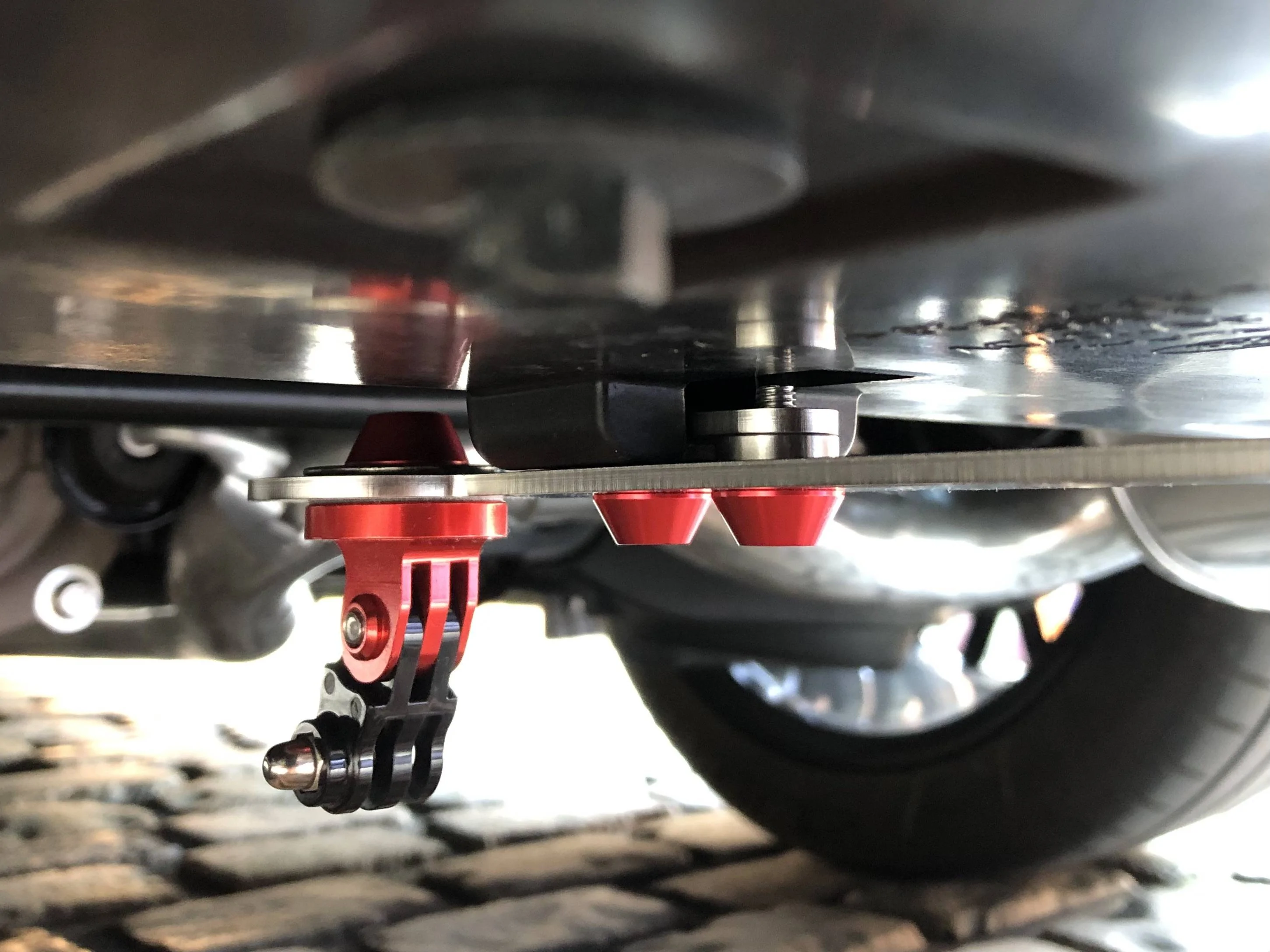

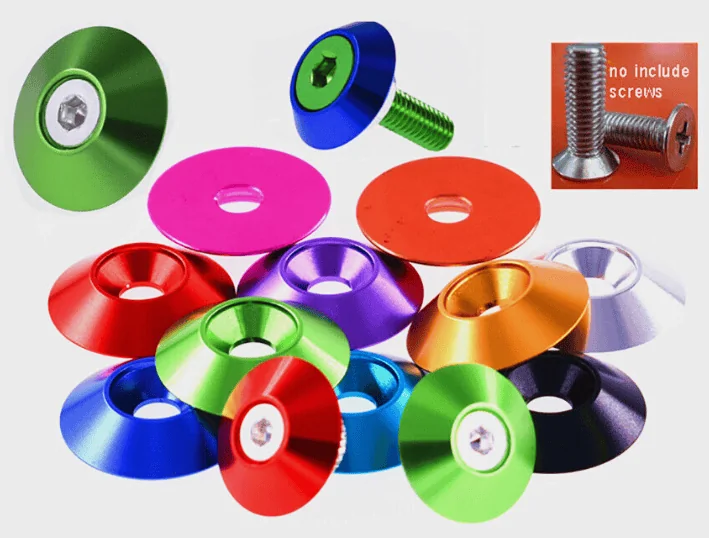

Just an option for future and if :
A) Security screws aren't required.
B) You are not totally set on having OE bolts.
I would be tempted to use stainless cap heads (cheap) and ally cup washers, either in black or body (or pinstripe) colour matched :
Photo as an example only - you can get them in various diameters (for the same bolt size) and to suit CSK or cap head bolts etc.
I think orange on a FJG car or red on the white cars with a red pinstripe, would look really cool :sunglasses:
For some extra bling / bragging rights, you could swap the bolts out for titanium and still come in at under half price of the OE Ford bolts ... :shock: :like:

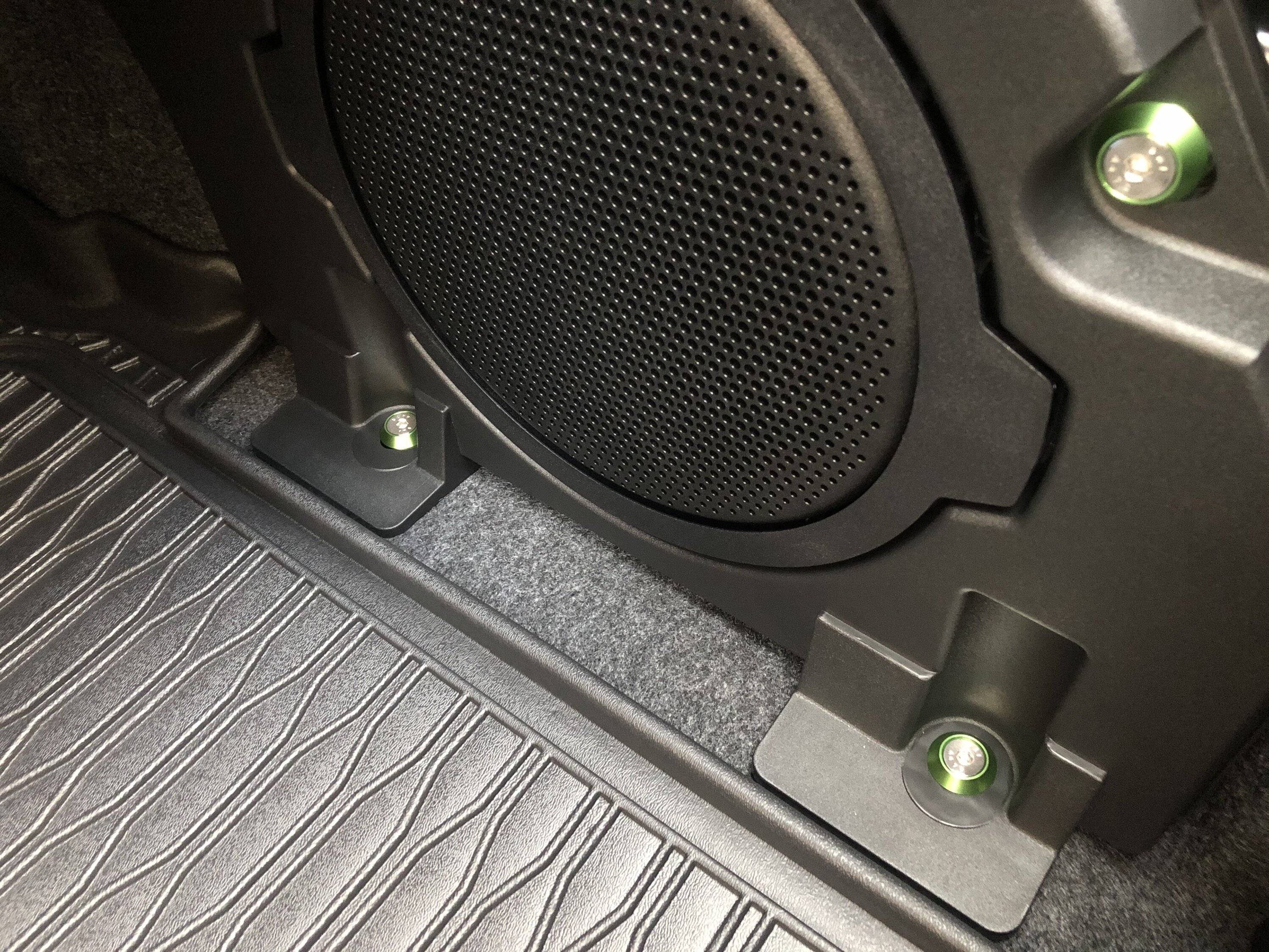

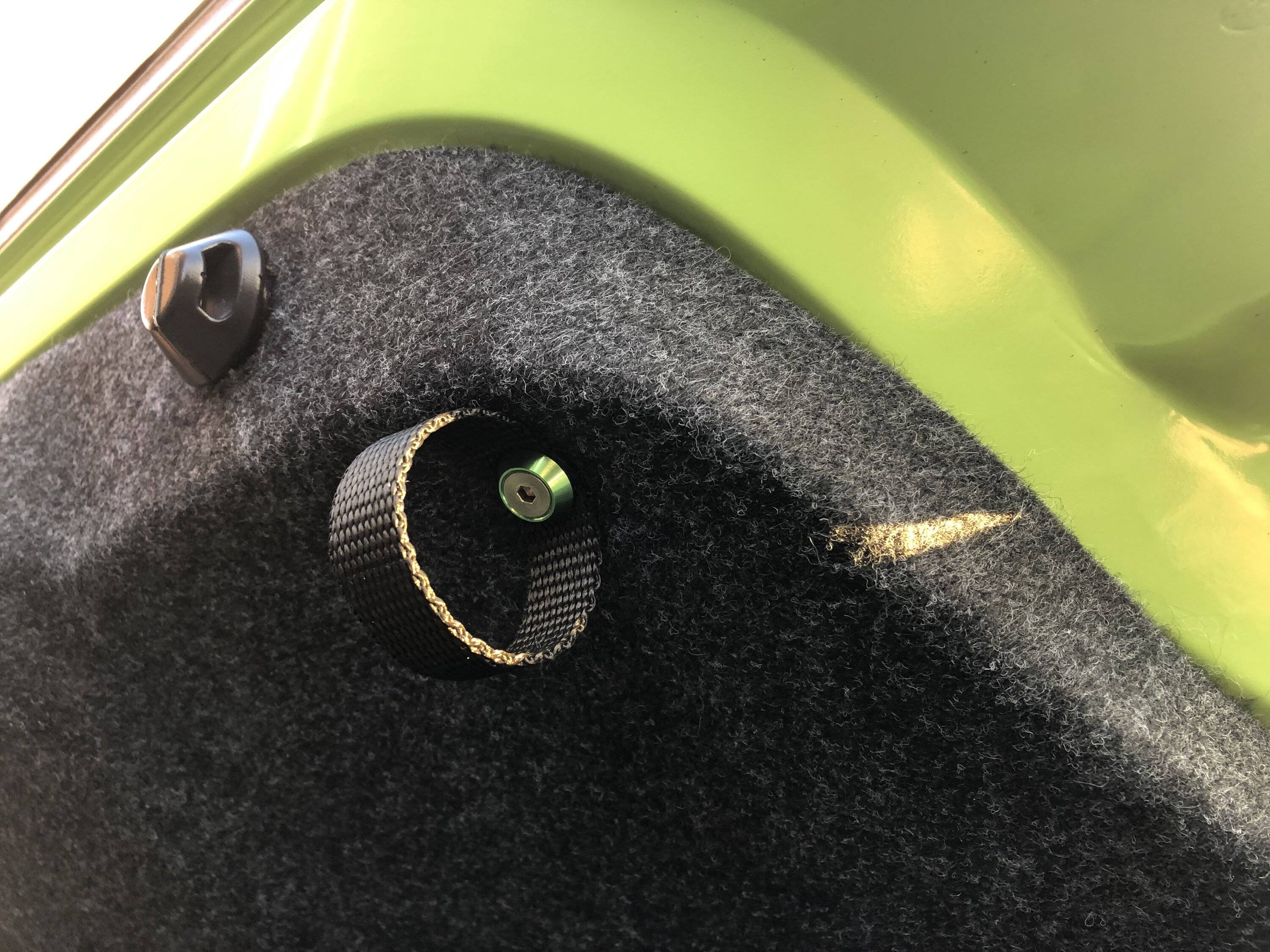

Going off topic, but I've got them in a few places around and under the car :
WD :like:
