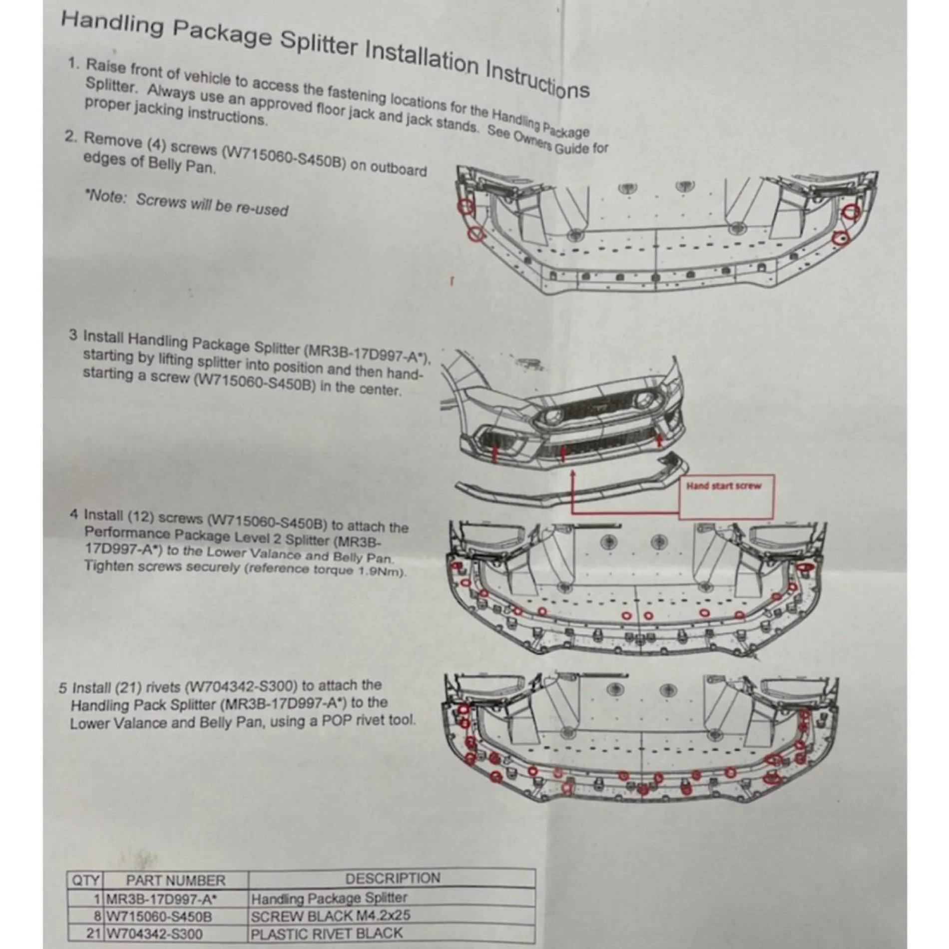

So my front splitter is missing all of the rivets because I asked them to remove it for shipping it. I had no idea they were one time use. I guess I need to buy 21 more rivets and I need a rivet gun?
So far just the bolts are holding it.
There are 4 more bolts (8 total, 4 stay without splitter) and 21 rivets.
I ordered these rivets - https://www.fastener.zone/products/auveco-13751-1274-ford-w704342-s300 We'll see if they are correct. Rivet gun - need a bigger one, as I think I read these are 1/4" shank. Harbor Freight sells one that goes that big. 4 bolts -I ordered these based on the Ford part # - https://www.amazon.com/gp/product/B085MY7J6B/ref=ppx_yo_dt_b_asin_title_o01_s00?ie=UTF8&psc=1

FYI guys, I don't think the instructions match up perfectly. I only had 10 screws on mine. I worked on my splitter this morning and only found two black screws in the belly pan part of the original splitter. There's only 10 screw holes total. I checked both sides thoroughly. There's not another place for two additional screws. Even with 10 installed, this splitter is going no where even without the rivets. I still plan an putting the rivets in.
