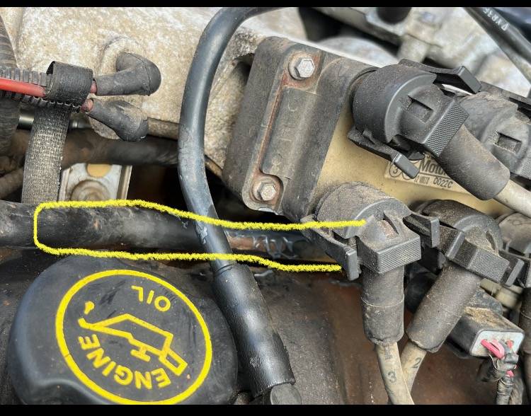

I’m new to mustangs and recently was given a later model base with a v6.
My plan is to swap to an 8 cylinder engine but I’ll be driving it for a few months first. Anyway there is a metal hose with a crack spewing coolant (in the yellow highlight area). Looks like a repair was attempted with JB Weld or something.
What is this part and how simple is it to swap with a good one?

I’ve looked on the internet for weeks but don’t see this part in a blow up diagram anywhere

Wild guesses here...
Heater pipe going through firewall? If it's cracked.. you can bypass heater entirely unless you live in the great white north.
Is this towards the back of the engine?

I'll 2nd the notion that it's a heater hose. Total guess, though.
JB weld isn't your friend here.

I believe that is a coolant line for your heater. It looks like it runs under the intake on the driver side then around the back of the motor towards the passenger side.
I found this ebay listing that should be it.
For 1999-2000 Ford Mustang HVAC Heater Pipe Motorcraft 71652HP 3.8L V6 | eBay
