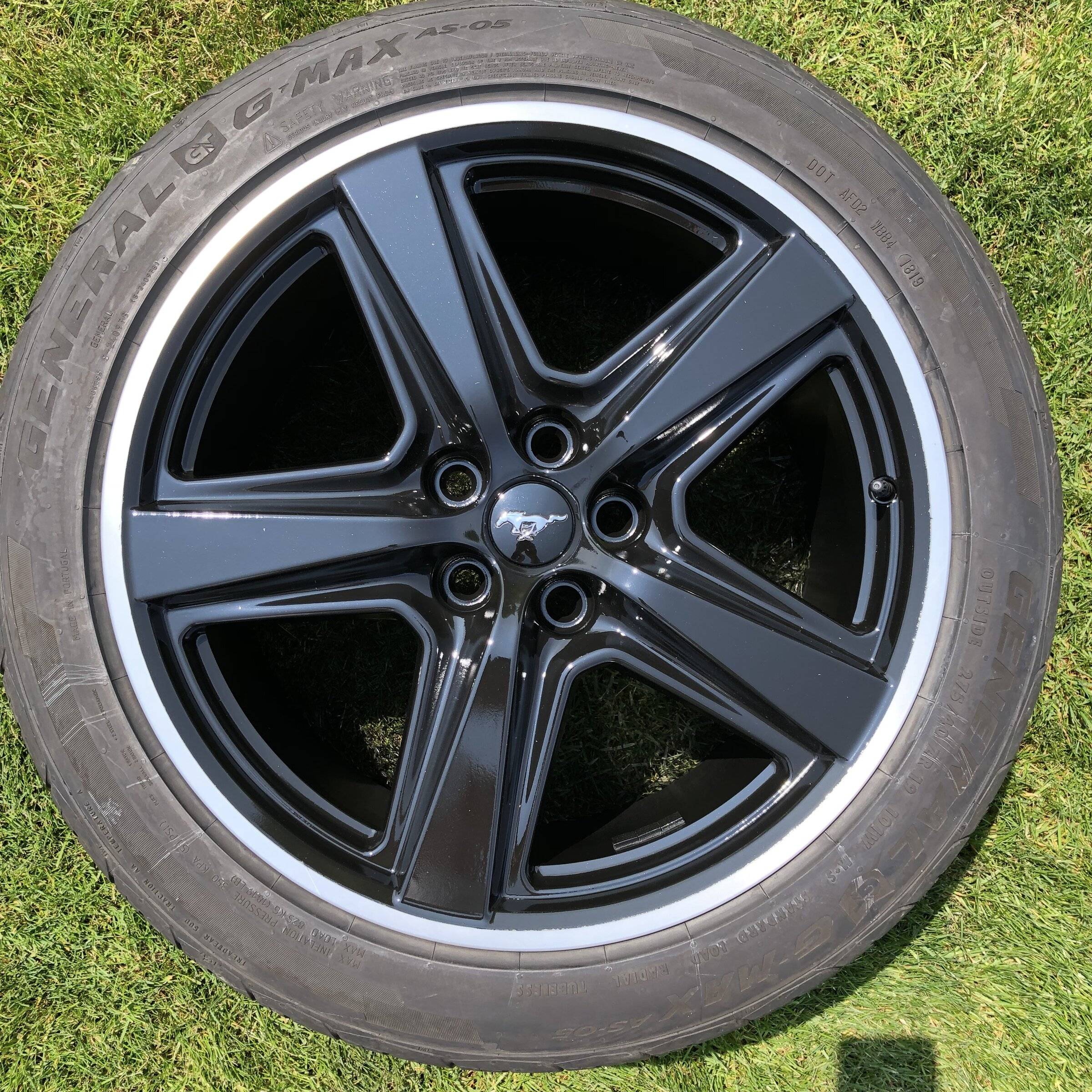

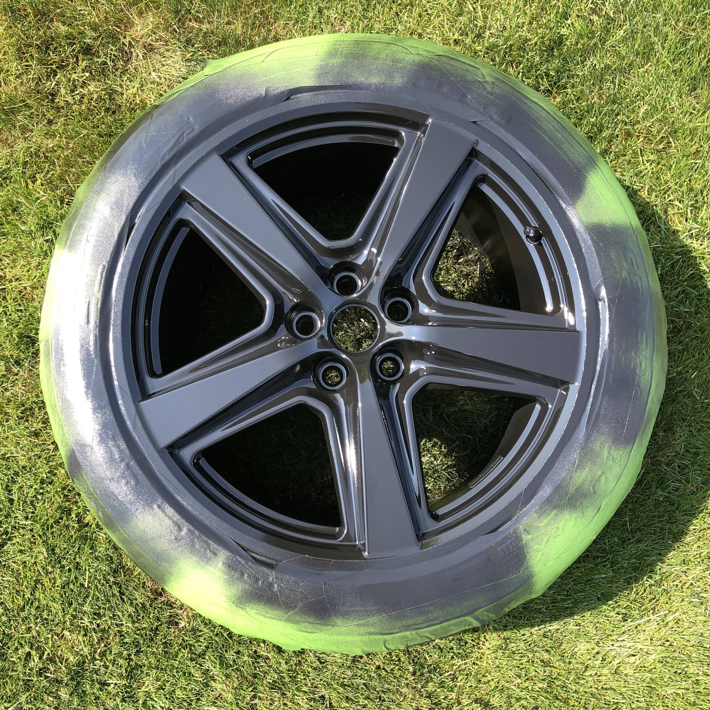

I have a set of base 5-spoke wheels that I use for winter with all-seasons but didn't like the dark gray finish against my silver car so I painted them gloss black and am really happy with the results.
First, obviously, clean the wheels with wheel cleaner and let them totally dry.

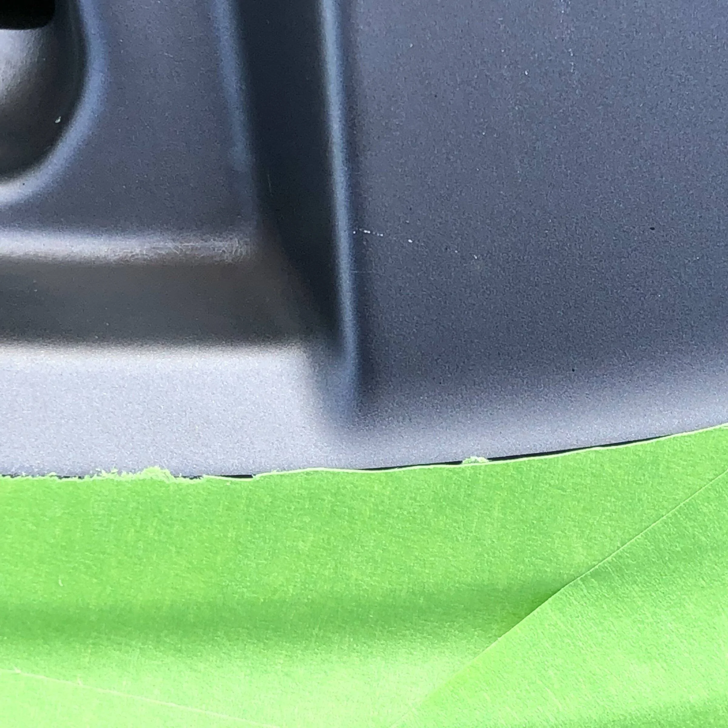

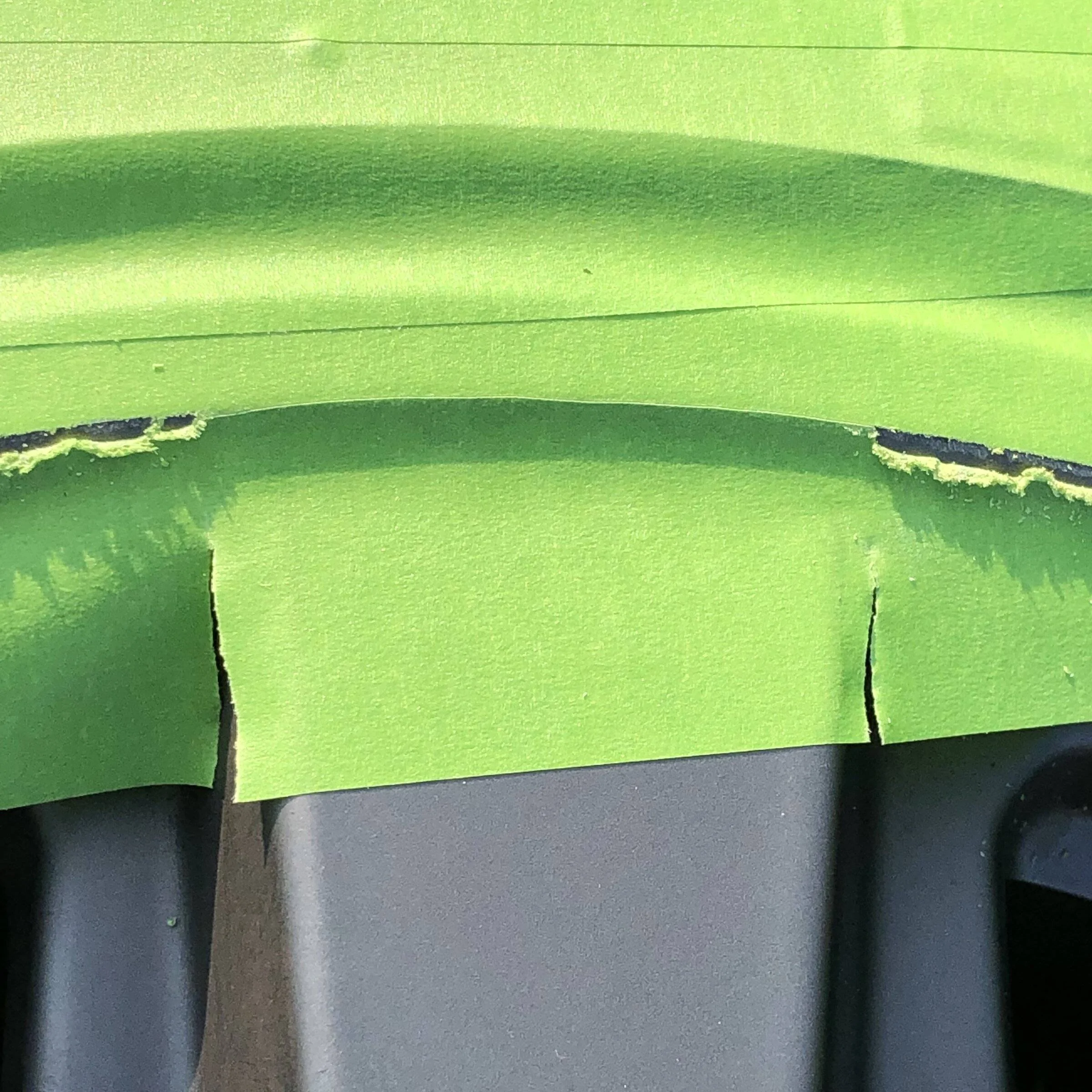

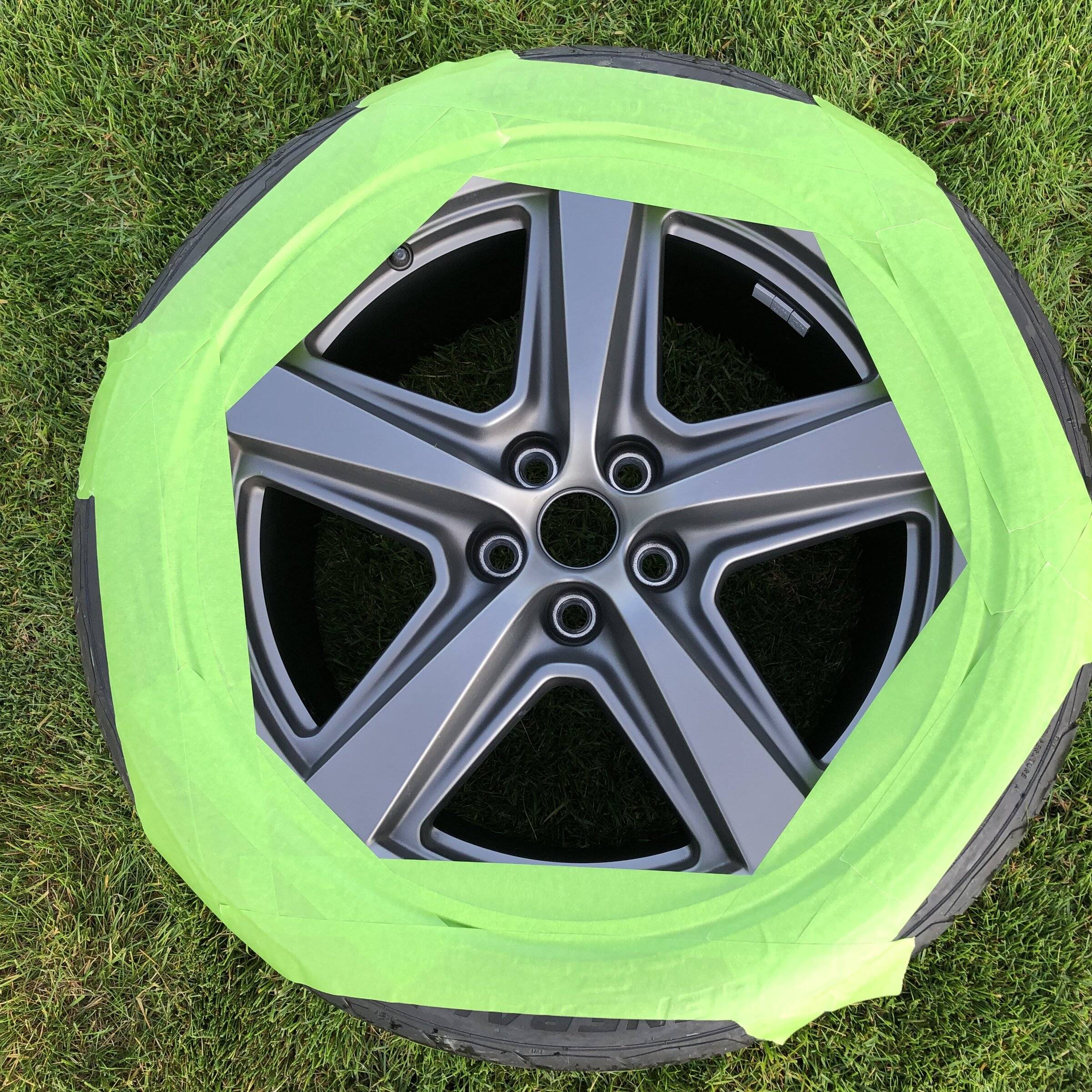

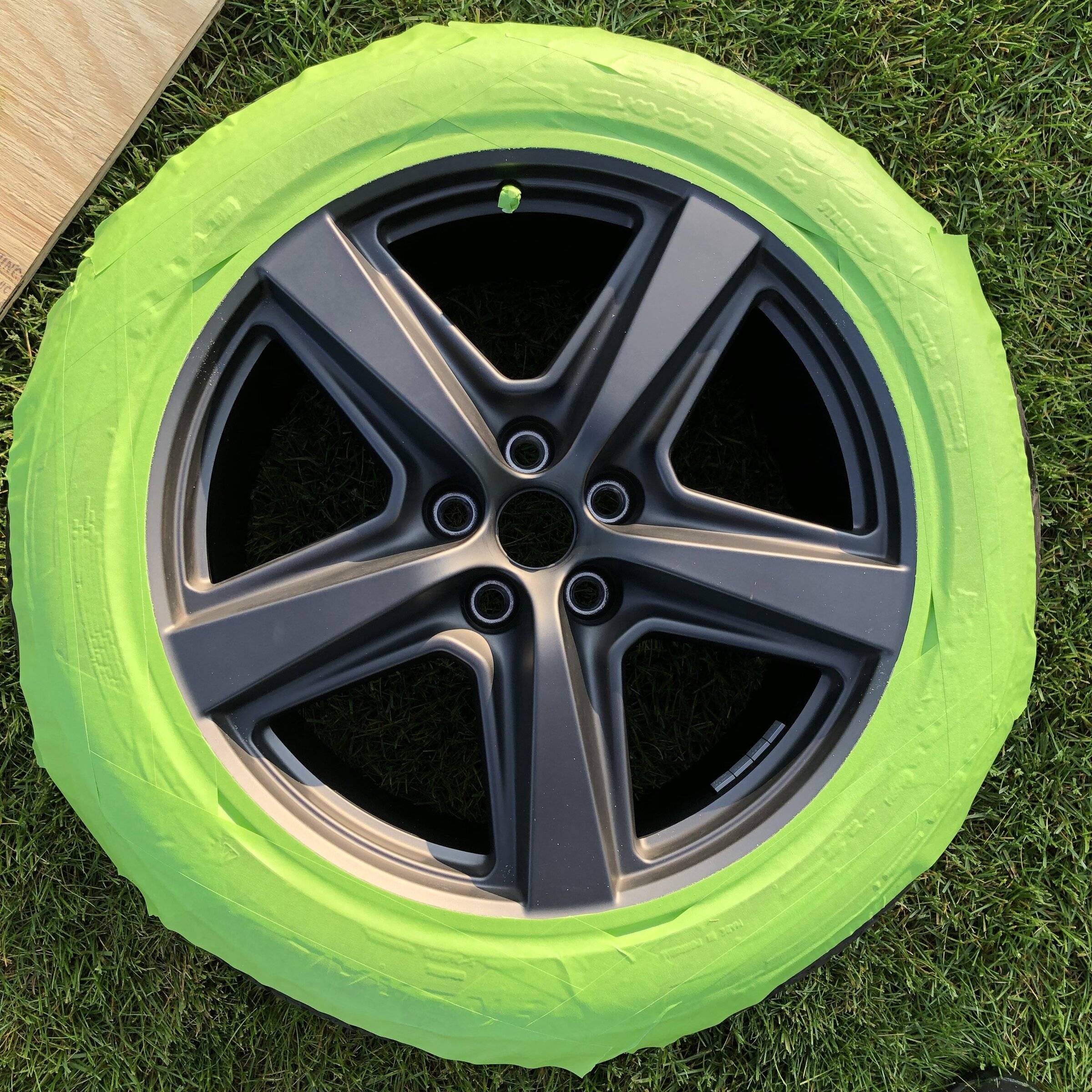

The trick is how to keep paint off the machined lip. I used green painter's tape, a fine cut half-round file, and a hobby knife to mask off the lip. Start at the valve stem and cover the lip and tire with tape, it took 6 pieces to get around the edge. Keeping a tape V at the stem makes it easier to trim. Then use 2 more layers of tape to cover the tire. (Took this pic before adding the outer layer of tape, and didn't have a tape V at the stem.)
Now using the round side of the file, gently "rub" the tape away along the lip, pushing only inwards towards the center of the wheel. It's hard because there's not a lot of slope at the lip. Use the knife to make a cut along the side of each spoke so the tape can fold inwards with the pressure of the file. There's not enough room to do this at each spoke so you have to use the hobby knife to very carefully freehand the cut along the edge of the lip. It's really hard because the knife keeps wanting to fall off the edge so go slow. Then tape off the valve stem. Took about 90 minutes to mask them off.
The filing will create tape dust so I used a detailing brush to brush it away, then wiped the surfaces with CarPro Eraser surface prep. You can probably just use isopropyl alcohol too. One coat of primer and two coats of plain old Dupli-Color gloss black wheel paint. Perfect day today for painting, mid-60's with low humidity and hardly any breeze, then sun to dry quickly.
I'm pretty thrilled with the results, the lip edge was a lot cleaner than I expected. Now I won't be dreading taking off the summer wheels quite as much!

For lower effort and superior outcome just to take them to anodizing shop who will dip strip them and anodize for $40 wheel or so.
Next time use auto body grade mask tape with fresh blade, or even better fine line tape with fresh blade for ultra clean demasking lines.
The color looks good.
Any other areas I could have done better at?! 😂
They came out perfectly fine.

Maybe it is me being colorblind, but I think the "Magnetic" rims are black matte. Under different light direction they change to greyish... Gloss however works quite well. Good job. I was thinking on putting an orange stripe to match the sides and played around with photoshop, but kind of I don't like it.

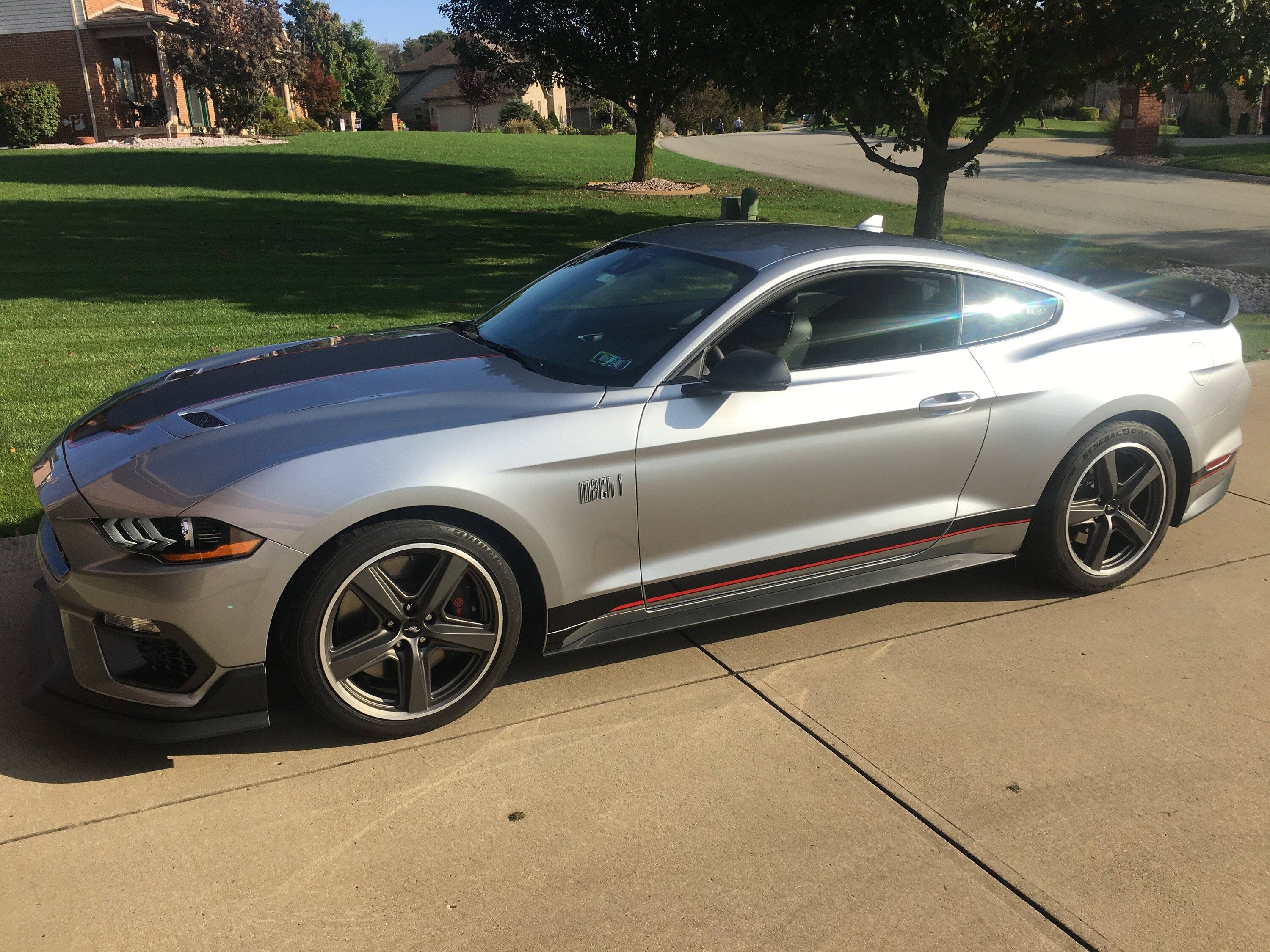

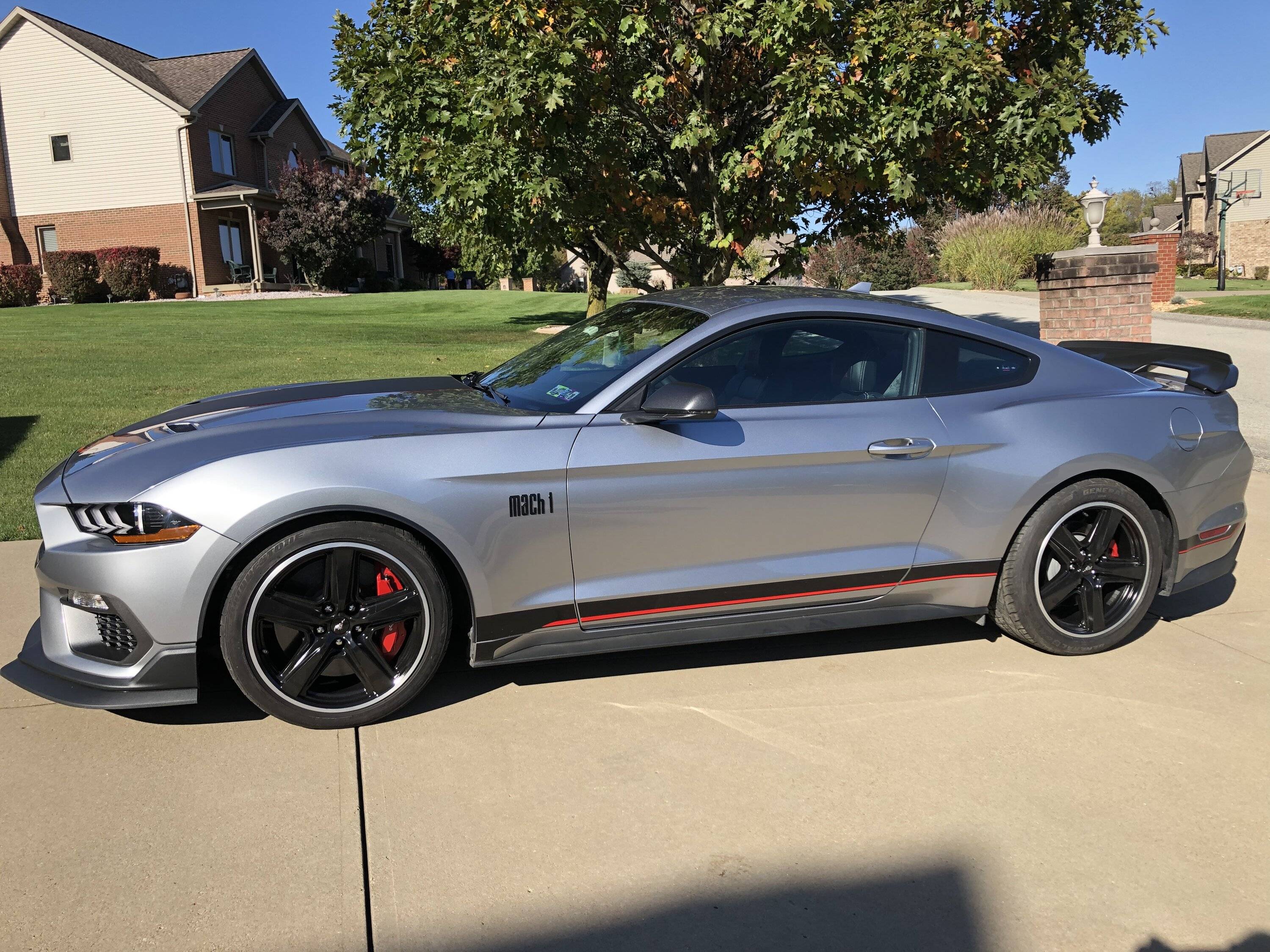

OK installed the black painted base wheels with all-seasons for winter for the first time since painting them, very happy with the look compared to the stock gunmetal. Here’s a before and after pic.
Also: Holy reduced traction compared to the HP-size PS4S’s!

Nice job. Picks up the black in the stripes 👍
Edit: along with the red callipers picking up the red in the stripes.

Now your mirrors and spoilers don’t match……. Can I guess what’s next?
I think the five spokes look pretty nice in their own way.
Gonna stash a front and rear one in case I ever need it. Glad to see you’re having fun!
