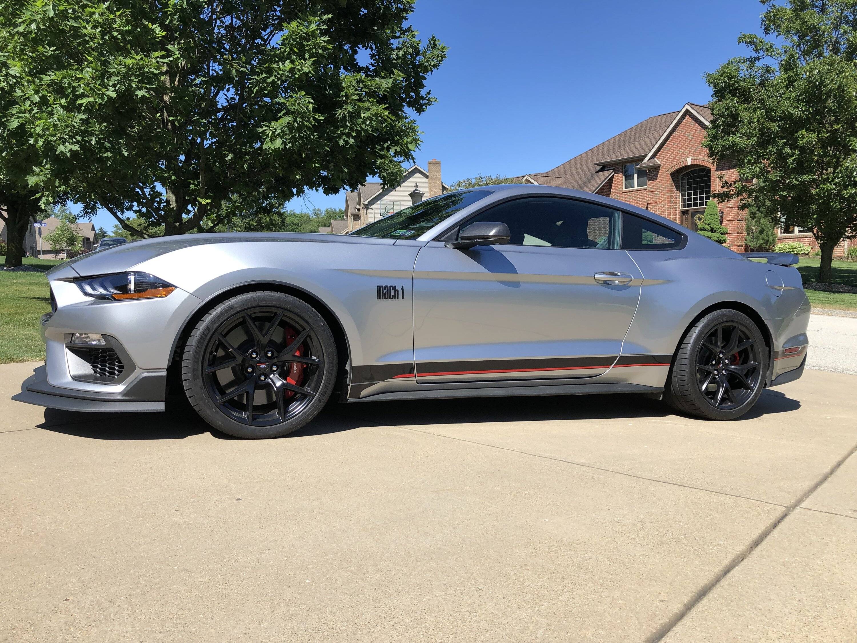

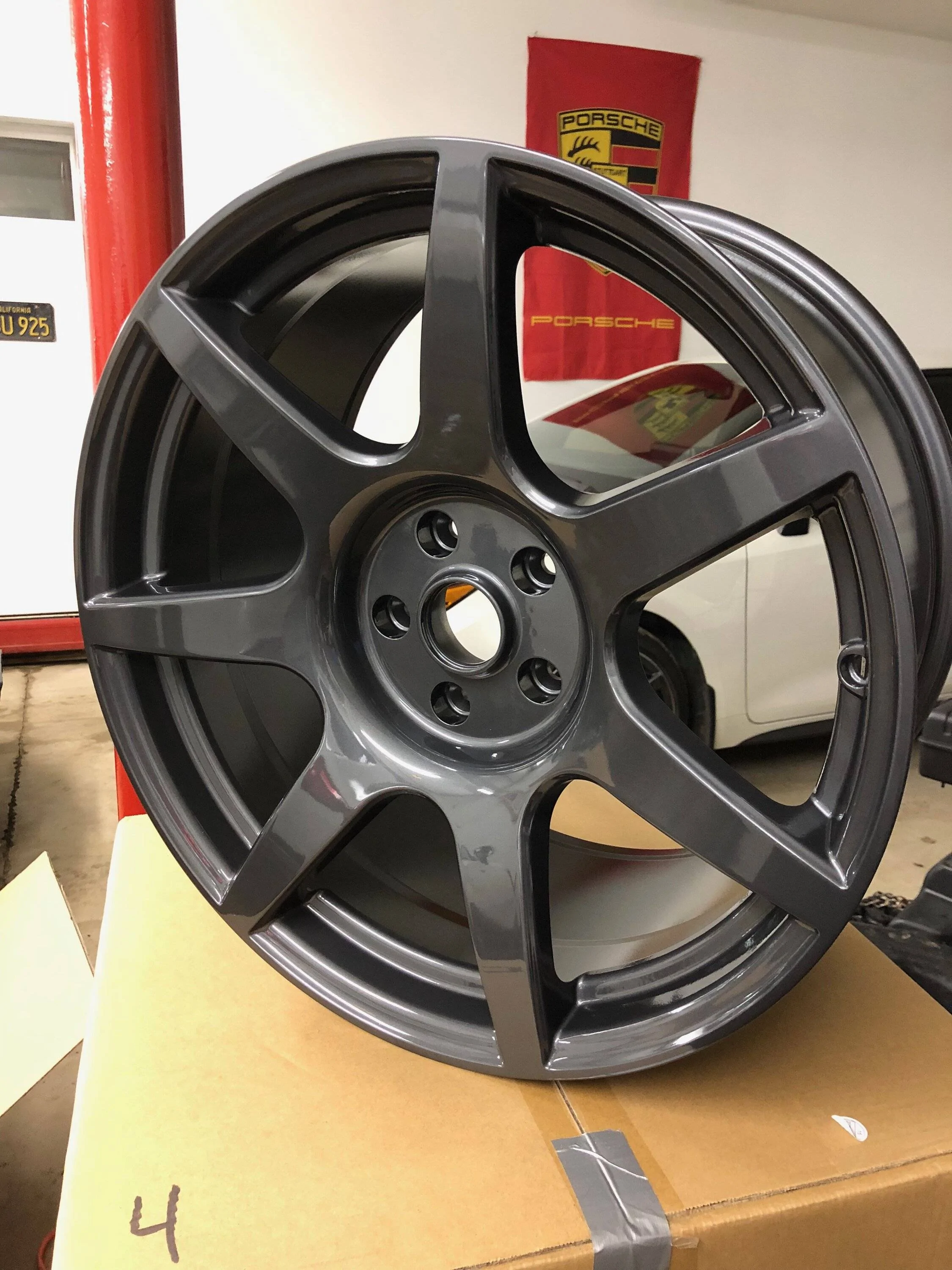

Replace 5 spoke wheels
kendroz
Mar 25, 2022
PR
Kenneth
match 1
Thinking of doing that to have a more grippier tire. With 10 and 11 inch i can go 305 and 315 on 19. Ford Performance, steeda?

I like my SVE HP1 wheels, they have the same look as the factory HP wheels but the front is 10" instead of 10.5" and they weigh 13 pounds less each. I run the factory HP sizes on them 305 and 315

Ford Performance PP2 style, 10.5 / 11, 305 / 315

For 305, you want an 11" wheel. For 315, ideally you're on a 11.5" wheel or wider (but 11" isn't too bad).
305 on a 10" isn't great. Its pinched noticeably.
