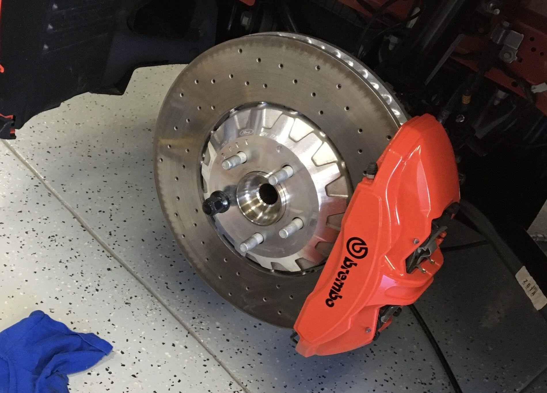

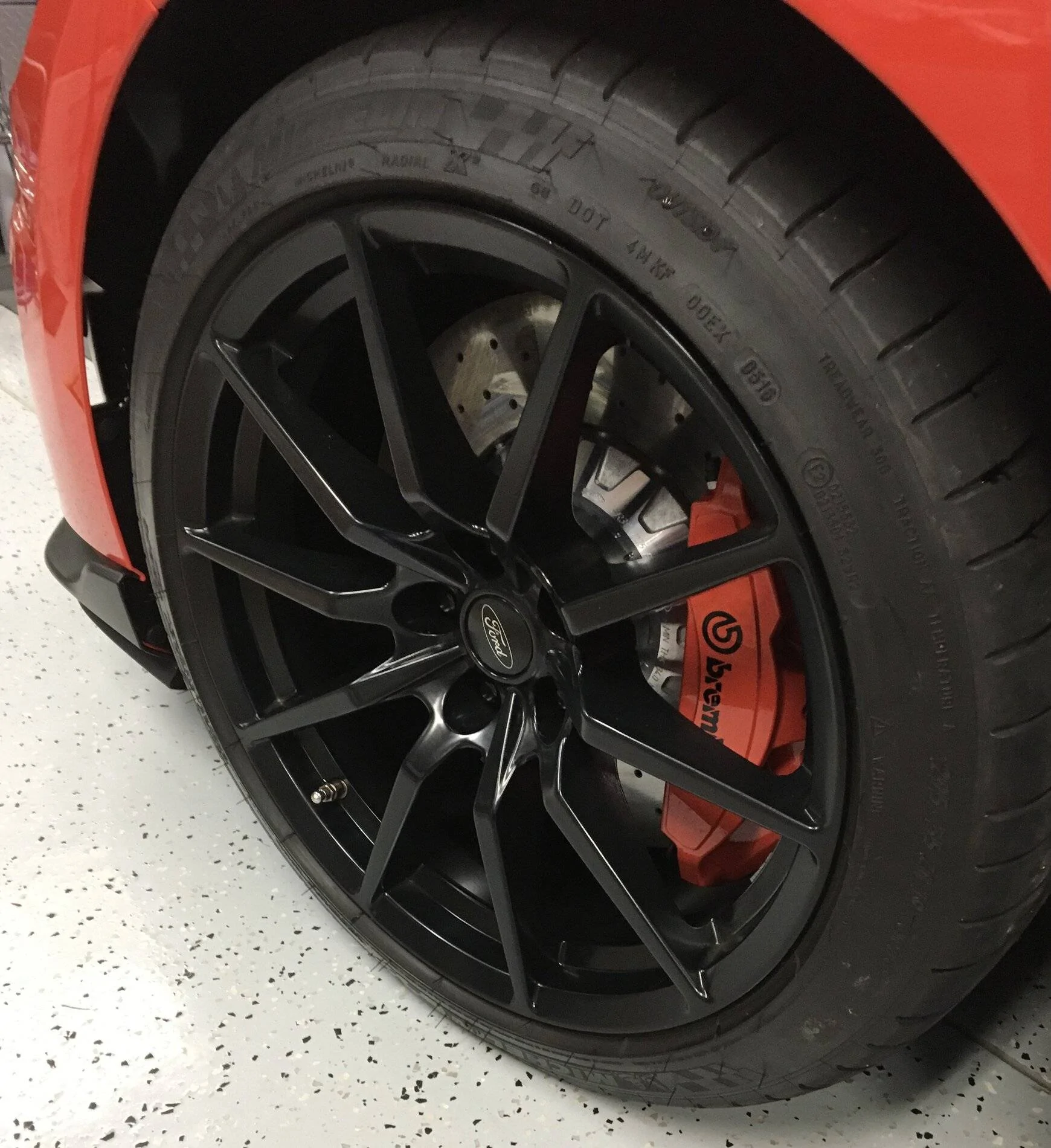

I bought a second set and had them painted an exact match from the Comp Orange paint code...I had reverse "Brembo" images made and overlayed in gloss black...followed by clear coat...its been a few years now and they look like day one. For me it completed the look of the car and brightened up the wheel hub area. I've vac-packed the OEM calipers and I know that I can always go back at the cost of some washers and brake fluid.

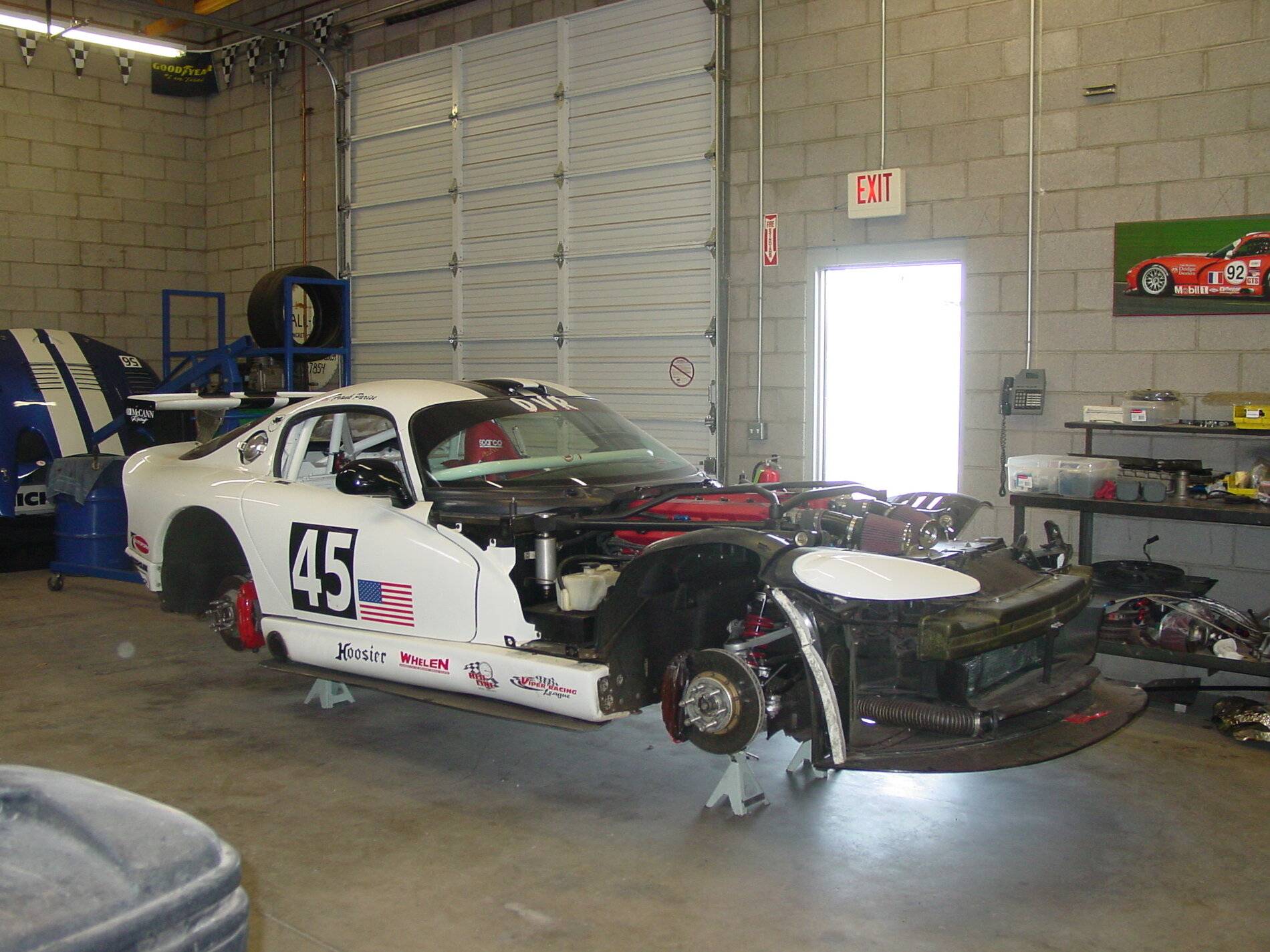

Check out discoloration on front brake caliper on my old 96 Viper GTS racecar. Rear caliper maintained its color because of much less heat. Should not be problem in a street car.
