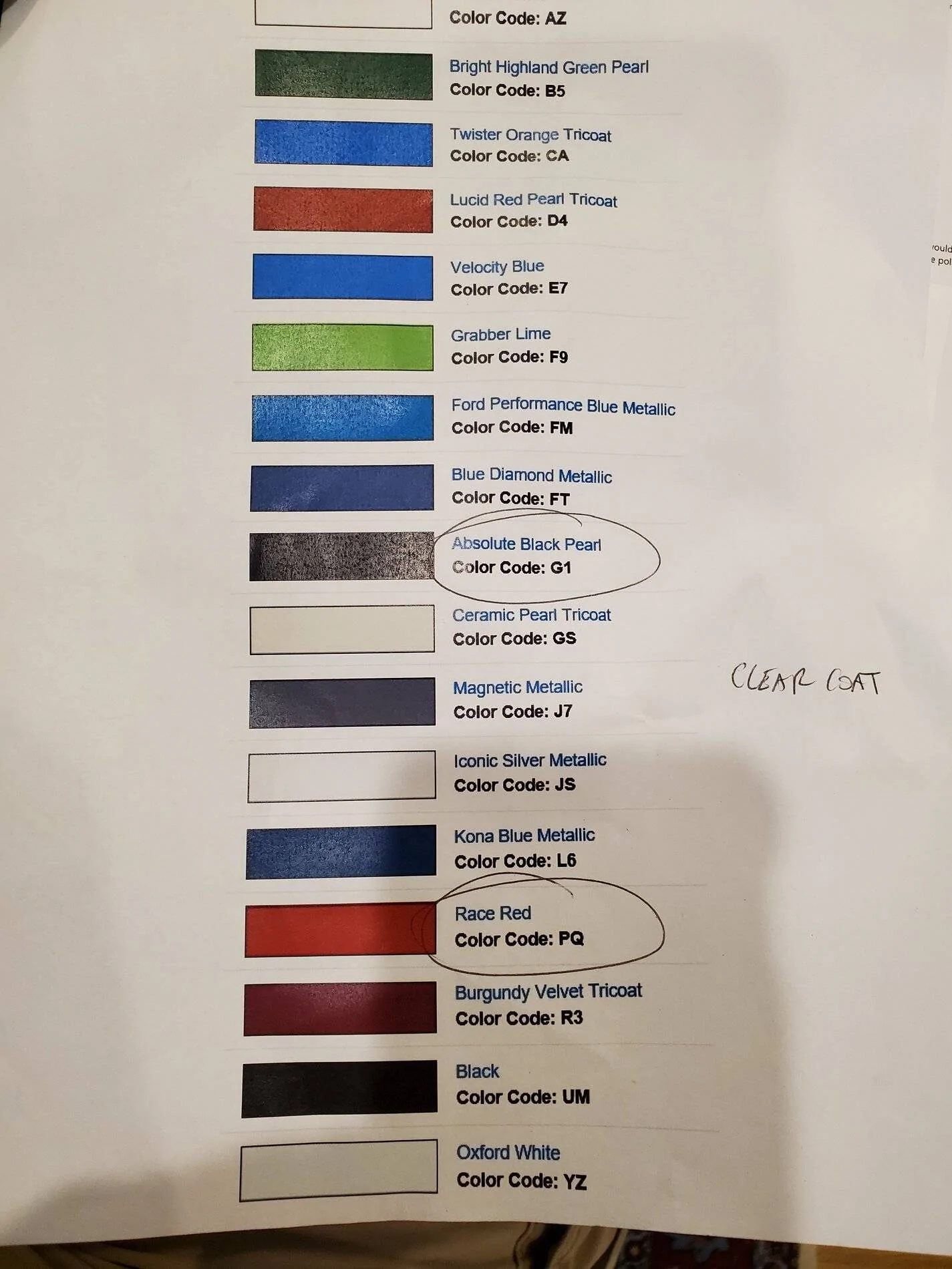

I have a Shadow Black 18 R. Shadow Black paint code has the blue metallic flake. It's true the wing also has blue metallic flake in it as well. The whole car minus the CF wheels has the blue flake. My CF wheels are a different black. The easiest way to see the blue metallic flake (for me) is the car must be in the bright sun or you can get up close with a flashlight on it. The blue specs sparkle. Maybe the "absolute black" is the CF wheel color.
I have come to find shadow black and absolute black are the same thing. Just like lucid red, rapid red, and red hot metalic.
I had some paint mixed and the paint code was the same for absolute black and shadow black.
The CF wheels don't have any blue flake.
I hope this helps
