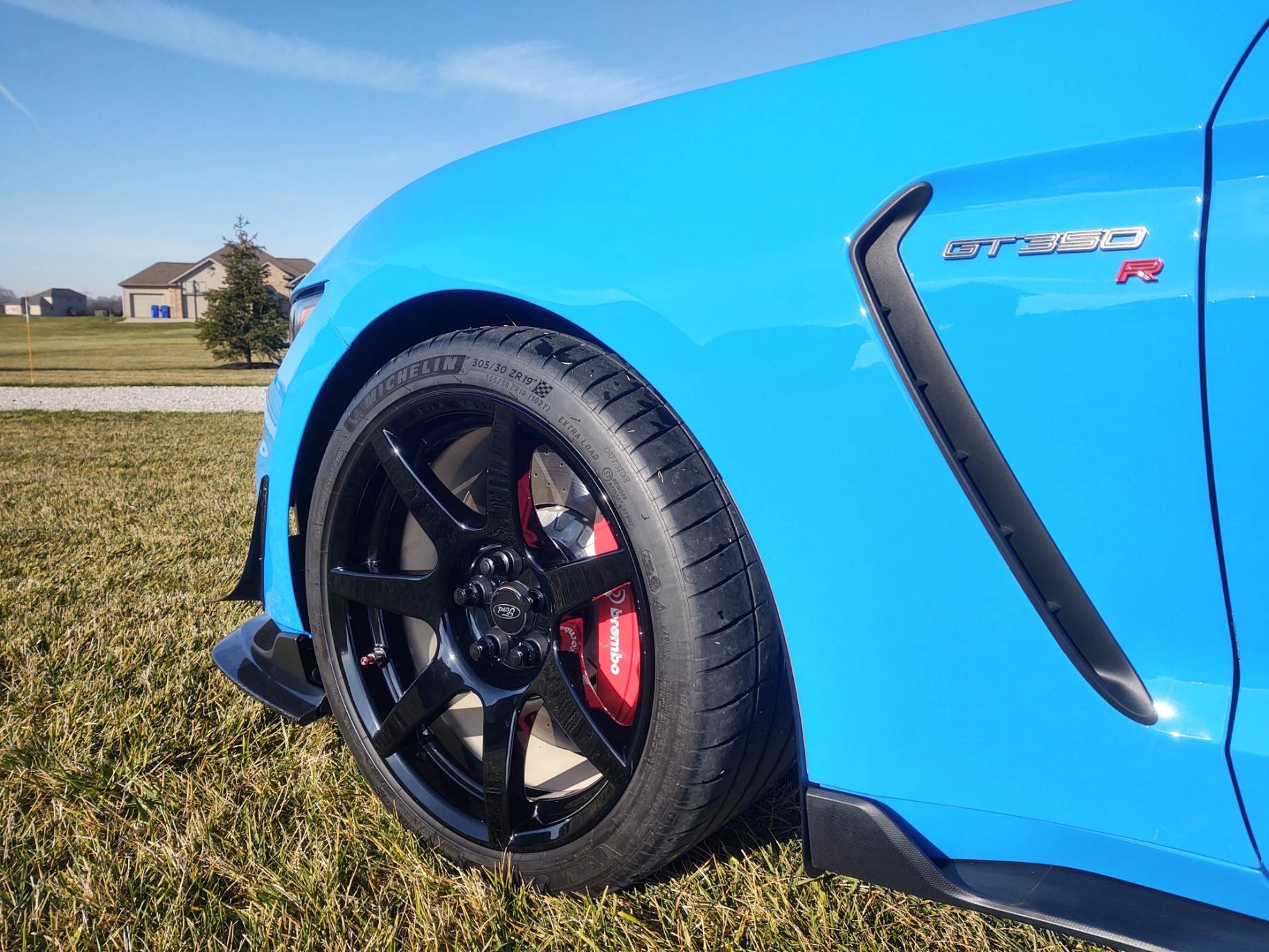

Alright....who has touched up their Carbon Revolution GT350R wheels? I keep getting conflicting topics where people recommend Ebony Blk or Shadow Blk Ford paint pens?
Has anyone actually used either, if so which one is closest?
I'm wanting to purchase a paint pen from Ford but I'm just trying to dial in the closest color. Is it crucial I get the exact paint match, definitely not but closer the better.
I have reached out to Carbon Revolution, waiting on a response currently.
Any help you guys could provide would greatly be appreciated.

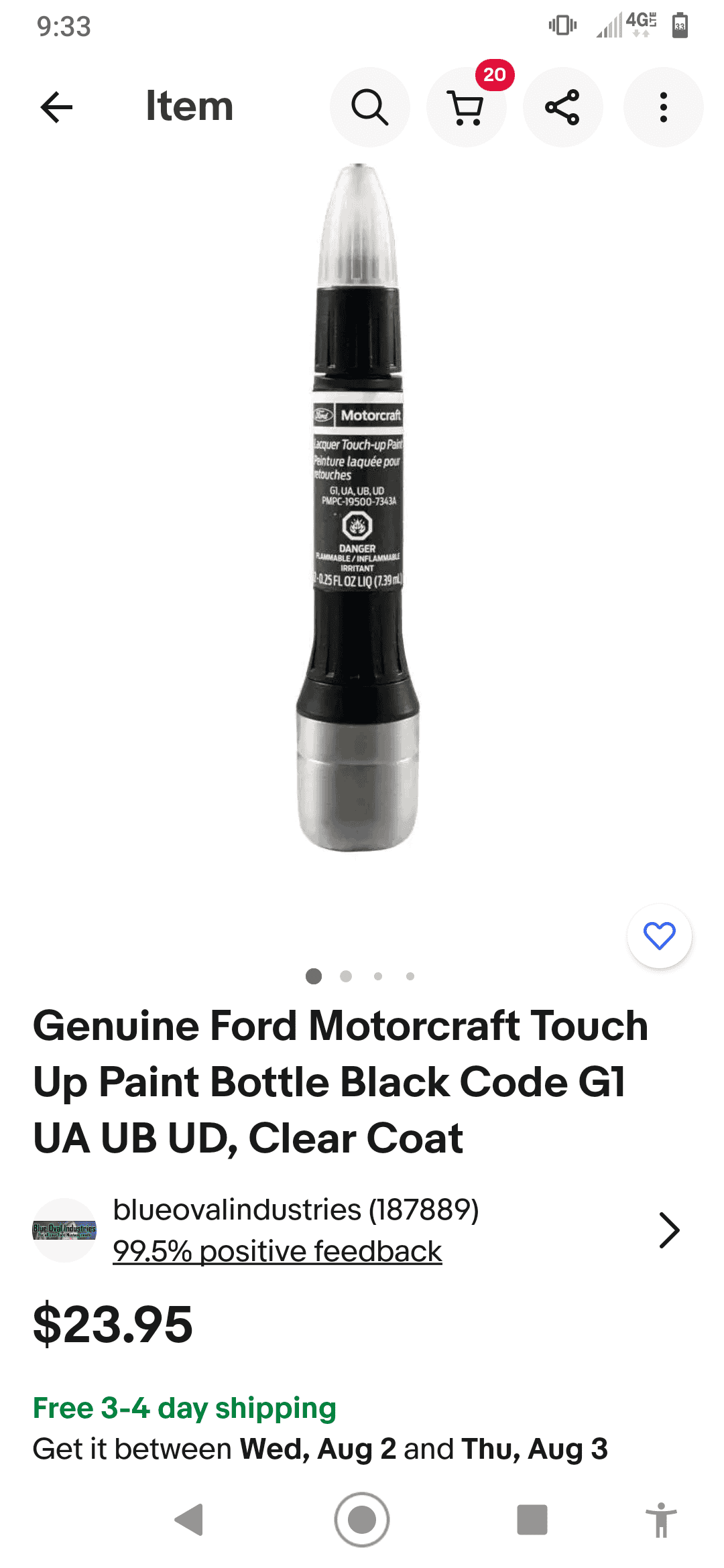

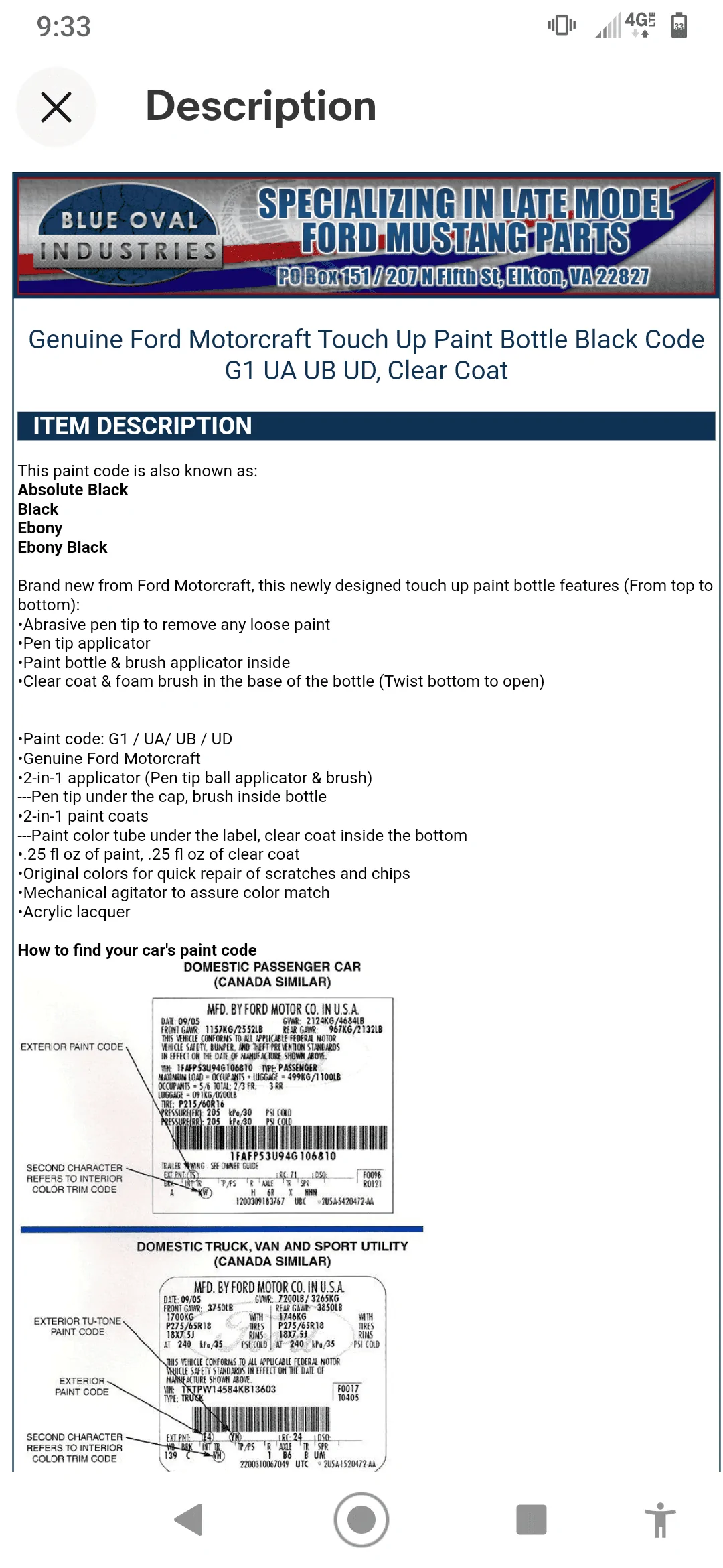

Copy and here is 1 more to help the next guy confirm, especially since I have confirmed directly from a Carbon Revolution rep. Sharing a picture of the Ford Motorcraft Ebony paint code(s) pen used and location to purchase.

You are correct about the actual color Ford used. It does have the blue flakes (roof if black optioned and rear spoiler on the R). But AFAIK there is not touch up paint from Ford for that. The color code for shadow black is G1 and ebony black is UA. That Ford paint touch up stick (PMPC-19500-7343A) covers both. You might be able to get something specific from someone else outside of Ford.
