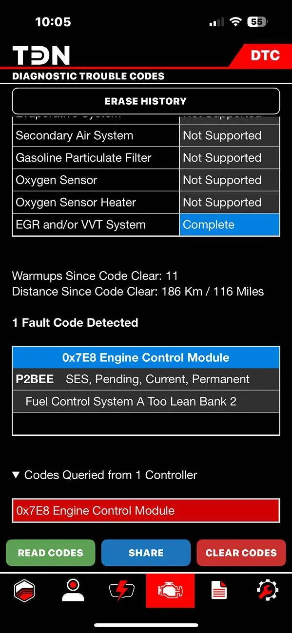

Hey guys I got a check engine light the other day and scanned my Mustang and got a P2BEE code. Does anyone know what it means? I’ve done research and it’s could possibly be bad o2 sensors, vacuum leaks, dirt/bad injectors, exhaust leaks at or before the upstream o2 sensor. Does anyone have any recommendations on how to diagnose this?

I was going to make a diy smoke tester and check for some leaks. I scanned for codes and that’s the only code I got, it’s very vague. What kind of scan tool for the o2s?
