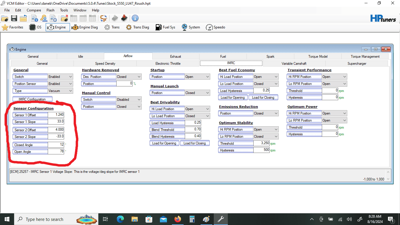

The voltage and slope changed for the gen 3. Your tuner needs to change these settings in the tune from this

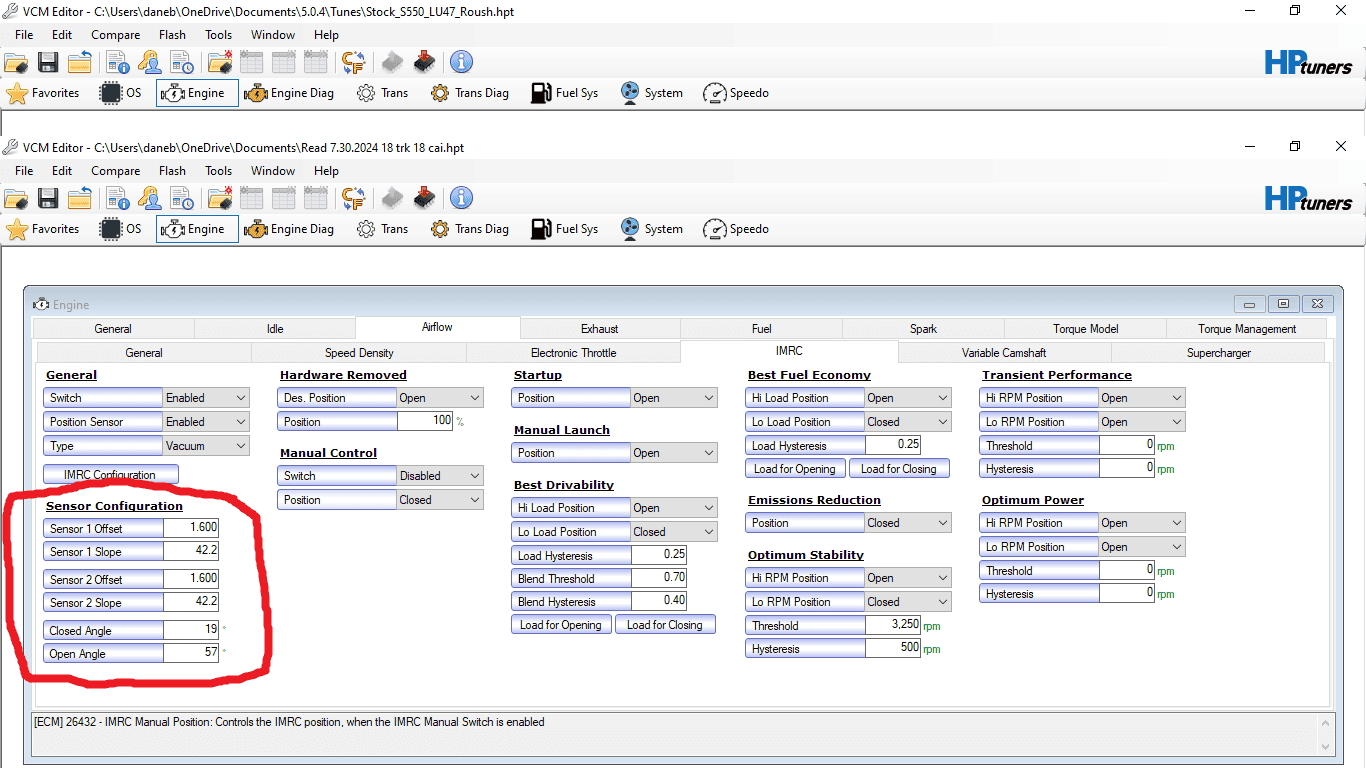

To this, sorry for the double post above

I'll for sure show this to my tuner, thank you.
Do you think that by adjusting those values (apart for removing the error) the engin will respond smootly as before?
Depends on the tune. The values I gave will make the computer happy. But you could have a mechanical problem if your tuner already changed these settings.
Let us know.

I would like to thank K4fxd very much, thanks to your help I was able to solve the problem immediately.
Now I no longer have the check engine light on, no more misfire and the power delivery is back to normal.
