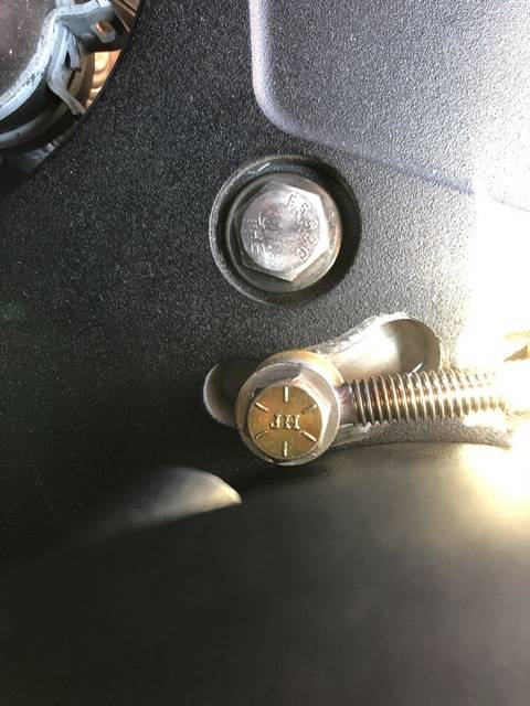

My 660 on 4.25 has good wrap now may just stick with it. Thoughts on attached photo at proper tension

That's fine, I've ran it deeper with no issues
Id say that's looks good. Im near max with that belt and a 4.13
