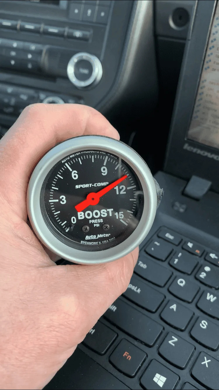

Got a chance to do some hits to shake the car down. Had a 4.5” pulley already and verified that was making 11psi on a relatively dry 60deg day. Still think I’m going to pull the trigger on a 4.25” griptech pulley to get close to 13psi. What are the thoughts on just running a regular Gates belt with the griptech vs. green vs. RPM.
