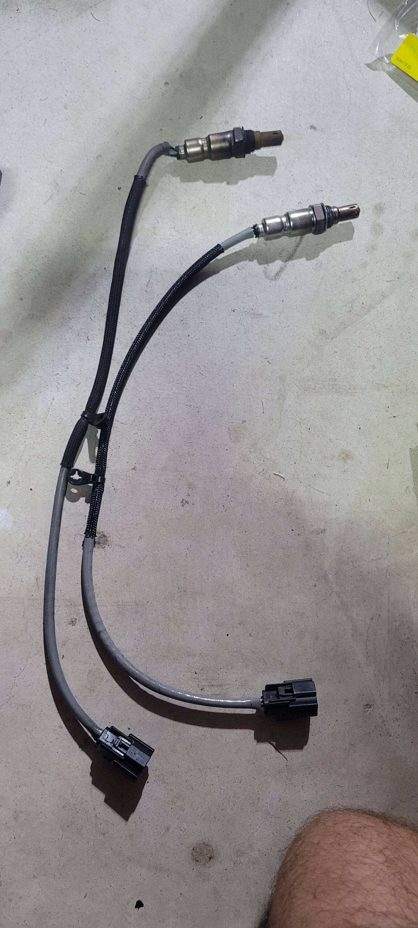

good discussion here peeps. I finally got my o2 sensor in the mail and swapped it out last night. It's been raining so haven't had a chance to drive the car yet, but I reset the code and revved a few times, and it hasn't come back.
That top one looks like there could be an issue where the wires go into the sensor, is it just bent weird?
Good call. Is it just my eyes or does it look like the metal part just behind the hex where you put a wrench is also bent on the old sensor? Maybe it got smacked by something?
Either way the burnt one is gone and the clean new one on the bottom took its place
