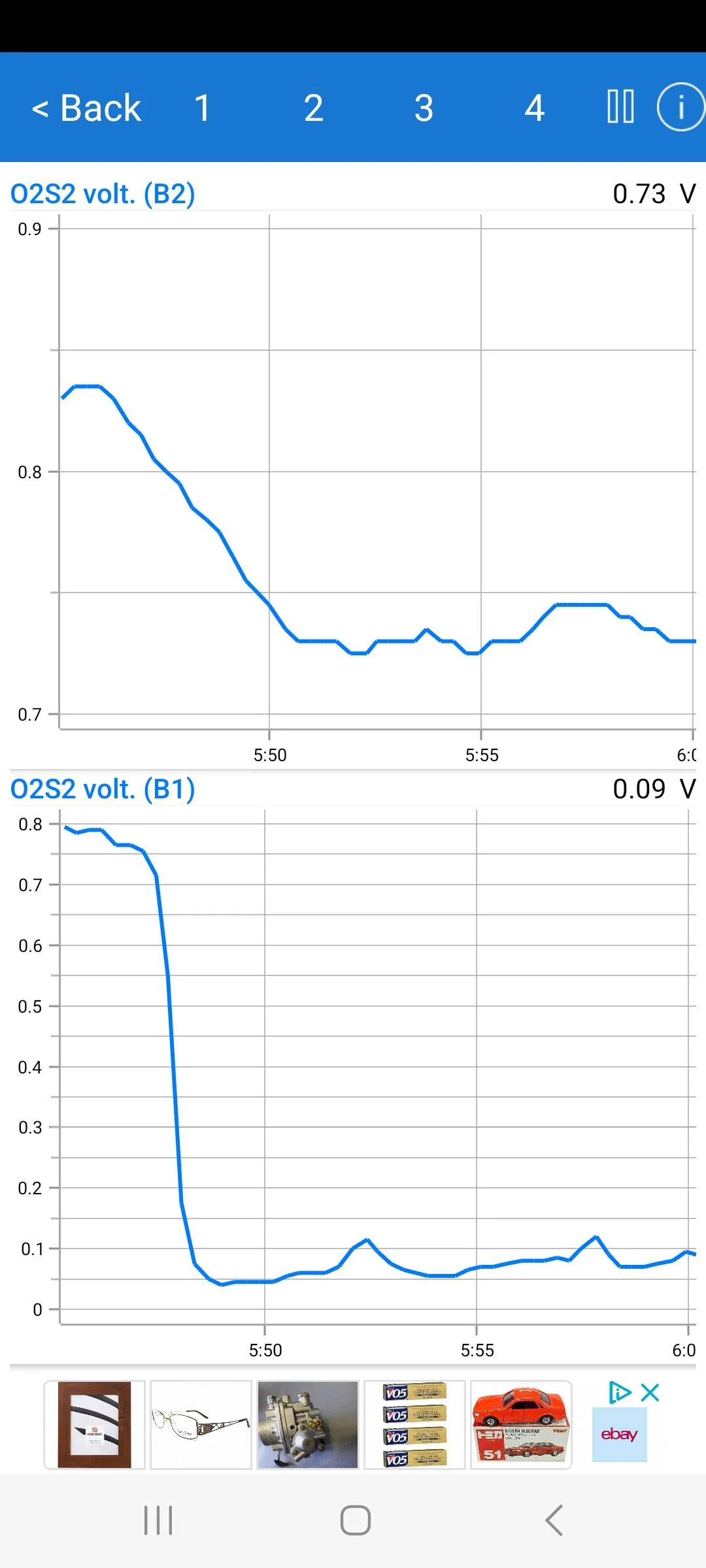

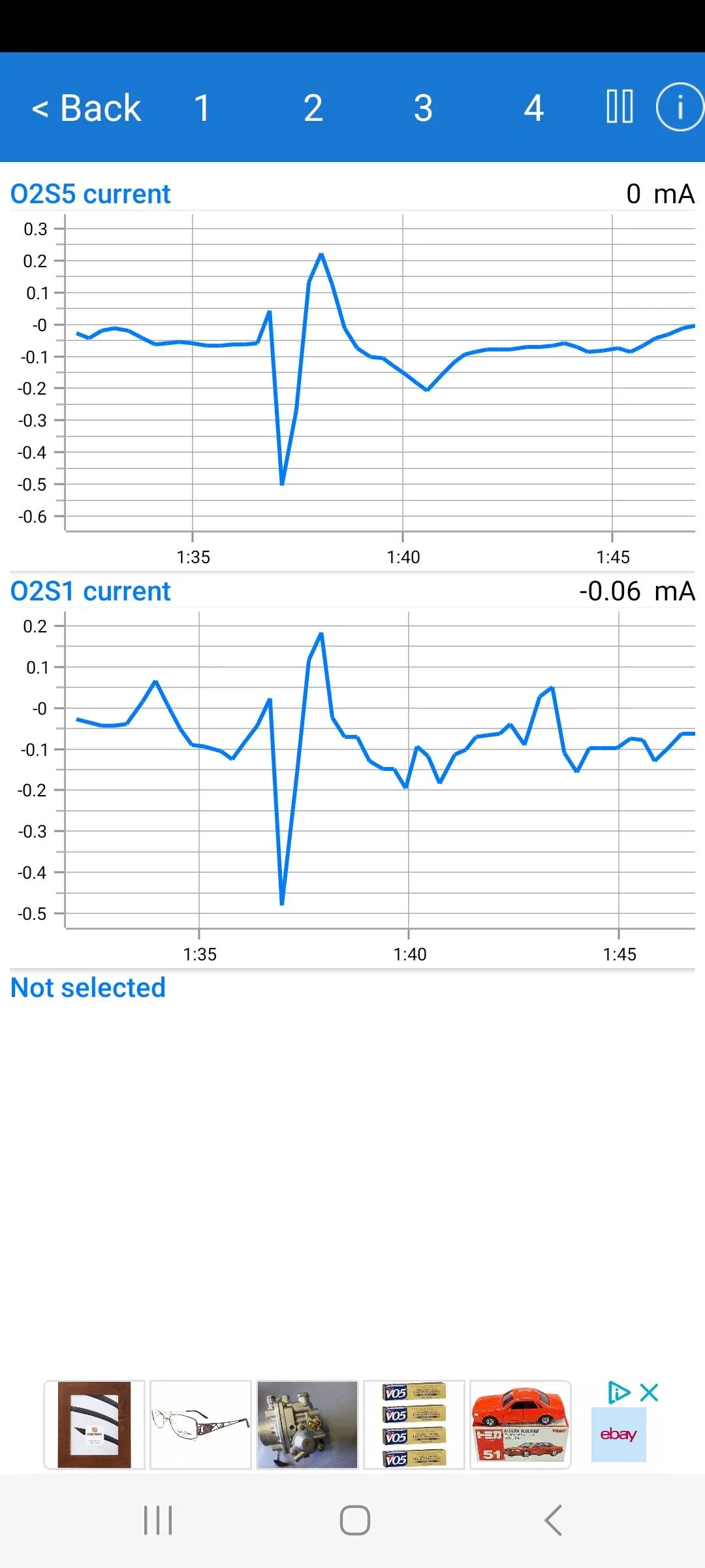

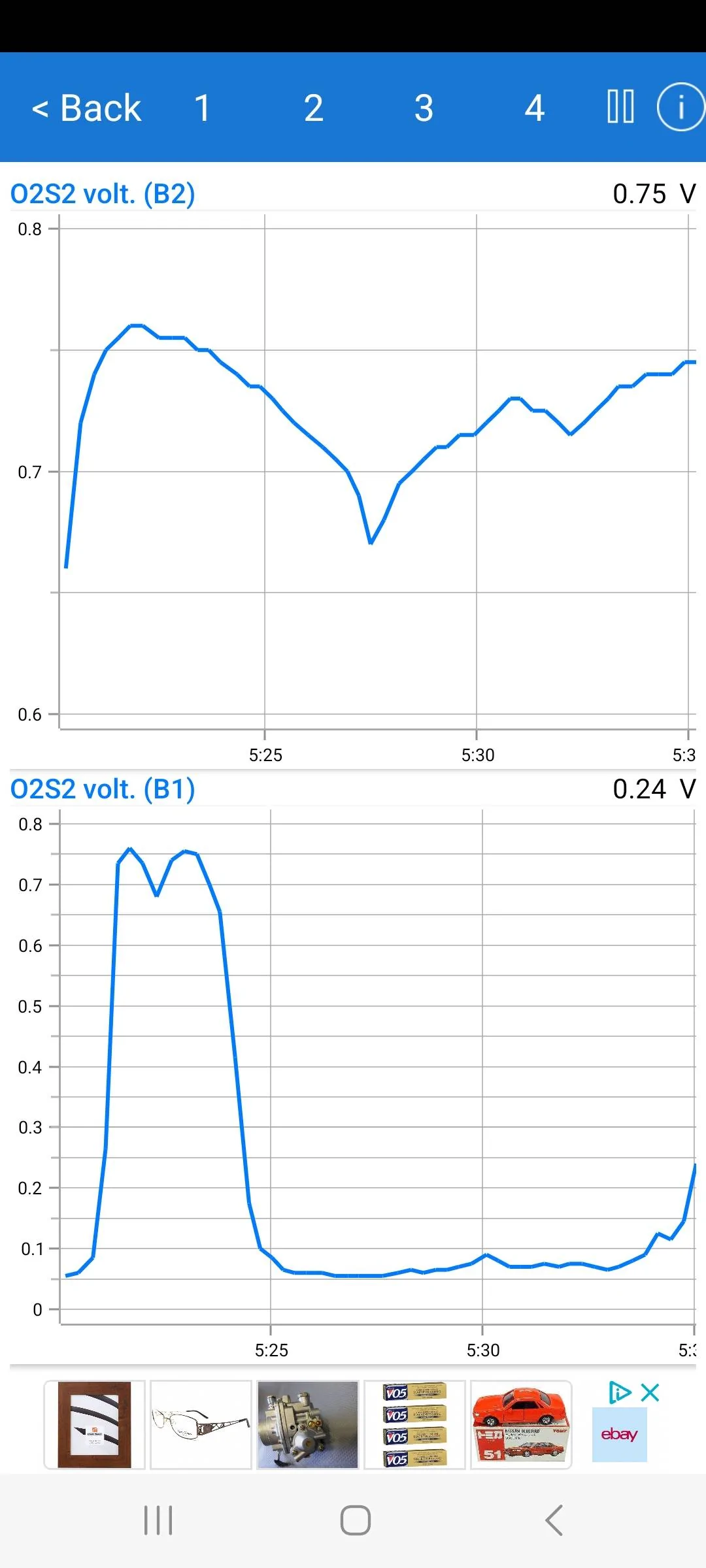

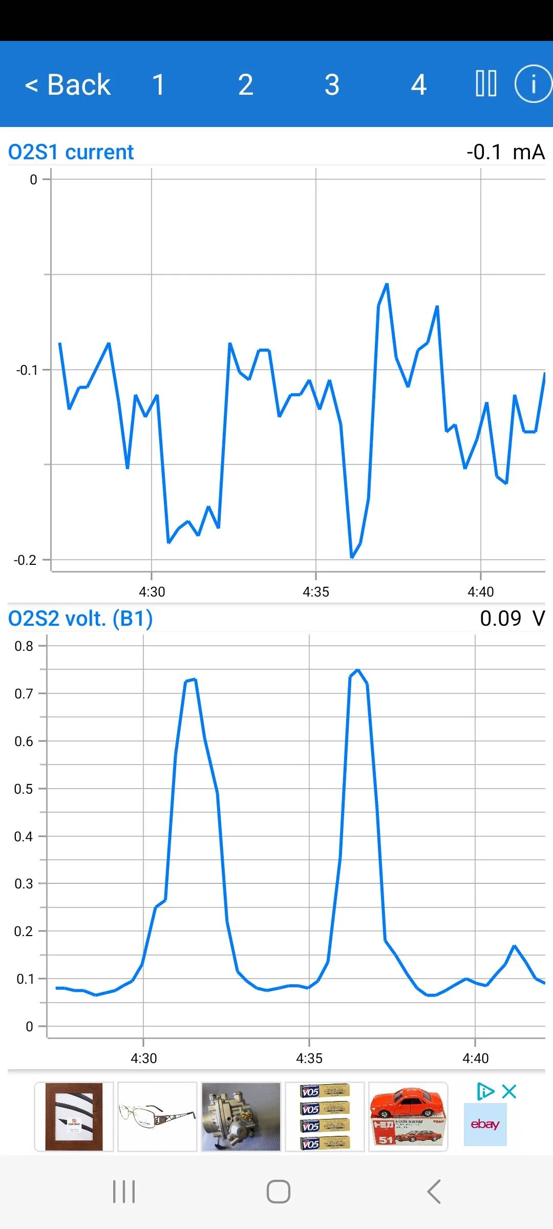

Did some idling in the driveway and took some live readings of o2 sensors.
I thought it was strange to see some negative voltage

The negative is sensor 1 (wideband) current which I believe is actually the heater current.
Otherwise this isn’t a valid test because you need to log during a cat test.
Secondly just a cautionary note that most don’t know is that the rear o2 sensors are used to calibrate the fronts. You can fool the cat monitor test using anti-foulers but you can’t fool the calibration. And since the cat brick is gone, the rears will be incorrectly biased which leads to calibration of the fronts to be wrong, which leads to it running richer or leaner than what the widebands say. This can be fixed in the tune by disabling FAOSC but many tuners and even tuning software don’t even allow this anymore, and even if they did you would perpetually be stuck in ā€œnot readyā€ status of the cat test.

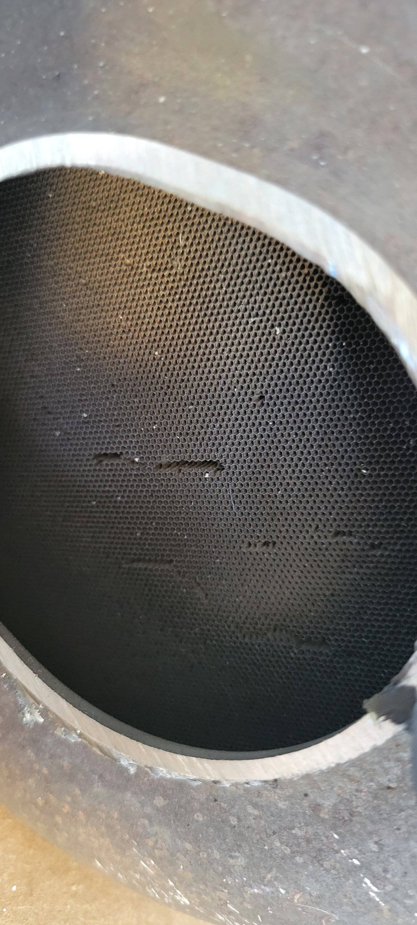

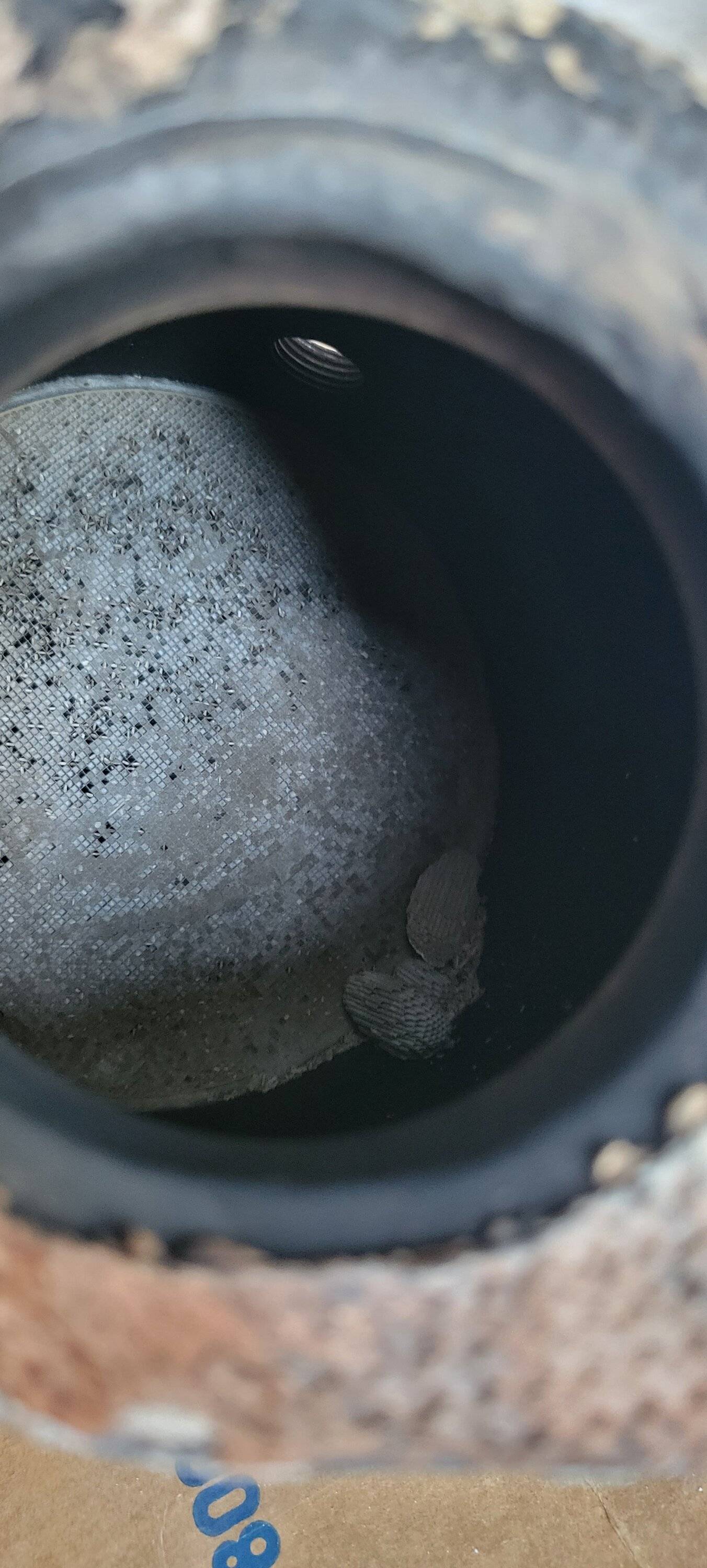

Running a roush blower. Turns out passenger side cat was melted. Now I have a p0155 code, will be swapping the o2 sensor tomorrow

Pics of the 2 cats
