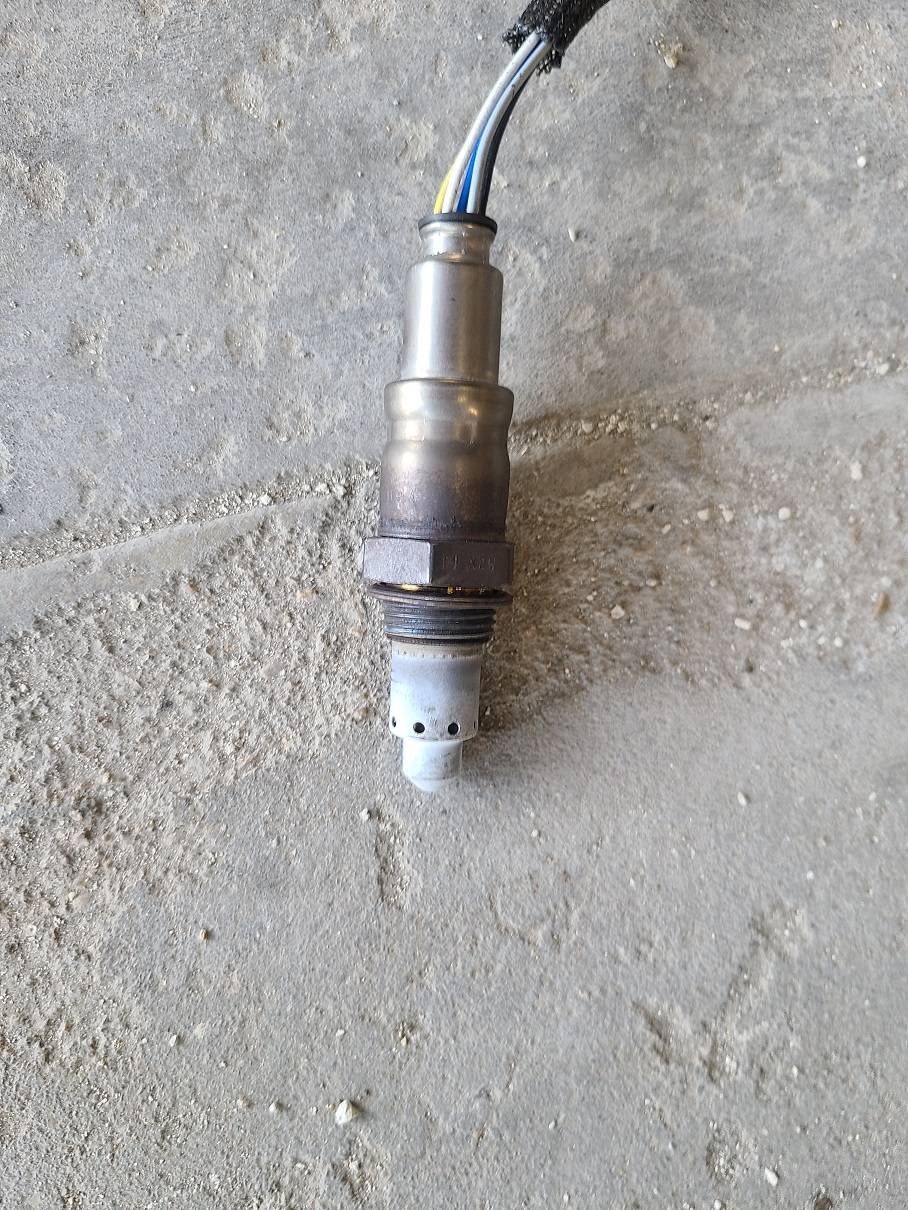

I had a ton of o2 sensors die on e85 then I switched to NTK f150 sensors, no issues since that. NTK 27079 work for both sides upstream.

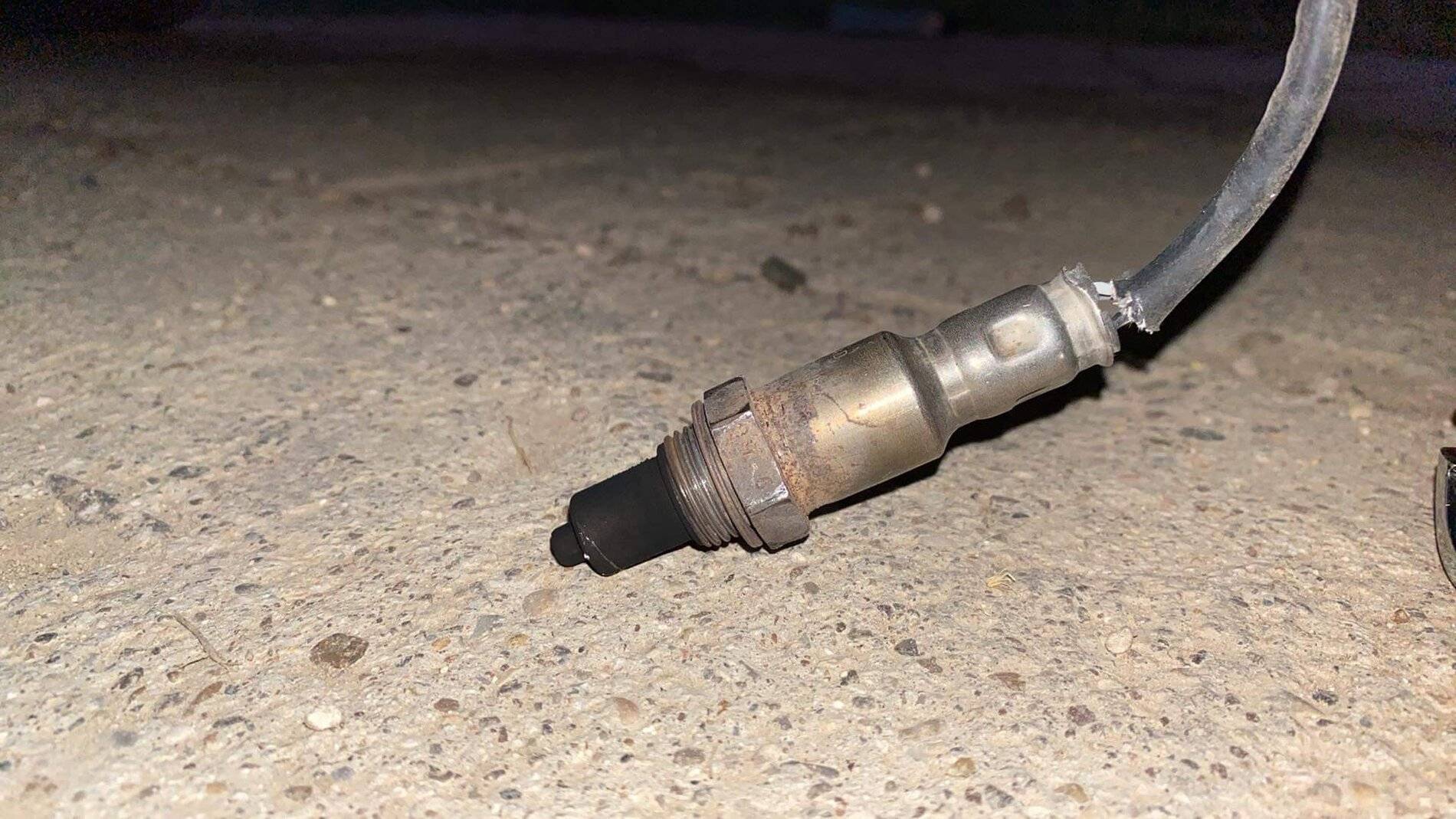

They could have been damaged during the header swap. Are you tuned for headers.
This is Bank 1 cats, This is the side it was giving me codes on before I fixed the mass air flow sensor. The other side looks in way better shape. I am currently checking passenger side spark plugs. My tuner doenst want to to give me a header tube till I fix all my codes. Not sure why as to I think I have these codes because of that

All my dead upstream o2 sensors were white. Yours looks a lot different than mine. Are yours the rear o2's that are going bad?
