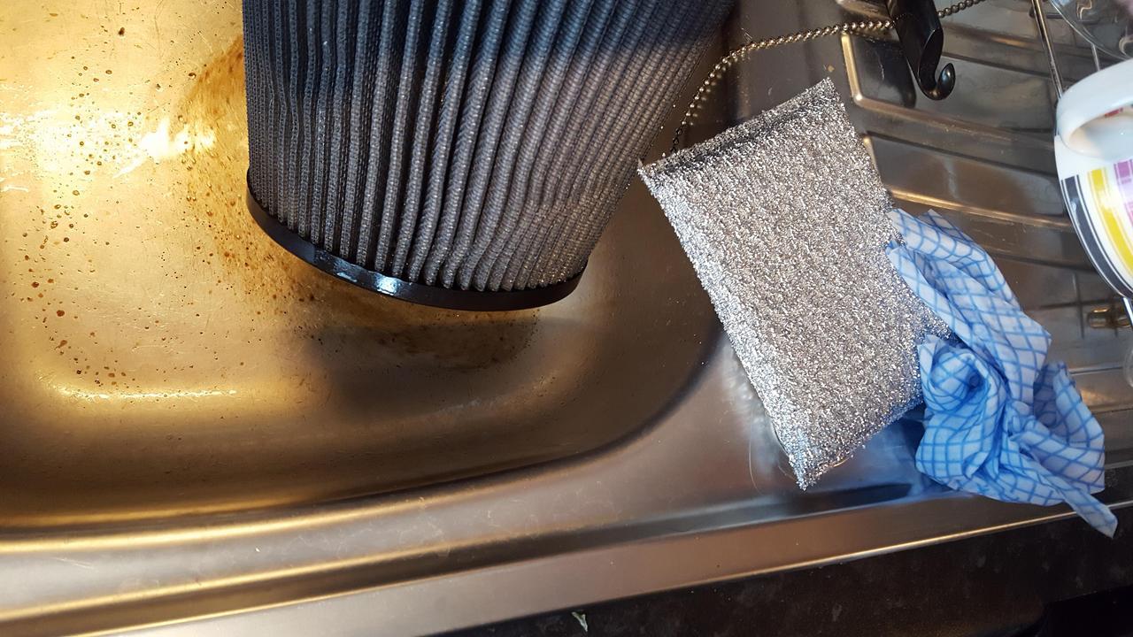

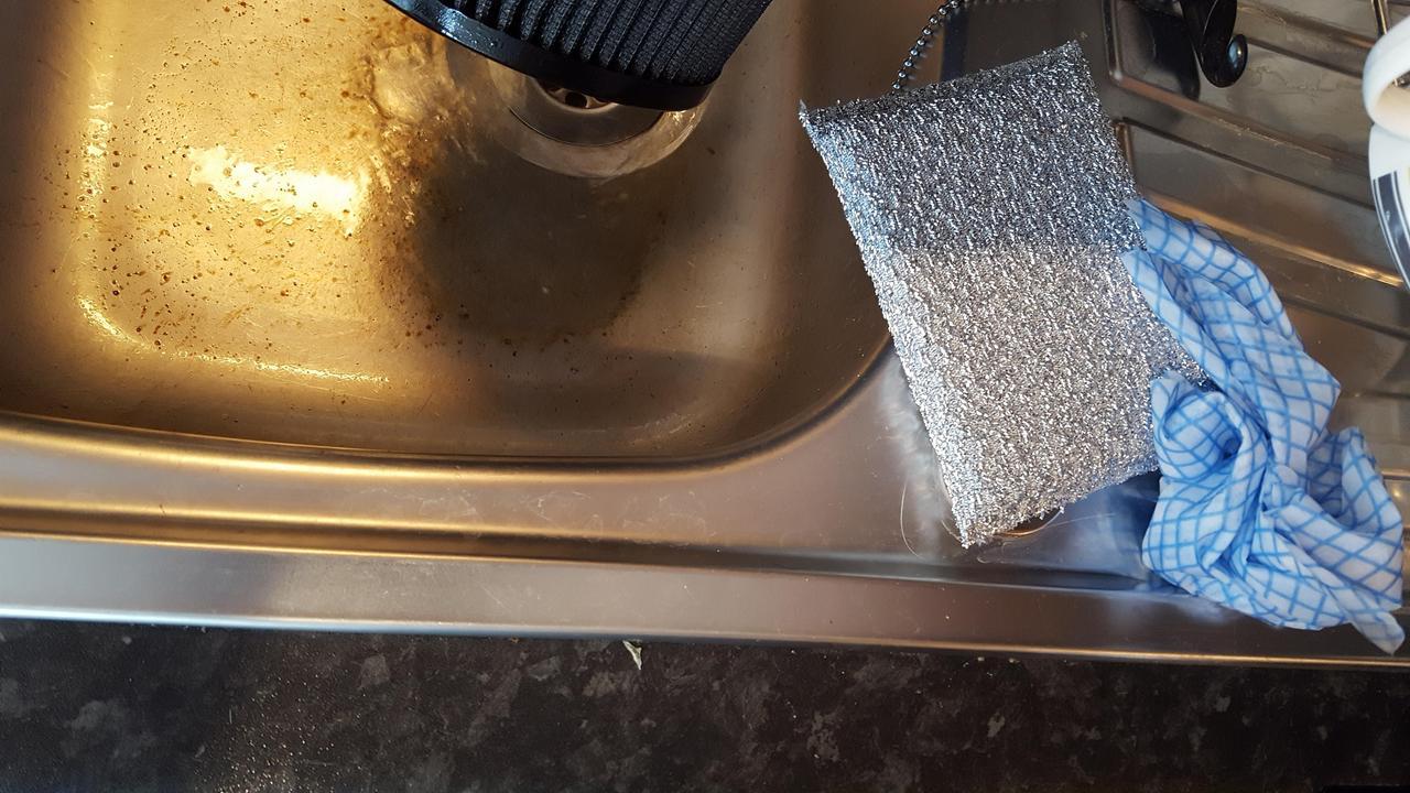

The process is as you would expect; remove filter, bang it a few times to remove any loose crud, douse it with cleaner, rinse, repeat until happy with result, then follow the procedure for oiling.
Here's the engine oil from Silverstone STILL coming out (this was about the third rinse):

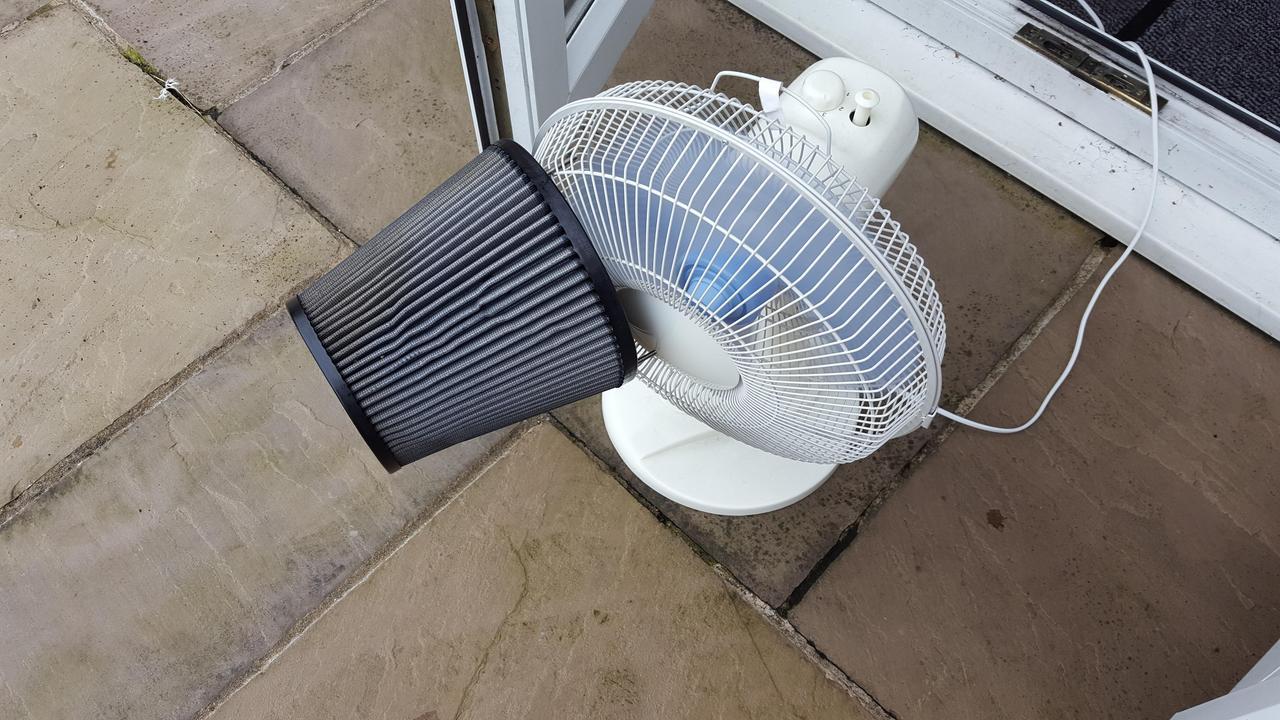

Drying off after the final rinse:
