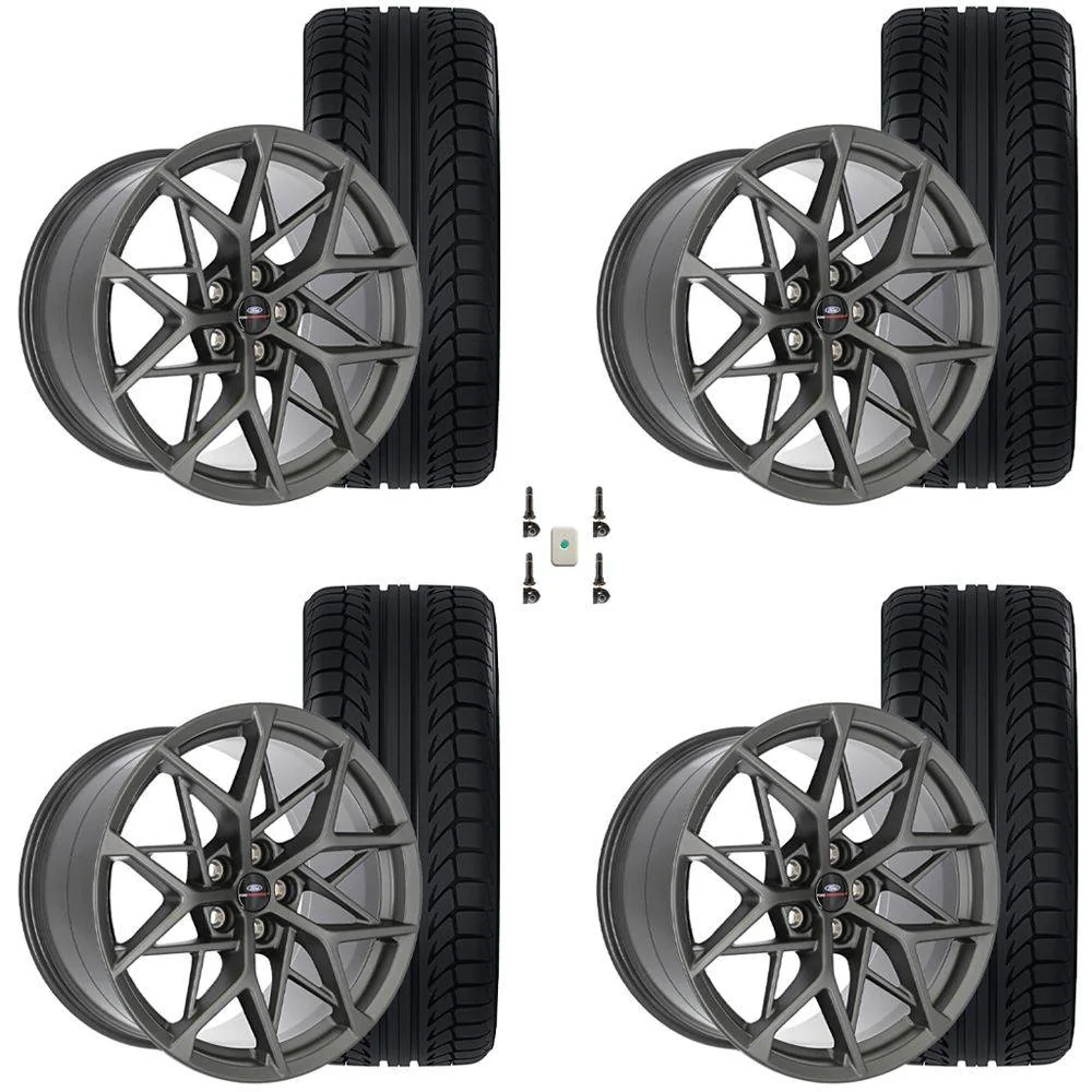

I have a 2015 black v6.
My largest tires I ever experienced is my stock 17 inch wheels.
I am think in changing my wheels for the Ford Performance Mach-1 Handling Pack Wheel And Tire Package 19"X10.5"/ 11" Tarnished Dark Aluminum.
not very familiar about the logistics about wheels and tires.
Frankly, all I am looking for is some wheels that look nice.
I only daily street drive
it costs $1350 and I would prefer OEM.
Please share your opinion and what do you think I would experience driving with new wheels

Get the LMR versions, they look the same and are lighter and you can get them in a 19x10 square and run a 285/35/19 tire. the ford performance wheels have a unique offset to run a 305/30/19 in the front, and a 315/30/19 rear. That tire is too much for the street and they are not cheap either.
https://lmr.com/products/mustang-sve-mhp1-wheels-15-22

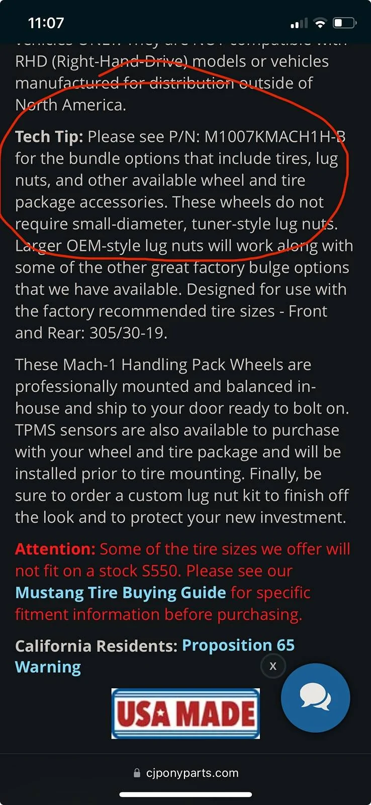

is that CJ pricing correct?? Not sure how they (CJ) can sell that FP rim/tire/sensor package as low as what just a set of rims would cost…. And because the price that LMR has is usually a very good price…

looks like that $1300 price is just the bare rims. Has a different part number below to include TPMS and tires etc.
You’re right. Thanks for pointing that out.
I still like the wheels

If you're dead set on the FP wheels Levittown sells them with sensors. They're also a forum sponsor and Benny usually gives a promo code if you ask him in their discount thread.
Also worth noting fitment issues are likely. From the Ford Performance site. PLEASE NOTE: This kit is intended for use ONLY on vehicles originally equipped with the Mach 1 Handling Package and Performance Package 2 option. Use on other vehicles may result in tire-to-body/chassis clearance issues.
Ford Performance Wheel Kit Mach 1 Handling Pack HP 19" - M-1007K-MACH1H | Levittown Ford (levittownfordparts.com)
