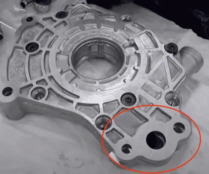

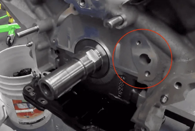

Quick question regarding the oil pump. Is there a reason why there is no gasket or o-ring between the oil pump outlet and the surface of the engine. It seems to just be metal on metal. See pics below.
I'm not saying this is wrong. Ford obviously intentionally engineered it this way. Just wondering what the reasoning is behind it.

That's interesting. I can see that with two bolts on either side and as long as the surfaces are acceptably flat, oil leakage would be minimal. But I wonder if it would be worthwhile for someone to experiment with machining a groove for an oring into the housing.

What year/GEN Coyote is in the images?
