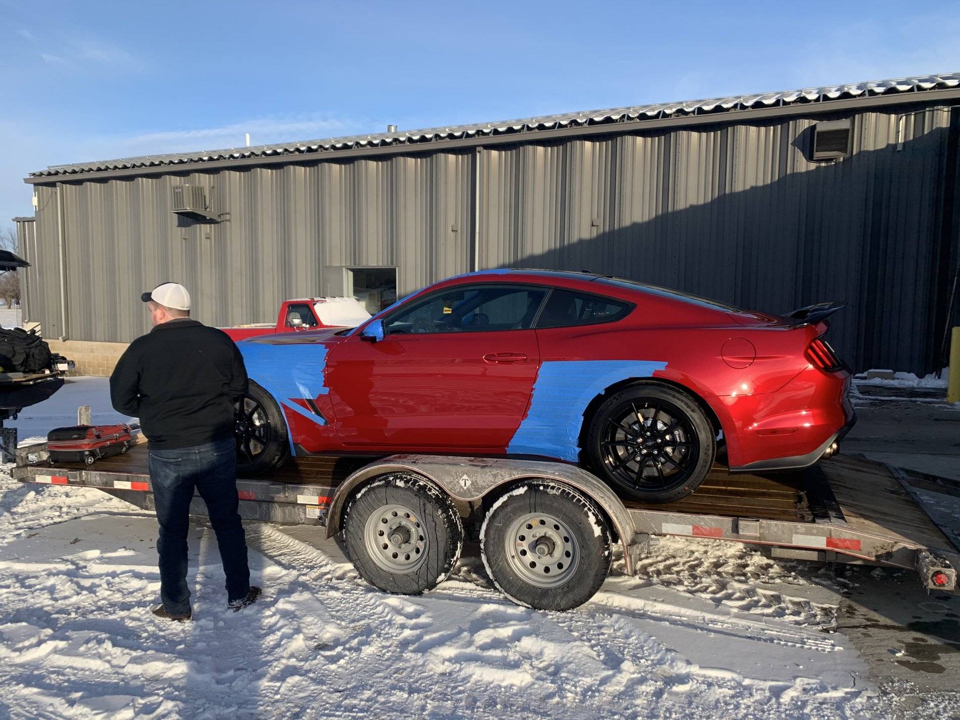

Buy the wide track tape from Amazon Prime. I used it on my car when I picked it up in Indiana and drove it to Seattle. Not pretty but effective.

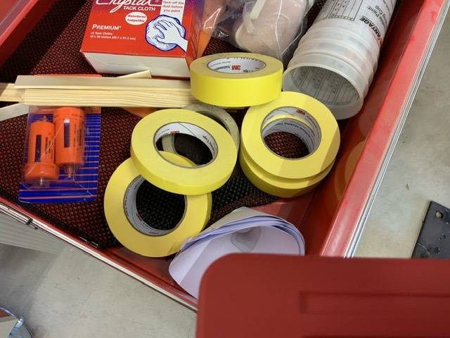

Go to a auto paint jobber store and get the yellow 3m used for Automotive spraying applications. It will hold much better then what is available at Depot and Lowes. It will remove easier as well. I used the blue 3m in a pinch towing mine back 1200 miles through a snow storm. I was having to stop and fix the tape every couple hundred miles.
