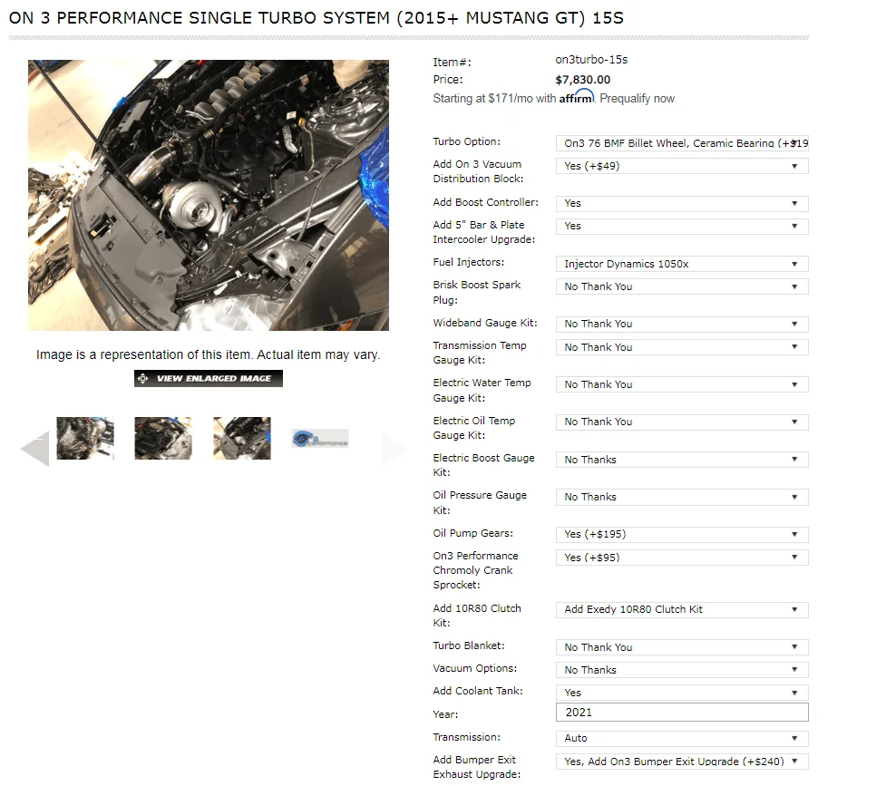

This currently the set up I have option wise that I plan on purchasing here in the next few weeks.
Other than some upgraded axles and engine/transmission upgrade. What else would anyone recommend purchase wise, such as fueling for a fuel return system and upgraded fuel pumps and rails?
Curious if anyone else has this specific kit on their 18+ Mustang GTs.
Any help would be graciously appreciated as I am wanting to purchase this sooner than later!

Can you fabricate/weld? Sometimes those on3 kits don't fit quite right and need to be modified. Just something to think about.
I can tig, not very good at it. I have a local shop I trust to install or re-fab if needed, I was planning on doing the install myself but if it becomes difficult I would hand it off to a shop/tuner.

No way I would pay 7800 for an on3 turbo kit.
If you want a single you should go bl fab.
Cue_5oh
Cue_5oh
Nov 30, 2022
Tampa, FL
Niko
2021 Mustang GT
The BL kit ends up being over $10k+ with the same options. On3 is a perfect kit unless you plan on making 1100+ whp, which even then on the ON3 kit you can cut the T4 flange and go to a T6 and maybe put a better set of headers on there and run that power. Plenty of people run ON3 and have no issues. If I took away the clutches and fueling the kit would be around high $5k.

You're going to modify a kit to make it fit.
Then you're going to modify it so that the back pressure from a single T4 flange doesn't completely choke the engine over 700-800 HP.

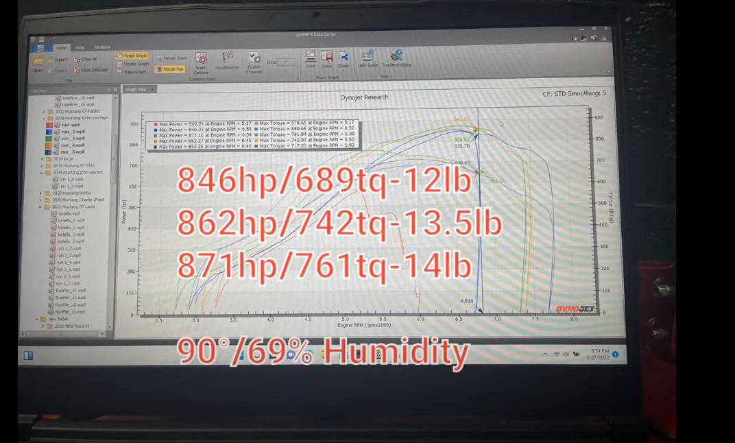

I see money adding up. There are videos out there with what a Dyno graph looks like on this kit.
Also I didn't know bl fab was over 10k, fook that.
What options you got on this to make this kit almost 8K? I mean if your mindset is already set to modify the kit then go for the cheapest option.
*Edit. I know a builder who couldn't install the kit because they didn't send the right flanges. He hand to get downpipes and flanges MADE to get the to fit because on3 didn't have the right stuff at the time.
Edit. I see you have a few options on there. nothing crazy see here 2 lbs of boost only gains ~ 30 hp the torque actually falls off a lot after 5000-5500 RPM.
