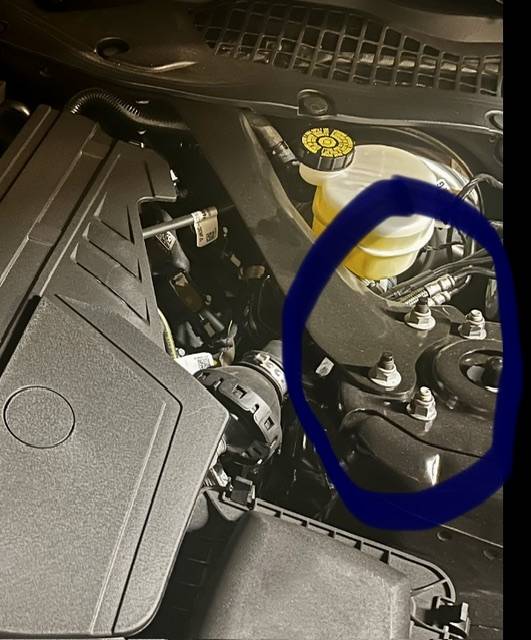

Here’s the nuts I’m referring to:

Yes, Unless the nylon inside them is damaged. You can apply some blue locktite if you like
GrabberBargeCaptain
Oct 6, 2023
1,264
1,432
CA
Yes and don’t go nuts tightening them nuts. People have broken the studs.

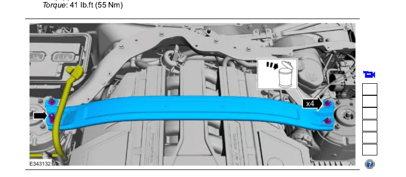

I think you entirely missed the point of his reply.
well, please do share then. I guess the picture implies they are single use nuts? Wonder where those instructions came from?
SheepDog
Nov 3, 2018
4,221
5,306
Colorado
Dax
They came from the factory manual. Ford wants you to use new nuts, because they are nylock nuts, and the nylon material comes apart or thins out once you remove them. I have removed and re-installed my strut brace several times, re-using the nuts each time. No issues to report, but if you want to follow the manual, you need new ones. Or, like I said, put some locktite on the studs before you thread them on.
https://blueovalindustries.com/products/hw0003x4
https://www.tascaparts.com/oem-parts/ford-upper-mount-nut-w712334s440
Cwood8656
Jan 28, 2020
38
87
Arizona
2019 Mustang GT Premium 401A, 2008 Toyota Tacoma PreRunner double cab
I very nearly sheared a stud while reusing the original nuts and torquing to spec. So, don’t do that. I believe they are single use nuts. Not sure. I have a new set but have not bothered to install them yet. And if/when I do install them I won’t be torquing to spec.
