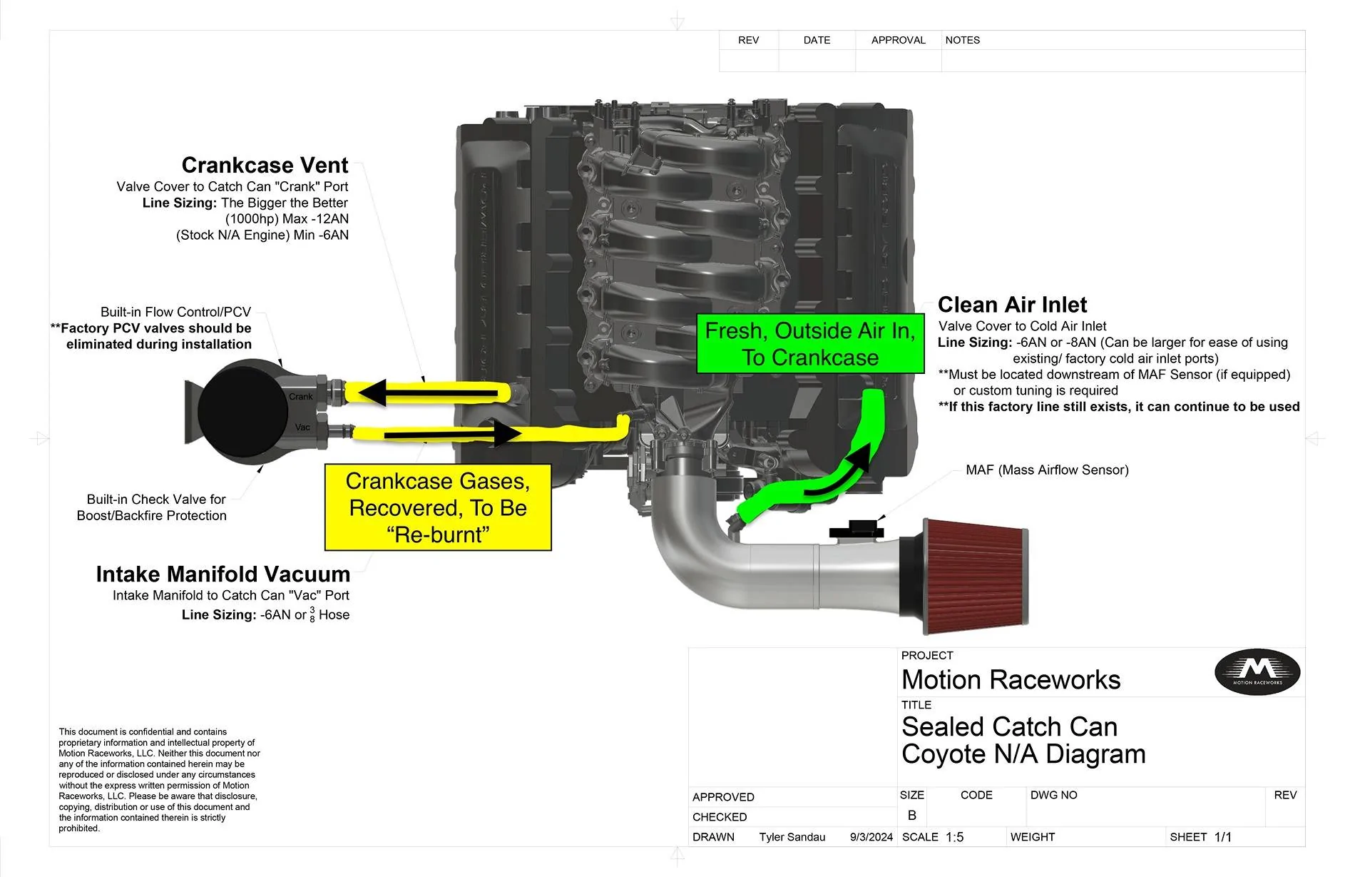

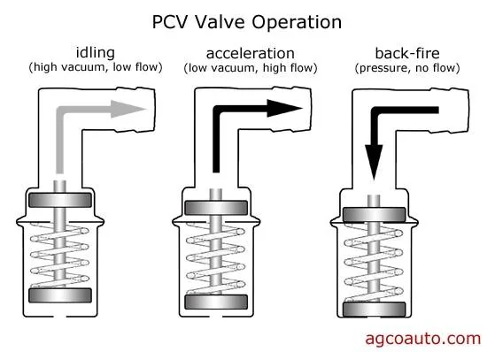

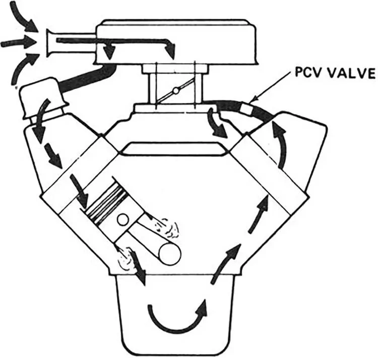

Attached is some information about that.
Yes, Passenger side only. While you can install one on the Driver's, in a stock setup, most report gathering nothing. I have one attached to the passenger side. I draw about 15 ml every 1700 miles/2720 kms.

How does the PCV system function when your intake manifold is a blower? My car has the Roush kit. My mechanic suggested getting rid of the PCV system due to how dirty the superchargers heat exchanger was. Right now I'm venting to atmosphere with small filters on each side. Car has been this way for about 4K miles, the filter on the drivers side (car's left) is oil soaked and dirty while the passengers side (car's right) is about brand-new looking clean (both filters were red, passenger side looks brand new, drivers side is blackened and making a mess). Seems the flow path pictured above doesn't apply once the intake manifold is replaced. I've been thinking about installing a catch can on the drivers side still venting to atmosphere since I haven't been able to understand the original flow and where to dump back in; this would at least relocate where the mess is being made and hopefully be less messy with a can catching some of the vapors.

The driver side pulls air into the motor so not really needed unless you have a lot of crankcase pressure / blow-by. Or on boosted applications we can see it get some droplets. But the passenger side is the side it wants due to the PCV pushing air back into the motor. A can can stop oil, fuel, and moisture. I like the UPR Products one the most due to the braided lines and chambered filtration system. J&L is a good one too.
