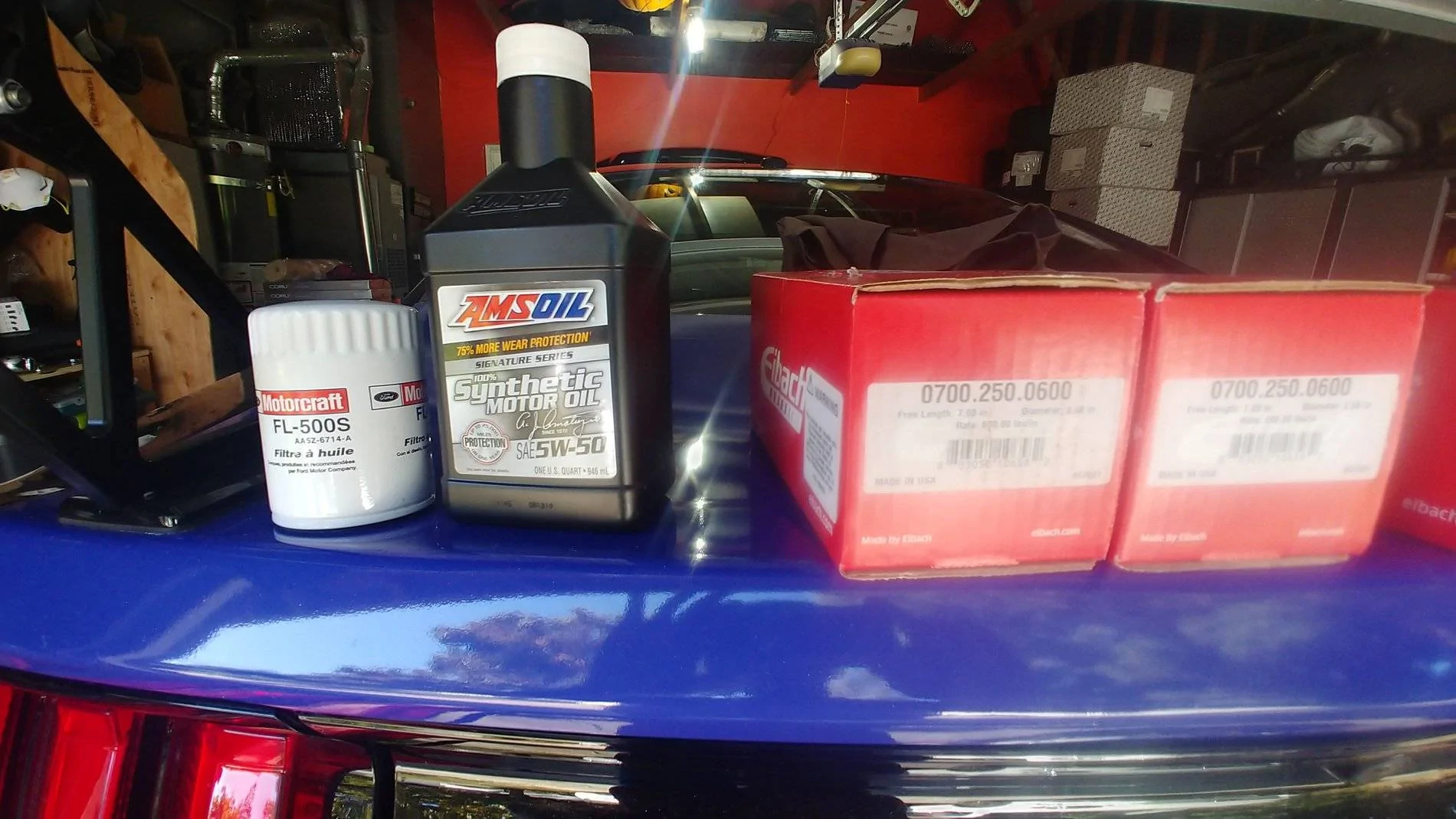

I ran since day 2 of my more track dedicated car ow40 mobil1. Good compromise price/ quality.
This morning i put on AMSOIL 5W50. Higher viscosity and higher protection at higher temp.
But for daily is too thick IMO. also depends where you are. In cali temps are 100f while somewhere else temps are cooler.
Most important thing is I use MOTORKOTE ,friction reducer. with oil(way superior than liquimoly. Take a look on youtube PROJECTFARM videos. Cool guy testing everything. )
