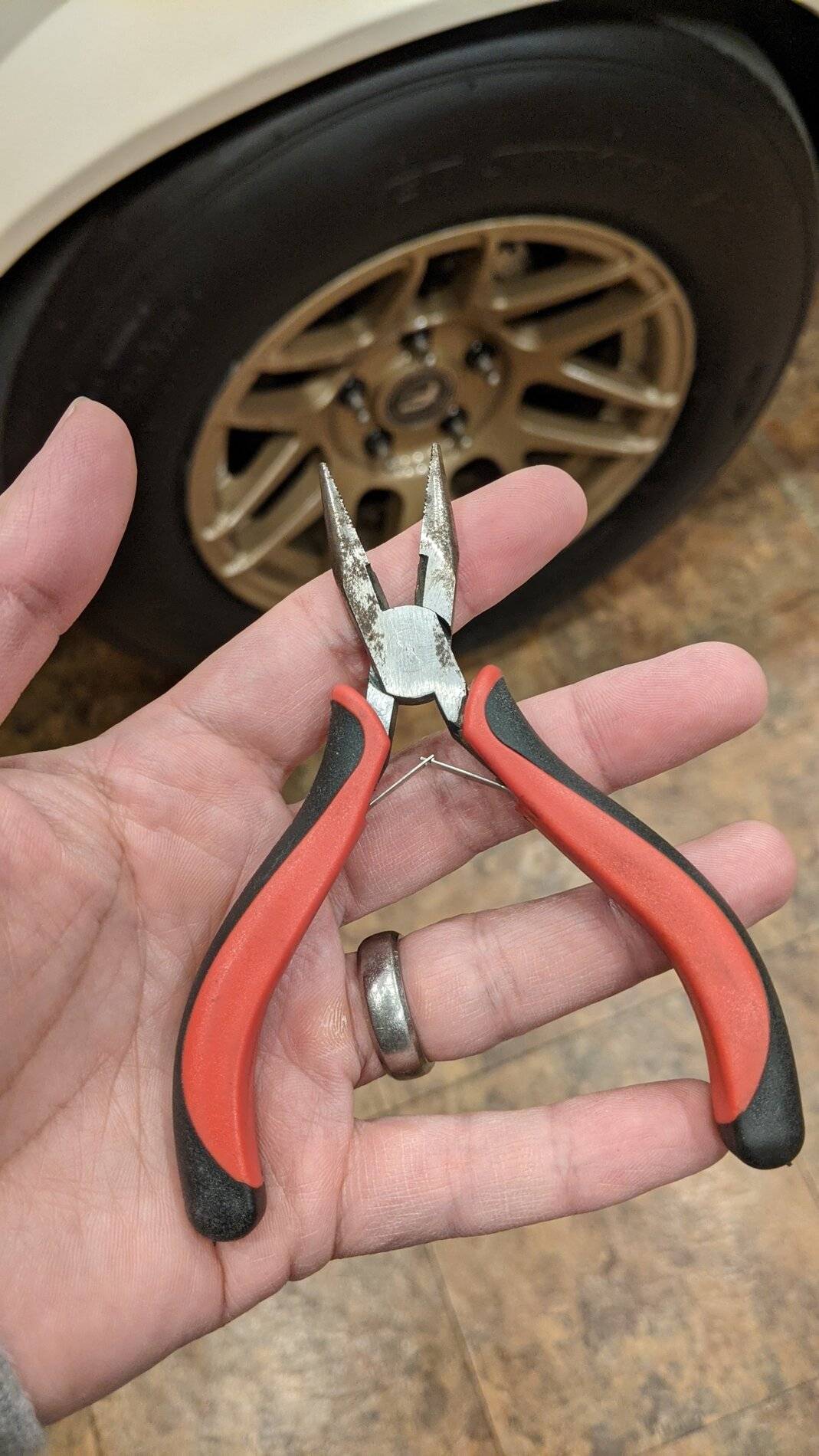

So I’m having a hell of a time getting that last 10mm bolt on the oil pump pickup tube. Any tips? Can’t get my fingers down there to spin it by hand and my ratcheting wrench doesn’t have enough tension to click back. You think I could loosen up the oil pan so the front drops down a little so I can get some room?
If you can get the bolt started, you can use a small pair of pliers and grab the threads lightly and run it in. I repeat lightly. Put index finger on head of bolt.

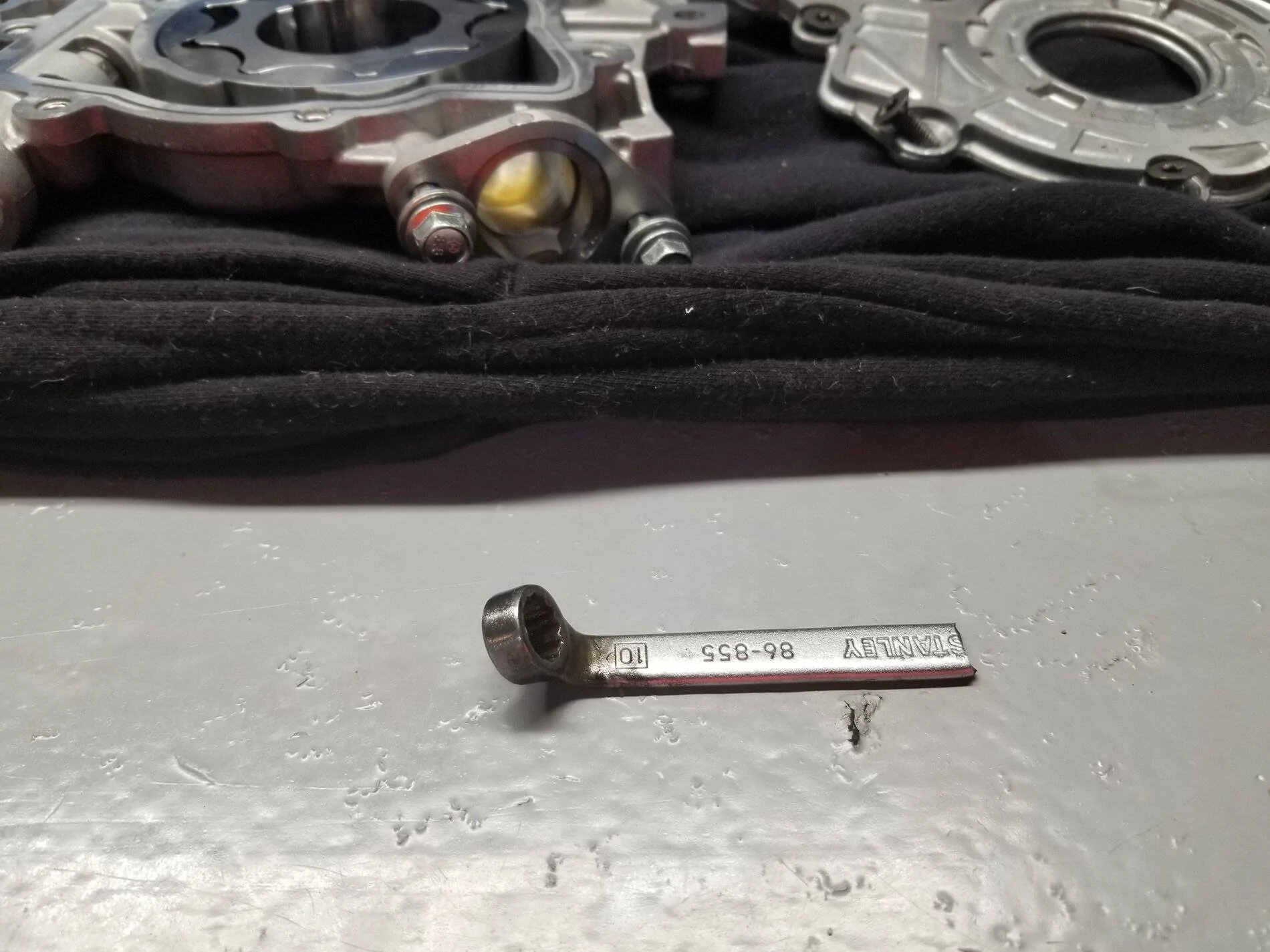

Go to any tools store and find the smalls 10mm wrench
mine looked like this I got from lowers....
just take your time

I heated/bent a 10mm wrench. Made it much easier.

I also heated and bent a 10mm wrench, and use a magnet. To reinstall the bolt i use the magnet and a set of needle nose to get the bolt started.
