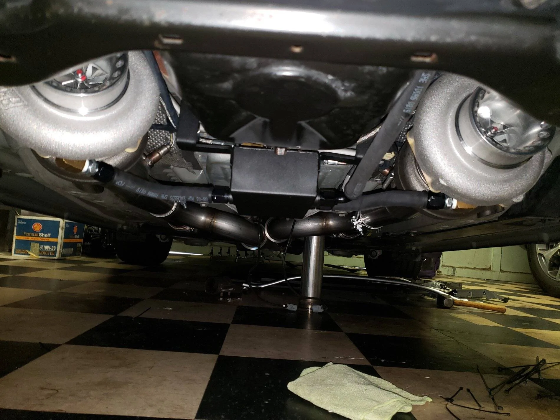

Hey, I also noticed your Hellion set up doesn't have the "Oil Catch Box" (or whatever they call it) hanging down underneath.
That's one thing I discovered that made me nervous about the kit (after the install); they say it has plenty of clearance, but still makes me nervous about the possibility of road debris crashing into it there - that would take the car out of commission for a while, did you get a newer version of the kit or something?

My hellion kit does have the catch tank between the turbos. My avatar picture is before I installed the turbo drain setup. I do believe the newer kits have done away with the tank though. I haven't had any problems, but my car is also not lowered.
See picture attached (also mid installation).

Hey Thanks Buddy - my car isn't lowered but it is a Bullitt but I don't think they're sitting any lower than a GT, at least the 2019 verison isn't (I believe). Had a 2009 which was definitely lower than GT's of that time period.
Hmmm, I wonder if it's an option to upgrade the kit. Guess I'll have to call Hellion.
It's either that or maybe some sort of custom shielding / brace for my piece of mind.
