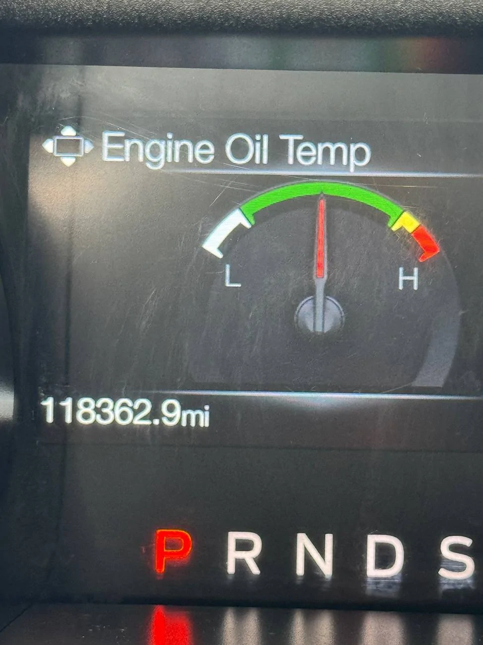

Hello everyone, I would like to start going to the track more frequently without worrying about overheating problems, but the last few times I went, the oil temp gauge gets to yellow and even red really quickly. My coolant temps are staying cool, only my oil is becoming a problem. As far as I know, the previous owner tuned my car, but I am unsure what type of tune it is. I stay under 6500 rpm and still am having problems. Any suggestions; oil coolers, hood vents etc.?
